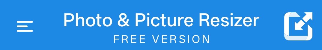

    Also some graphics types won't upload. Once you've reduced the size you may want to make sure it's a jpg file. There are other file types that work, but when in doubt I try to convert to jpg.
    If I need to change the size or type of file, or crop the image, I use Irfanview on computer, which is free and open source. On my phone I use this creatively named product...Click image for larger version.
