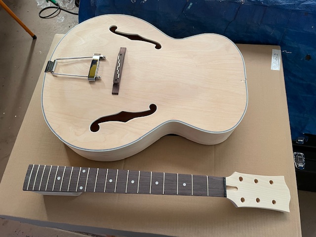

    After the success of my resonator build, I have decided to have a go at another acoustic. The PitBull Guitars site has some FH-5V kits which do not have (due to a factory mistake) a neck or pup route and also no drilled pot/jack holes. It is an archtop and does have f-holes with binding.
    I thought I could make something to resemble an "old school folk guitar" with no electronics.
    I have also collected a few different resources - Grover (98 series) openback tuners, tail piece and wooden bridge (but I may not use them).
    Routing the neck pocket will be the first (and biggest) challenge!

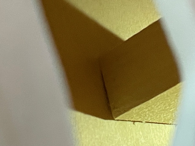

    Trev, do you have access to a FO style inspection camera? It would be informative if you/we could get a look inside at the neck block and to make sure the bridge support is positioned correctly (assuming they still use a bridge support).

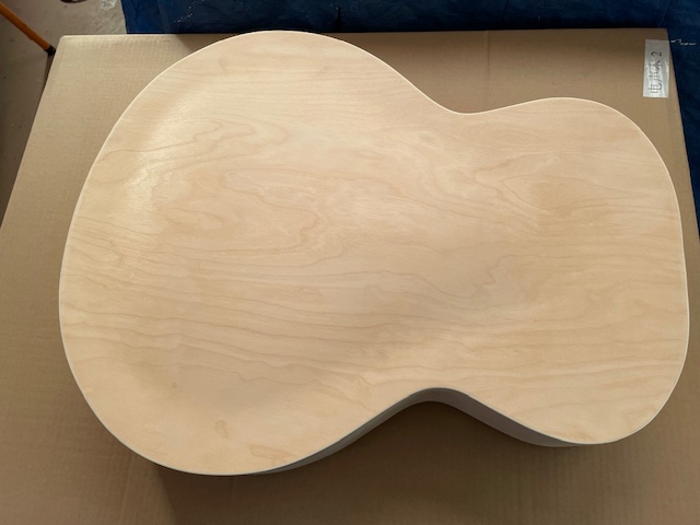

    1,983
    Quote Originally Posted by vh2580 View Post
    Trevor, keen to see how your plan goes. Would be freaking me out if it was mine. Hard to tell on the photo is it fairly flat at the neck or got a lot of curve?
    Thanks Tony. The "freaking me out" is part of the fun! The top around the neck is flat.
    1,983
    No FO camera, but looking through the f holes: I can see the bridge support and that is positioned correctly. Can also see the neck block and that looks good. The kerfing around the side also looks good.
    Not great pictures!
