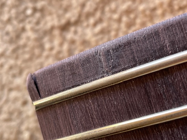

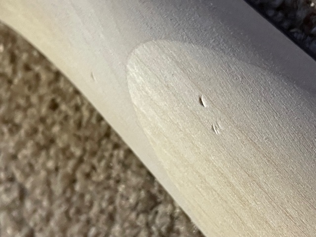

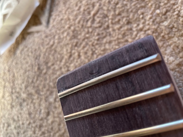

    neck work:
    Today I have:
    Removed a few dents in the neck using the damp cloth and soldering iron trick.
    Glued a chip on the fretboard using CA glue.
    Tweaked/Improved the headstock pattern.
    Sanded the neck to 240 g.
    Added my serial number.
    Levelled, crowned and polished the frets.
    Filed the fret ends.

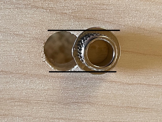

    I have also checked the fit of the Grover 98 tuners, which have a push-in bushing rather than a washer and nut. I found that the bushings are too small a diameter for the tuner holes!
    I could dowel and redrill the holes, or wrap and glue newspaper around the holes! I will think about this a while.

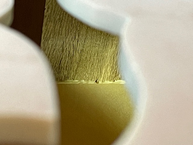

    Trev, do you have access to a FO style inspection camera? It would be informative if you/we could get a look inside at the neck block and to make sure the bridge support is positioned correctly (assuming they still use a bridge support).
    I may need to do this with the push in bushings for some Gotoh tuners on a bass. I have found it hard to find dowels that fit...never thought of the newspaper trick, but it's definitely something to consider!
    No FO camera, but looking through the f holes: I can see the bridge support and that is positioned correctly. Can also see the neck block and that looks good. The kerfing around the side also looks good.
    Not great pictures!
