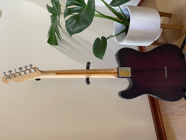

    This year's work build. A Basswood tele.
    The body has been stained with Feast Watson mahogany stain, given 5 coats of brushed Cabot's water-based gloss polyurethane. The burst is sprayed on Cabot's water-based stain and varnish in black. Finished with 5 coats of sprayed Cabot's gloss poly.

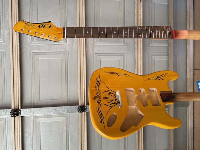

    This year's work build. A TL-1. Finished with Ubeaut yellow dye (first picture), 2 brushed on coats of Tru-oil, then sprayed on coats of Cabots water-based poly. The black edge around the head stock is rattle can MTN94 paint. The logo and "pinstripes" and vinyl stickers.

  6. #4
    3,080
    Nice! What happens to the work builds once you finish?
  7. #5
    2,020
    They are at work as demonstration examples. Different kit models, headstock shapes, stain colours etc. The collection creates a lot of interest and advertising for the club! Not sure what will happen when I leave!
  8. #6
    2,020

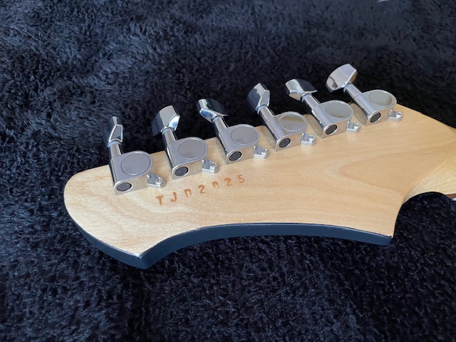

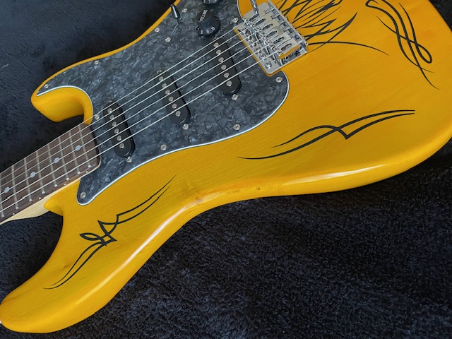

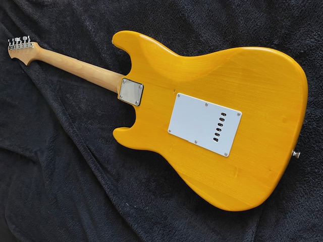

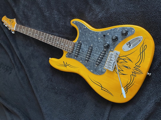

    This build is now finished:
    Finish: Stained with Ubeaut yellow dye. Body and neck has 2 brushed on Tru-oil coats, then
    finished with brushed, wiped and sprayed on Cabot’s water-based Polyurethane.
    PGB Black Pearloid pickguard. Logo and Pinstripes are vinyl stickers (buried under the poly).

  10. #7
    3,080
    I'd join that club. The pinstriping is really cool. You're clearly WA's answer to Billy Gibson ;-)
  11. #8
    2,020
    Thanks fender3x. I wish I had the skills to be able to draw the pinstripes on like Billy G.
  12. #9
    3,080
    Me too! May be a dying art. Been a while since I have seen a pinstripe painted on a car. Meanwhile, your custom cut vinyl approach produces nice results ;-)

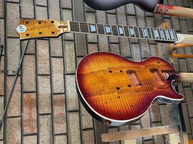

  13. #10
    2,020

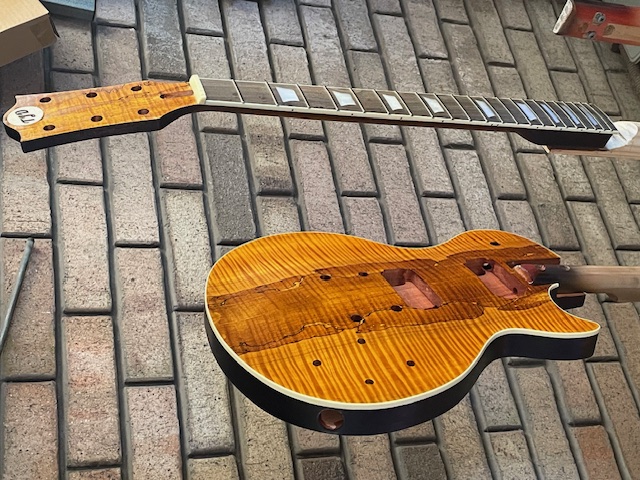

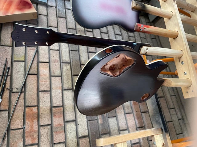

    The next work build. Mahogany body with Spalted maple veneer. Stain is FW Golden Teak, with a maroon (food colour) dye sprayed as the burst. The back and neck is FW Brown Japan. Finished with sprayed on Cabot's water-based poly.
