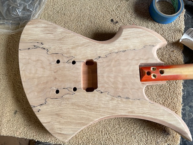

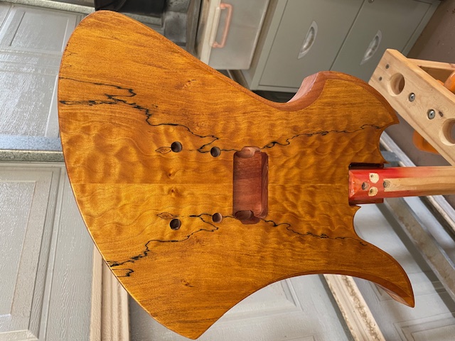

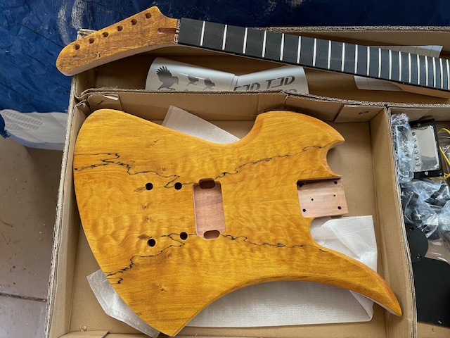

    While waiting for the finish to cure on the MBM-1, I thought I would start the custom MBM.
    So far:
    The body and neck have been sanded up to 240 g, including deepening the body contours a bit.
    I was very careful with the spalted maple veneer (which had a couple of deep scratches).
    Stamped my serial number on the back of the headstock.
    Fret levelled, fret filed, filed the fret ends and polished the frets.
    Wiped on a coat of Ubeaut Sanding Sealer (a shellac-based sealer) to the body and neck. Gently, with one pass, rubbed back with 600 g paper.
    Stained the veneers with Feast Watson Golden Teak stain (diluted to 50%).
    Coated the body and neck with 2 brushed on coats of Wipe-on-poly.
    I will now allow the poly to gas off for a few weeks before some final coats.

  9. #48
    3,020
    That is dramatic. What a great color and pattern!
  10. #49
    1,979
    Thanks fender3x,
    The middle section has a great quilted maple pattern! I'm very happy with it.
  11. #50
    3,020
    I wonder if it was always planned at the factory to make that a one pickup guitar, or if they just could not bear to cut into that beautiful figuring?
