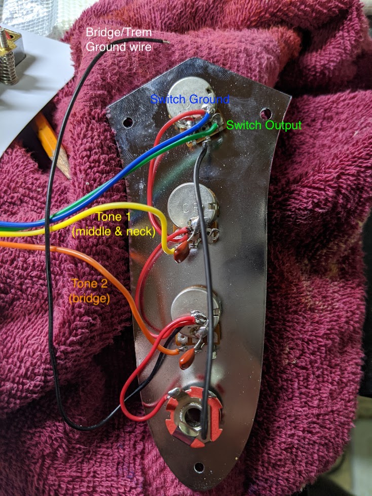

    The factory always seems to be changing the wire colours and components on the JM kits, as discussed in this thread. The images below *should* work for a lefty kit's configuration. The ‘switch output’ wire will be the opposite lug of the volume pot for a standard ‘righty’ kit.
    If you have a 7-lug/pad switch it connects as per below. If you have an 8-lug/pad switch then the centre two lugs both connect to the Volume/Switch Output wire.

    The above gives you Tone 2 for the Bridge pickup and a shared Tone 1 for the Middle and Necks pups.

    Hi WeirdBits, appreciate your work across the forum, have saved my life a few times on other builds
    Currently wiring up a JMA-1, and have the 8 lug panel - it's also reversed compared to the JM-1s I've seen. Can you confirm that this is what you meant with that?

    Here's the rest of the wires, different colours (as always) but I believe the pots are wired up the same as the above.

    Apologies for any incorrect terminology, I'm a software guy so electronics are very out of my depth!
    The pickups are pre wired (thankfully) so just need to connect up the 4-wire ribbon from the vol/tone pots. I haven't tried yet because I'm scared of letting out the magic smoke.
    The JM-1 wiring diagram (pdf/JM-1.pdf) doesn't match up with what I've got in the pic above - trying to work out how to hook up my wire ribbon. The 5 way switch in the diagram has 7 connectors, but mine has 8, and they've been pre-wired differently from the diagram. Hard to see in my picture, but 1,2,3 are pre-wired to the pickups; 4,5 are soldered together; and 6,7,8 are empty. From the thread WeirdBits linked to, I'm unsure if I should be connecting volume to 4,5, tone1 to 6,7 and tone2 to 8, or if that's completely wrong lol.
    Hope this made some sense! I think I'll try it in that configuration and see what happens tonight.
    1,979
    Hi CaseyBoller,
    Yes, I'm sure you have it correct:
    you "should be connecting volume to 4,5, tone1 to 6,7 and tone2 to 8".
    + are you happy with determining the colours of the vol, tone1, tone 2 and ground wires?
    Hey Casey.
    As fender3x, the ‘lefty’ aspect applied to how the pots would be wired on a left-handed build. And, as Trevor confirmed, you are correct with 4&5 to volume, 6&7 to tone 1, and 8 to tone 2.
    It’s a little tough to certain from your images, but from what I can see you should have:
    -black wire to switch ground.
    -white (light grey?) wire to switch 4&5.
    -dark grey wire to switch 6&7.
    -purple wire to switch 8.
