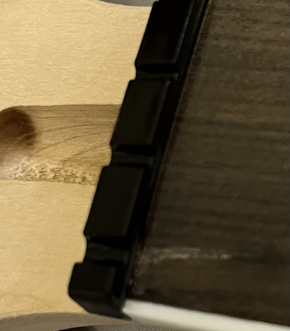

    I purchased the HB-4 on Christmas Day and it arrived on my birthday January 10th. I was concerned about damage from shipping but it appears to be ok. The fretboard had one mean looking gouge in the first fret, but after closer inspection, I see with a magnifying glass, it is just extra glue from the factory glued nut. I have ordered a bone nut to replace the crappy looking plastic one and am hoping it will work and look better. The neck has a pretty big gap on the top side where it attaches to the body, which would not be a problem if it was the bottom, because the pick guard would cover it. I have decided to use Oxford brand finishing products from Canada because they have good reviews and they sell a kit with almost everything I need to finish one guitar. I hope to pull off a sunburst with Honey brown on the outside and Nectarine for the center colors. I hope to get started with the build at the end of January as this is the estimated time I should have the supplies to start the process. Hopefully I can figure out how to post pictures by that time. I noticed the mini hum backer’s didn’t come with any pieces to mount them on the curved face of the body so I ordered some curved bottom rings from Ebay that I hope will work. Everything else looks like it was included in the kit. My pictures are too big to load so I have to figure out how to make them smaller. Thanks for any help in advance!

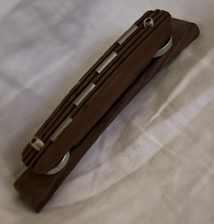

    Finally getting some clear on it. Should the saddle be finished or is lemon oil ok? It appears to be the same wood as the fretboard.
