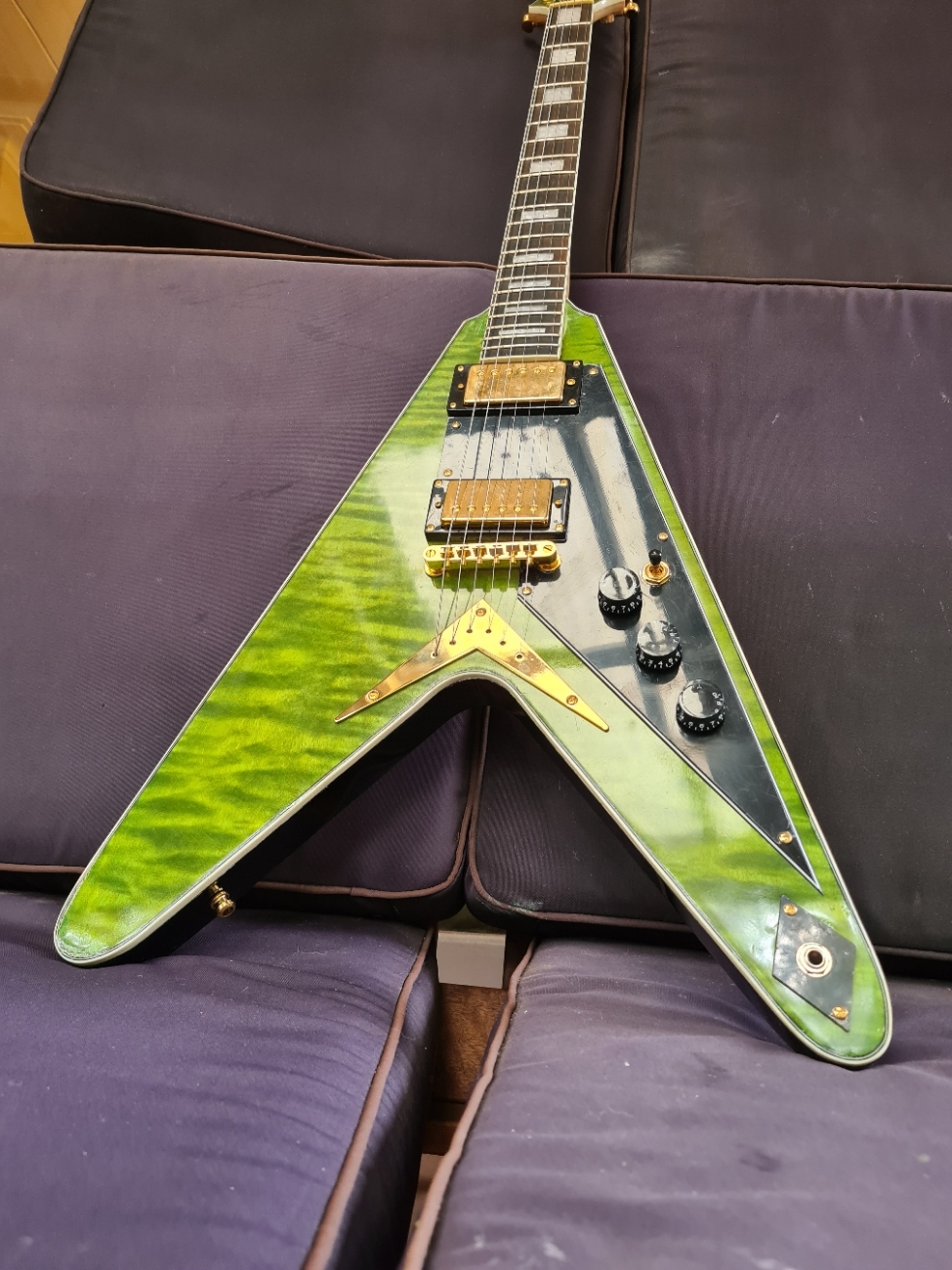

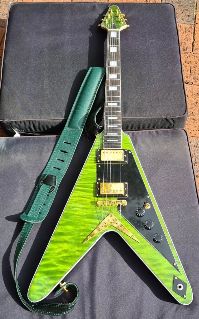

  9. #59
    265
    Anyway - basically finished body-wise and despite the need to revisit wiring I can share the general result.
