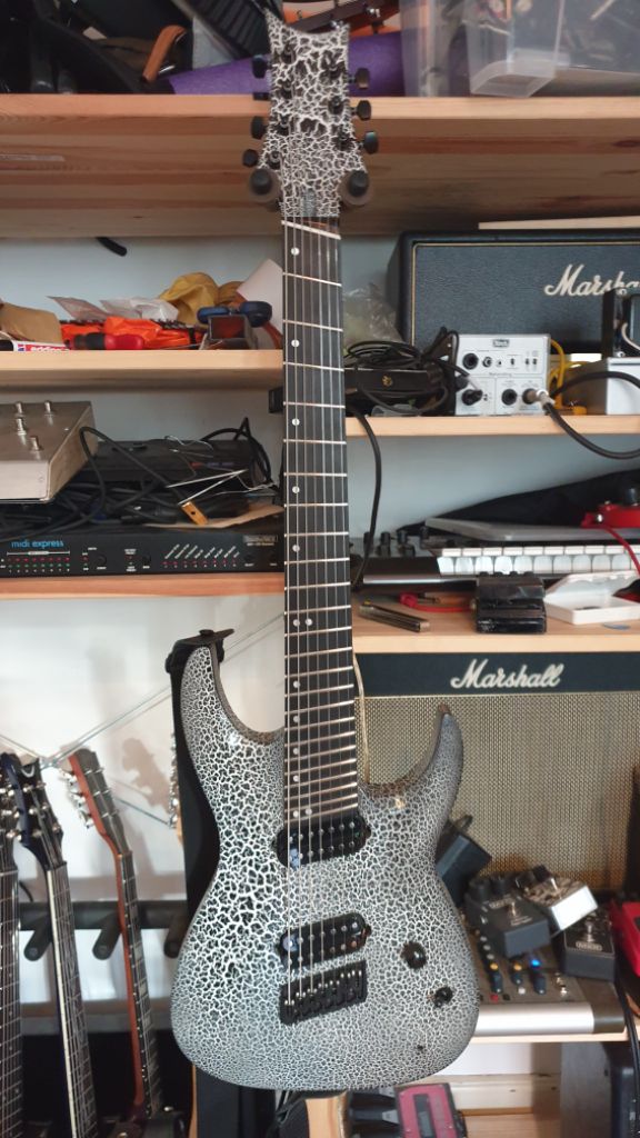

  9. #29
    Member lickmydoo's Avatar
    Oct 2020
    Geneva, Switzerland
    26
    Hello there,
    As we say in French : VOILÀ
    (Sorry for the mess in background)
    I had a rough time leveling the frets as i started sanding only to realise that one fret was not correctly slotted and after pushing it down it was too low so i had to level again.
    Now i got a pretty low action no fret buzz exept when I hit the low B too hard. Bridge was correctly placed, intonation is ok.
    As i expected, machine heads are low quality and pups are somehow not so bad as i thought, maybe a bit muddy on the low end but a screamer type od just do the trick.
    It was a great experience. I learned a lot about guitar tech but also about myself.
    Thanks to everybody (mention to Mr Barden) for support and info and insight etc.
    Have a great holidays, special thoughts for the UK members and hopefully next year will be better than the last.
  10. #30
    Mentor DarkMark's Avatar
    Sep 2017
    1,572
    Well that didn’t turn out as you originally planned. Very impressive none the less. Amazing finish.
