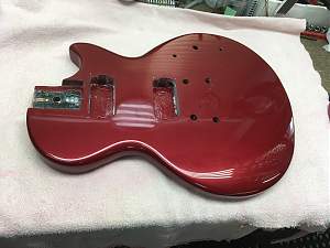

    OK... finally back moving on these builds...
    Wet sand & polish on the LP-ish thing. Got a bit of sanding/polishing on the neck to do, then I'll begin assembly.
    These two are definitely the slowest builds I've ever done. Not that they've been difficult, just other stuff popping up and a series of motivational slumps
    At least it's smooth & shiny now!
Name:	Candy Red Pearl Polished.jpg

    Looking good. What's the eletronics plan?
  10. #20
    Thanks BD!
    It will be a little different in that it will have Fender single coils in it!
    A Custom Shop Twisted Tele neck pickup and a Custom Shop Texas Special in the bridge.
    Standard 3-way switching: N/NB/B with master volume, master tone.
    I suspect this might a naturally bright instrument, so I'm considering going with 100 or 150k pots.
    I'll have to try it and see where it wants to go. I'm leaning towards calling it a Les Tele, but maybe a Tele Paul...
