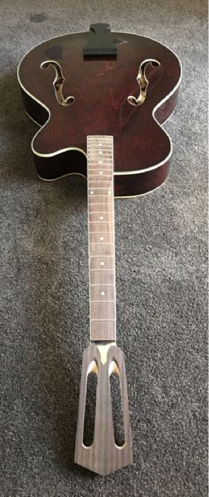

    If you have any experience with the set neck kits you will know they only fit together one way. A little while ago I was thinking about why I’ve been have so much trouble with floating bridges with my other two kits? It occurred to me the necks have been set at an angle for non-floating bridges (please correct me if this is untrue). This time I have raised the depth of the neck pocket and adjusted the neck angle to what I hope will be appropriate for a floating bridge. As a result I have some gaps to fill. Maple veneer to fill the gap as seen in the photo and plans to put a rosewood cap on the back.
    It’s a good point, not sure the factories would consider that in their templates.
