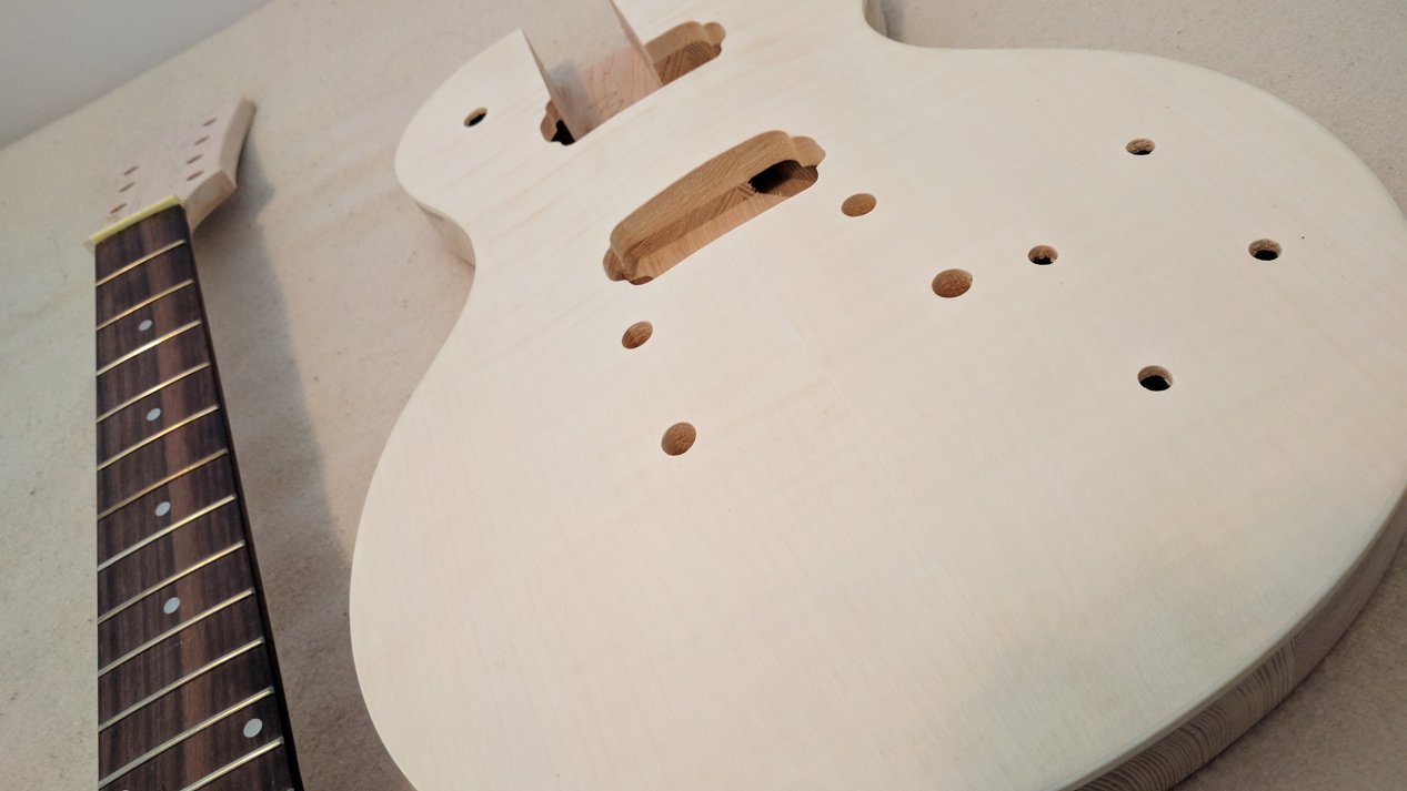

    But more impressive than looks, is how awesomely snug that neck pocket is, and how little work it seems to require at this stage. It might sit up at the back slightly, but I won't know until I do a full test-fit later. Why later? Well read on...
Name:	Step 0c - Neck joine seems nice.jpg

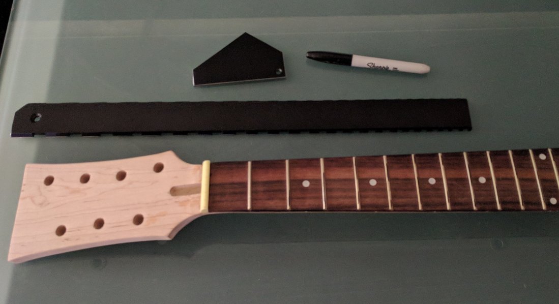

    However, now we get to the ARRRRGH moment. On initial inspection of the kit, while I'm super-happy with the rest so far, this neck looks like it is going to take some serious effort. I didn't realise the nut was going to be like it was (requiring re-setting, sanding/shaping, and filing), so I've hit up StewMac for some nut files. But more scary than that... is that the neck looks like it has a double-bow in it (almost like a twist), and the fret jobs is less than ideal. As such, I've ordered a Crimson Guitars fret kit, and will check everything with my notched fret straight-edge when it arrives. Hopefully some truss-rod tension adjustments, and maybe a fret level will fix all that: Fingers crossed. And yes, I also have a fret levelling beam, triangular file, and fret rubbers in the kit too... so I'll be learning that whole process for this project. Yay.
Name:	Step 0d - Neck bow and fret levels.jpg

    Yeah dude, Do all your neck and fret checks first.
    You may find that one or more frets are not seated properly and that may give the impression of a bow, or two.
    Your 'looking along the neck' picture doesn't look bad at all to me. Best to wait until you've got your notched ruler and can set the neck level and see how it is then. A fret dress can accommodate a very slightly twisted neck but anything more and you'd really need a new neck. However it doesn't seem bad to me, and I've had guitars with what appears to be more of a twist than you have, that have played well.

    Absolutely. I can clearly see a few high/low frets by eyeballing it. And while the picture doesn't really show it, the neck looks like it is slightly thicker on the right (as pictured), until about the 5th fret, then seems thinner. and it switches to being thicker on the left side. Definitely seems like a bit of a twist... though I'm not sure how that could happen unless the rosewood fretboard was torqued and clamped down over an uneven neck top (which I doubt). I'm not the only one that noticed it, so its not just my imagination... but I am hoping it is an optical illusion, possibly created by a neck bow due to truss rod needing adjustment, combined with some fret level issues. Oh well, the new tools should arrive this week, so I'll check it out and post the results. Fingers crossed.

    So yes, the first thing I wanted to do, was check out that weirdness I was noticing with the neck. I used my new notched level to ensure I could tweak the truss rod to make things level, and then set about using my new fret rocker to identify anything going on with the fret height. Obviously, I'm using the trusty Sharpie to mark any high points, and will address any of those a little later.
Name:	Step 1a - Fret Testing.jpg
    And the result is, I both was and wasn't imagining my neck being "twisted". Turns out, it wasn't twisted, however:
    a) The truss rod was obviously loose for/from shipping, and the neck had a bit of a standard bow in it (which was part of the optical illusion).
    b) The other issue, was the weird fret heights. These definitely did start high at the top of the nut end, and transitioned to being high on the bottom of the other end. This reinforced the "twist" illusion.
    These two things, when combined, gave it made things look worse than they actually are. Luckily, I knew this wasn't an Ikea guitar kit, so purchased the tools I needed to identify the issue.
Name:	Step 1b - Neck Testing.jpg
    And that's where I have my first couple of questions:
    - What is the fret material used on these kits?
    - And based on that, what grit of sandpaper would be recommended for this fret material? Work it with 320? Higher?
    Importantly, I also have multiple grit fret erasers, a fret crowning tool, and StewMac fret polishing wheels for my Dremel... so I can deal with any marks the sanding process introduces; I just don't want to accidentally ruin my frets by using too course grit for the job.

    And speaking of grit... the sanding has started. The first of many, many, many passes I am sure. The next was pretty smooth, so I took off any roughness with 320g, then moved on to 400g (including wet sanding). The maple veneer was also pretty good, so it got the same treatment as the neck.
Name:	Step 2a - Sanding.jpg
    The body, however, was a bit rough... so I've started that at 240g. I've now wet everything down, found, and sanded off any glue marks, so it's coming along nicely.
Name:	Step 2b - More Sanding.jpg
    Next step, get to work on those frets, and continue sanding, sanding, sanding.

    Nice bits of timber you have to work with.

    The frets are made of a soft metal, it doesn't take much to sand them, so don't go too course a sandpaper on them.
