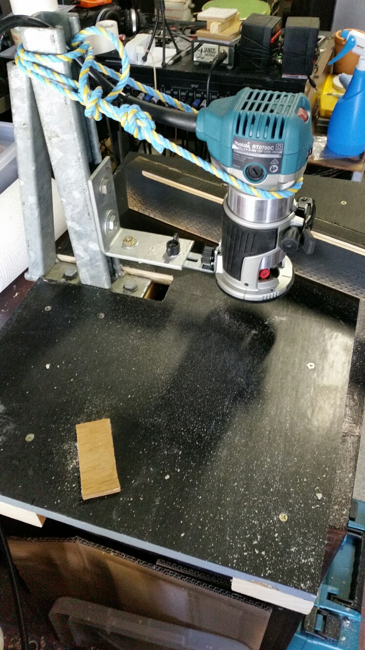

    Took a leaf out of DB's book and built a jig to do the routing for binding. Test cuts worked well, just need a 1/4 inch shaft rebate bit that gives me the correct cut depth and I'll be able to proceed with my partscaster Alder Denim Tele build...
    The rope is only for stability. On its own there is some wobble in the motor head that I didn't want, so putting a little tension on the metal frame fixes that. Test cut on the pine block looks quite good by my half blind eyes...

    cool idea Marcel, is there a way to make the router to bracket connection more sturdy so the router has little movement ? I assume you move the body underneath and the pattern bit follows the edge of the body?
  10. #40
    Mentor Marcel's Avatar
    Apr 2017
    Bouldercombe Qld.
    1,168
    Not really Wokka. The router comes with a L shape bracket that is solid enough to be used as a guide but is just a little light to hold the router on its own. A more solid L bracket would be better. My little arrangement with the rope keeps the L bracket under light tension and holds the router quite steady.
    Yes, the job moves under the router and follows the pattern or rebate bit bearing. The base board is standard plastic coated builder concrete form ply. The upright strut is a Uni-strut piece bolted to some pine 45x90 under the form ply.
