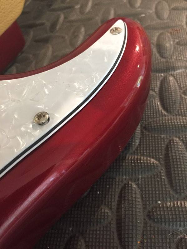

    Hows this
    Thats a candy pearl colour. I would recommend, hitting the old Supercheap auto. There are an amazing amount of reds in sprays that look great.
    Phrozin has done a great tute on one of his build diaries about spray painting with rattle cans. Have a look at how he does it. I just level, grain fill with timbermate, use the undercoat, colour and gloss coats from Superrcheap. peasy as mate.

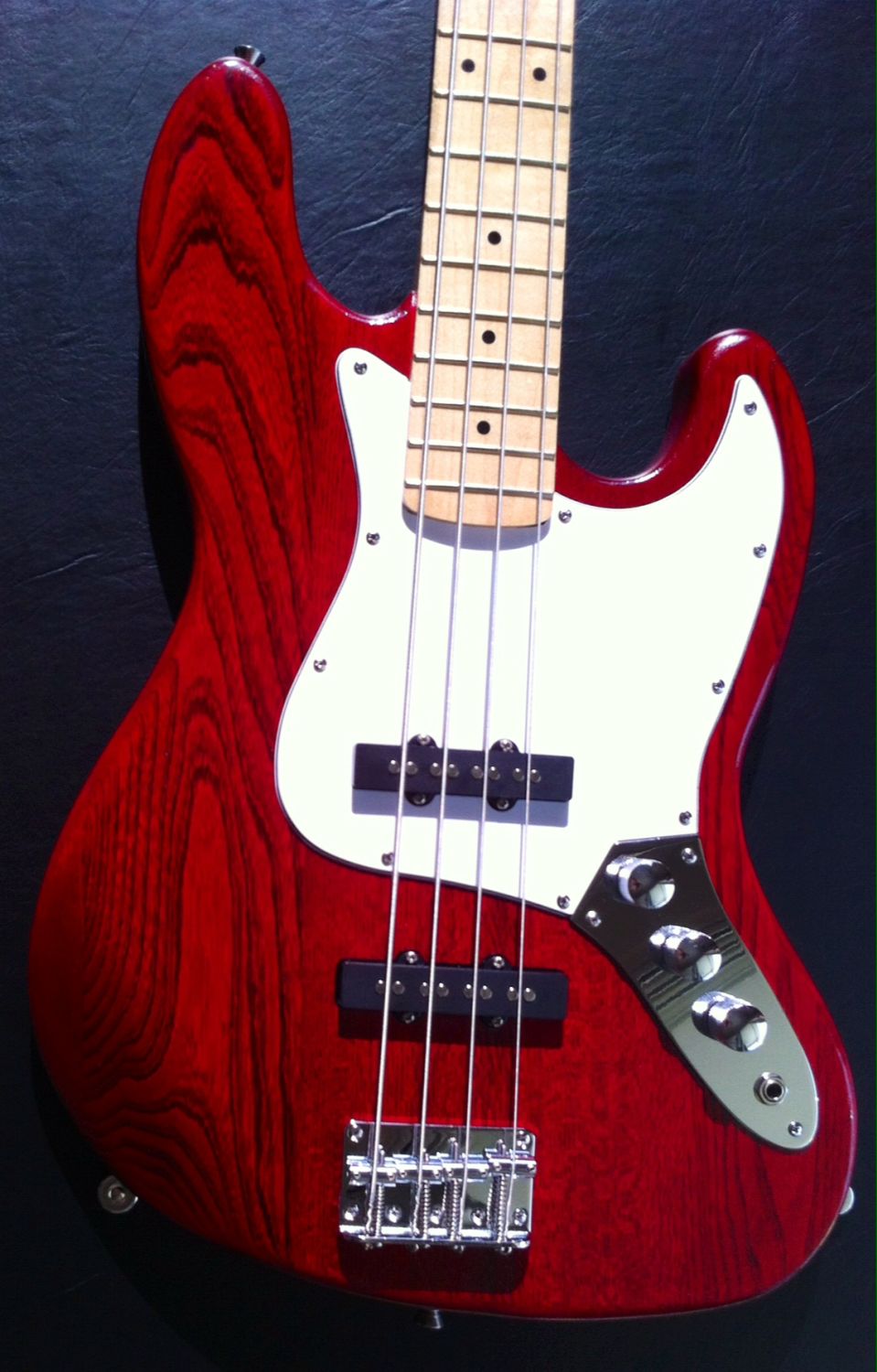

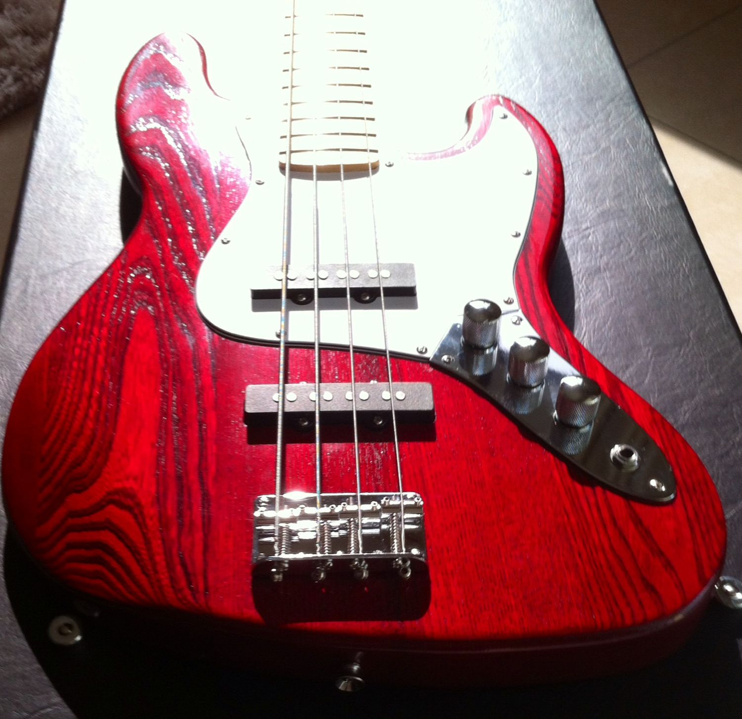

    Quote Originally Posted by Hobastard View Post
    I was thinking more along the lines of an ink and clear coat. Is that possible???
    Something like this perhaps???

    That's a good example Waz (I had yours in mind), though it does also show how the (darkened) ash grain brings the overall brightness of the finish down. Bits of that are very close to a fiery red (in the right light) and others almost a brown.
    But would something like that be acceptable, Hobastard, or would you generally like it more vibrant? Not dark staining the Timbermate would help a bit, but some of the grain on ash is very dark anyway. It's lighter on basswood, but that often has very little grain to it, though some pieces do seem to have lots - but probably best to assume not much unless you can pick the exact body you want.
    Hi Simon, used ebony timbermate as I was wanting to accent the grain in a dark contrasting way. I reckon if stained without TM that the stain would have come out a few shades darker in those grain patterns but not as dark as the ebony filler. Maybe this could be an alternative approach worth considering?
