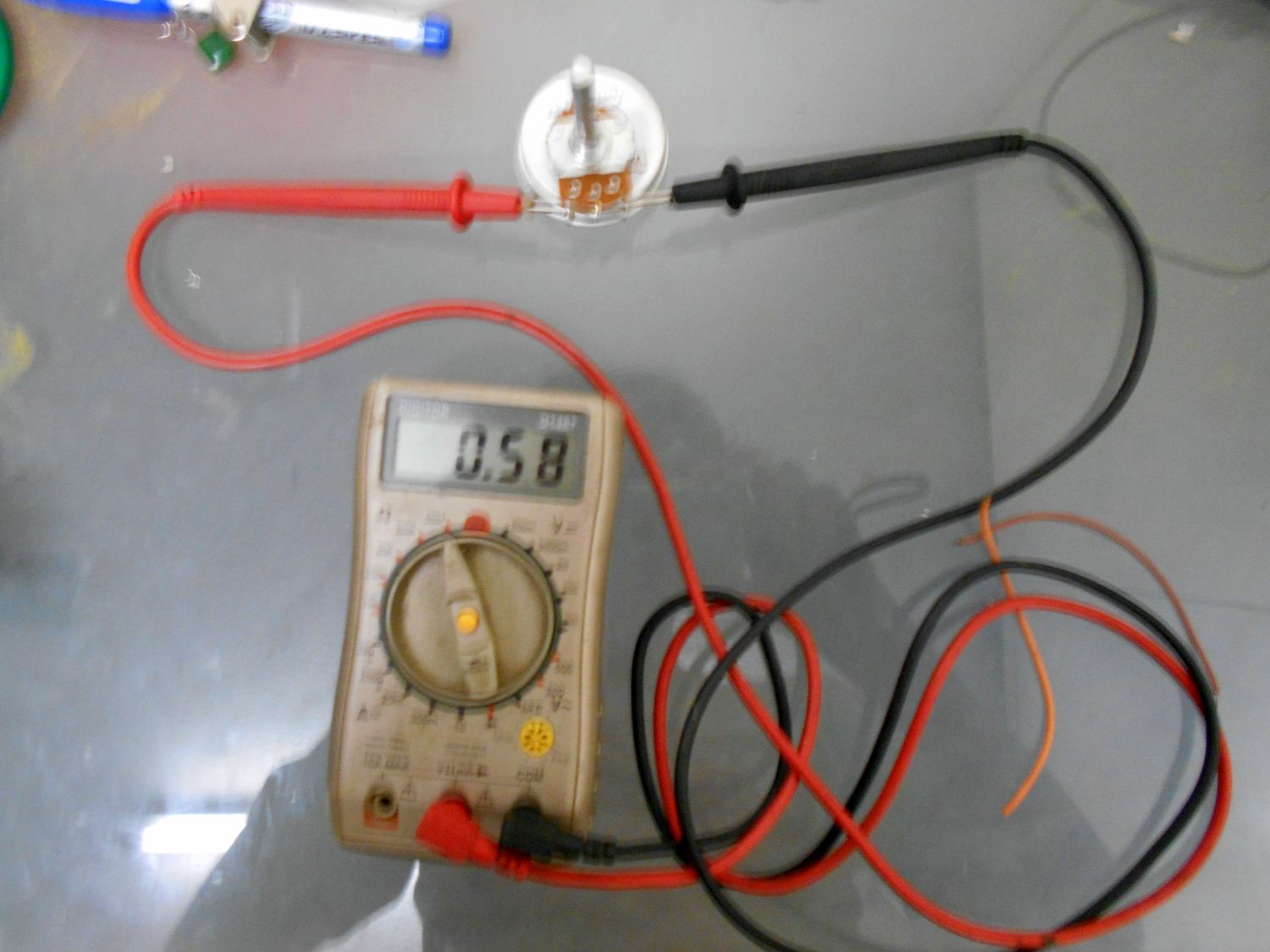

    Here's an example to illustrate how to use a Multimeter to measure Resistance, in the following pic I have set it up to measure the Resistance of a 500k A (Log, or Audio) pot, I have the tip of the Red probe touching one of the outer solder-lugs, and the Black probe touching the other solder-lug, the middle solder lug is the wiper connection.
    Because the pot is a 500k Log I have set the rotary switch to the 20M (20 Mega-Ohm) range.
    The display shows the actual Resistance of the pot, in this case it is about 580k, or 580,000 Ohms, which is normal.
