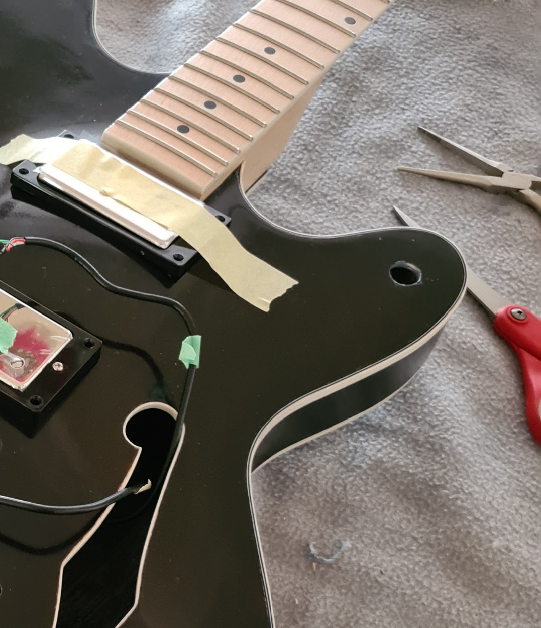

    Another issue with this kit. The hole for the three way switch is drilled too close to the point of the horn. One side of the hole is simply a drill hole into solid wood in the tip of the horn - not into the cavity of the guitar. This means the switch provided is completely impossible to fit through the hole. I tried enlarging the hole carefully with the file, but it will not fit because the body of the switch is impeded by wood.

    I have seen a 3-way miniswitch - with a similar sized toggle, but body that is really no wider than the switch nut assembly. This will fit but requires a 1/4" hole - half the size of the one currently in the guitar so I guess I would need to use a washer to fit / stablise. Has anyone used these before or have any recommendations.

    It is just possible that a right angle Gotoh three way switch will fit but I suspect the hole might still be too close to the solid wood in the horn.
    The real pain is - even having masked off the hole when trying to enlarge slightly - I slipped with the file and made x2 small dents in an otherwise pristine finish ! Will probably need to give it a quick light dust with some nitro on that horn again.
