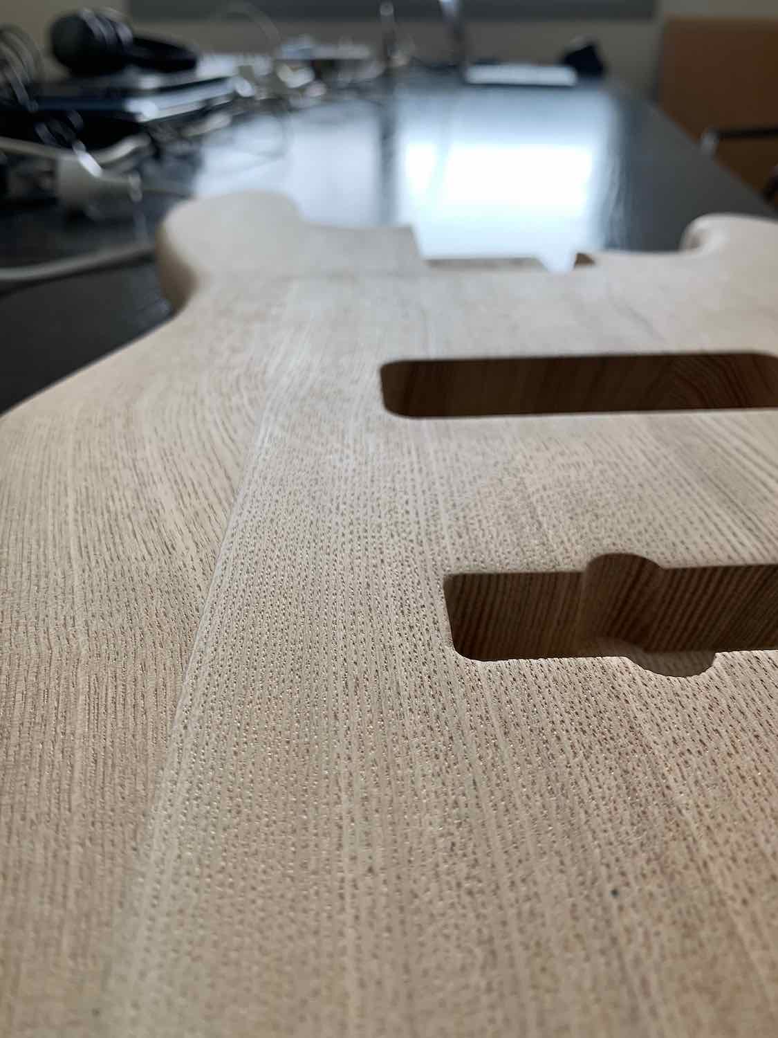

    First day of work is done, i did a mock build and everything looks good.
    Then started sanding the body. Ive never done any sanding before, so was a little learning curve. Started using a Orbital, but was finding it hard to keep the sanding along the grain, so i switched and did all the sanding by hand instead. Felt like I had much more control.
    I did 120 grit, then 240 grit, but i only had some 600 after that. so i decided to just try and do 600 straight from 240.
    i think it turned out okay. Im sure if i had 400 inbetween i might have been easier, but im quite happy with the result still.
    here is a picture of the work so far

    Hi Matt,
    I'm sure most folks only go to about 180 or 240 grit when sanding so that stain will absorb more evenly.
    This is a quote from Simon Barden re sanding:
    "240 at most but 180 is better. You really only need to get the surface flat before staining. Too high a grit and you can burnish the wood surface in places, causing uneven stain take-up. Save the finer grits until after you’ve put your finish coats on. Just nake sure that you’ve removed all the sanding marks from any coarser grits you may have used to start with, as scratches will absorb more stain and show up as darker lines."
    Taken from the thread https://www.buildyourownguitar.com.au/forum/showthread.php?t=11001.
    I have tried to follow these suggestions with my builds. I'm sure the ceruse style would be the same.
    Regards
    Ah intersting.
    so today i tried to start staining the body, and it is exactly like you said. The stain definitely did not take very well or very evenly.
    it is still okay, but I'm thinking tomorrow when its fully dry i will give it a good sand with 120 or 240 to help the next coat of stain take much better.

    Quote Originally Posted by Mattbell93 View Post
    Ah intersting.
    You may need to go back to 80 & 120 to open things up a bit before doing a final 180.
    Cheers Waz
    Yeah I went back to 120 today and that seems to have done the trick,
    I reapplied stain, and it took much much better today.
    gonna do 1 or 2 more coats of stain and go from there
    I am also thinking to switch from a black grain filler, to a white grain filler.
    As the stain was a much darker blue than i was anticipating, but still excited for the look
