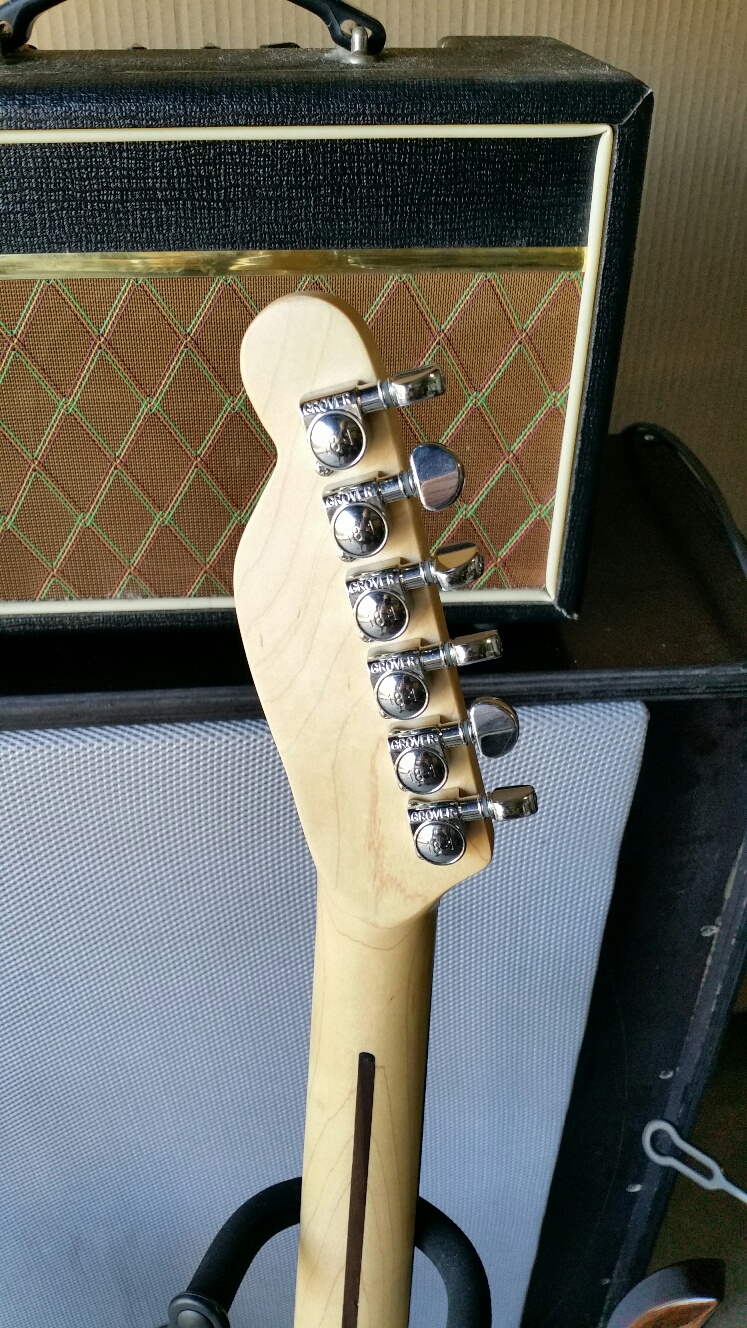

    While not Australian or USA made there are Chinese ones on Ebay that are reasonably decent as a start for quite good prices...
    I've bought three Kmise necks via Ebay in the past, all were very straight and after a little fret work have come up quite good. Two were Amber gloss finished 'Rosewood' Strat necks for AU$100 that initially equated to Squire level quality, and the third was a Satin finish 'Rosewood' Tele neck for AU$75 delivered that I put on my denim Tele is as good as any MIM neck that I've ever seen. As can be seen in the photos all three came with pre-shaped headstocks and a quite high quality finish, and the Amber coloured Strat necks have quite a nice flame in them.
    Kmise also make all Maple necks for similar prices, I can't attest to their quality however I'd suspect they would also be quite reasonable.
