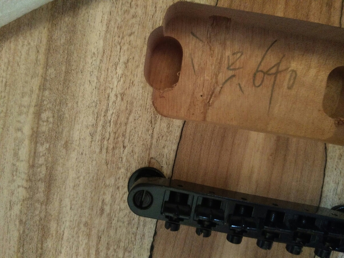

    Unfortunately, a ~ 0.5 cm x 0.5 cm piece of the veneer came off when i removed one of the bridge posts to sand the hole. I might post a picture of that later. I think I will try to just glue it back in place, do you have any tricks/tips for that?
    Here are the pictures of the piece that came off.
ID:	31773 Click image for larger version.
    2,824
    A bit of CA and it will be fine but you will always know, something that bugs me about one of my builds after swapping a nut
    Gorgeous top on that guitar!
