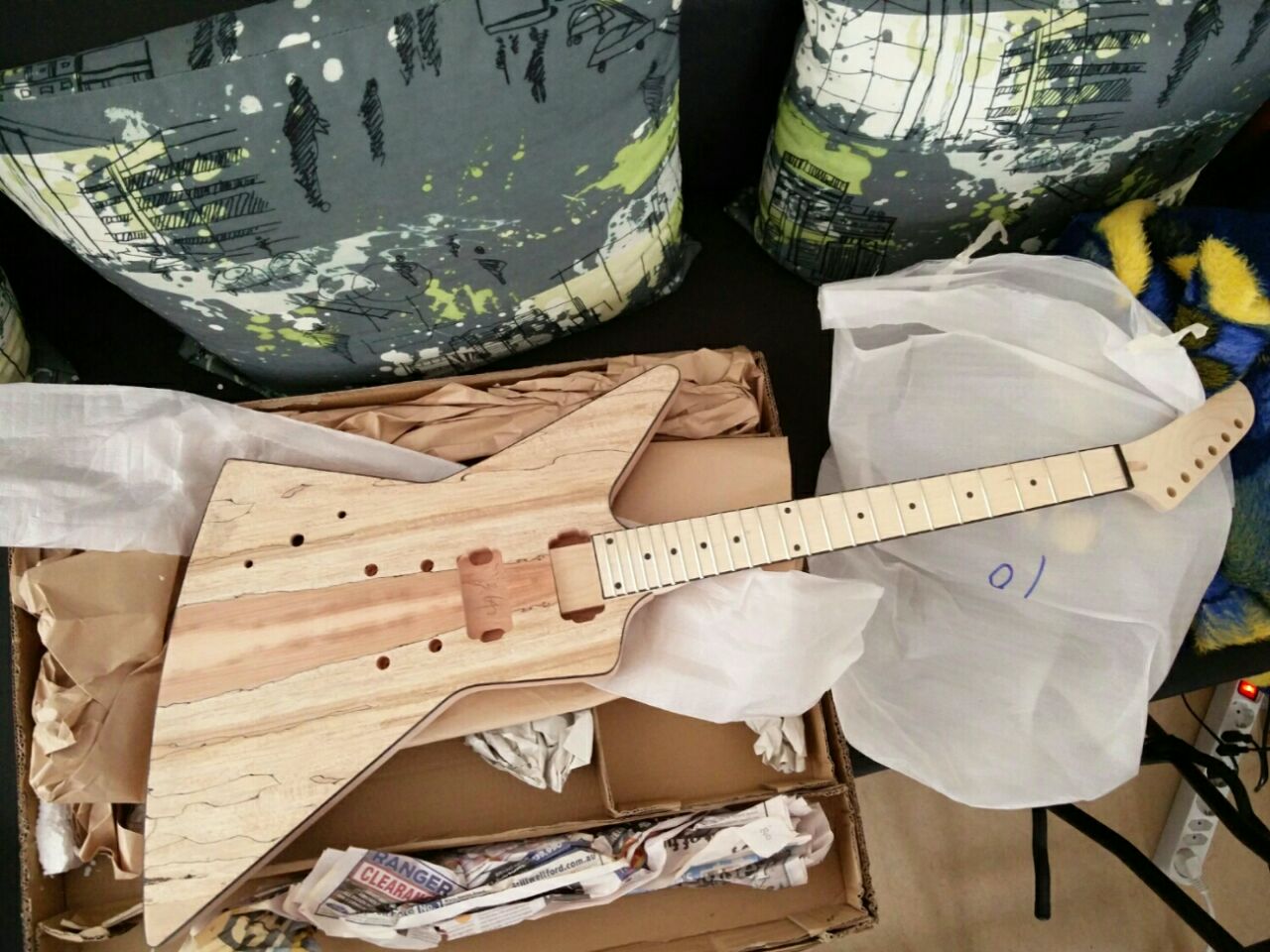

    For this build I ordered a Custom EX-1L with a spalted maple veneer, mahogany body and maple fretboard/neck, black binding and black hardware. But, see for yourself in the attached image. I for myself think it looks really stunning already - that's why I am planning to just leave that natural look and use tru oil for the finish.

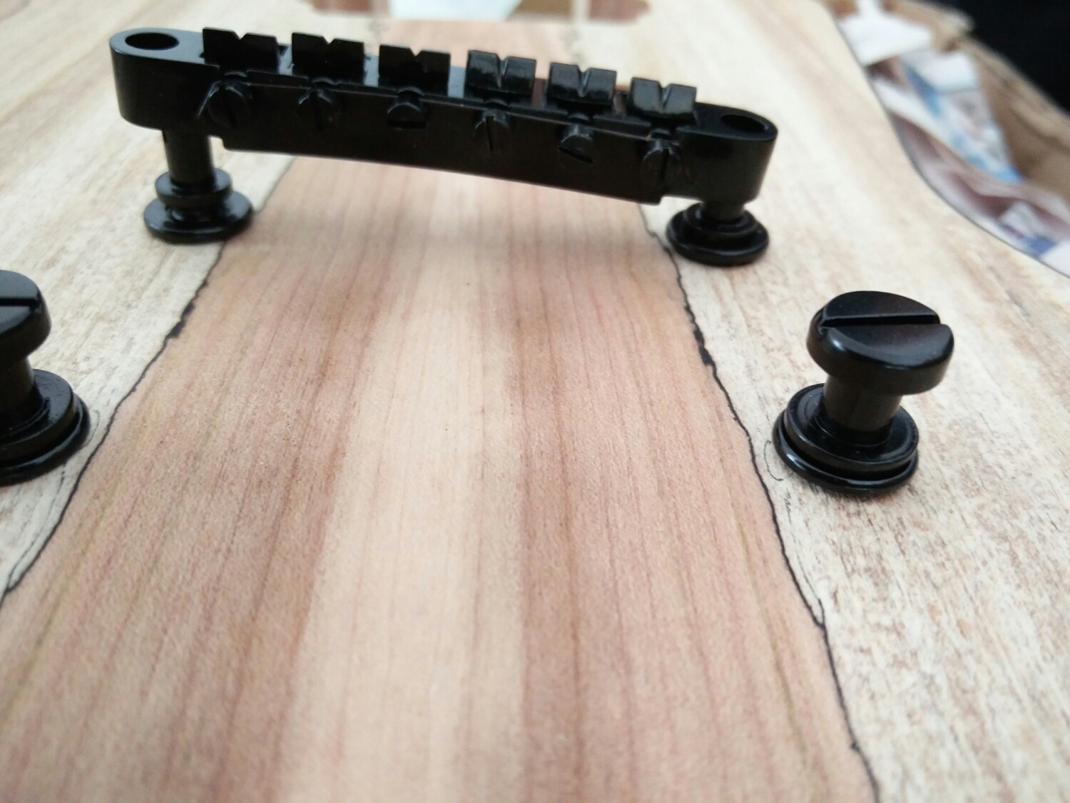

    Overall the Kit looks well made, however, the holes for the bridge posts are a bit too close together for the bridge to fit. Adam suggested to use a pen wrapped in sandpaper to widen the holes a bit. I already followed that advice and was able to screw in the bridge together with the posts, however it's a bit to tight and the bridge cannot move now I will probably remove it again and sand a bit more.

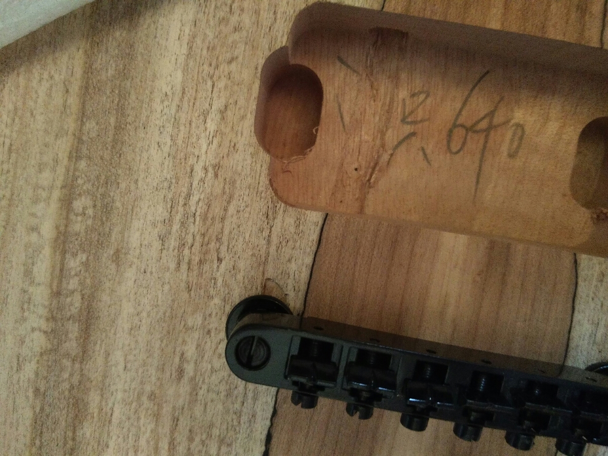

    Further the neck pocket is a bit to tight for the neck to fit in. My plan is to follow Adams suggestion again and sand the sides of the neck pocket evenly until i get a tight fit for the neck.

    Hi tobagon, my experience with set necks has been that a little sanding of the pocket/neck is required to get the neck to fit, but proceed with care as you don’t want to mess up angles.

    I had the exact same problem with my kit...the bridge stud holes were 2-3mm too close together...meaning I couldn't mount the tunomatic bridge on.
    You have a couple options....you could dowel 1 or more the holes and re-drill them...or sand them out so they are broader.
    In the end I only discovered it right at the end of my build...I used a thinner style bridge post from a spare I had lying around.

    I think for now I should only sand the sides of the neck pocket. As soon as the neck fits in the pocket I can check the angle of the neck and bridge - nut - distance.... right? I have to remind myself how to properly do that, I think there are some good guides around here.

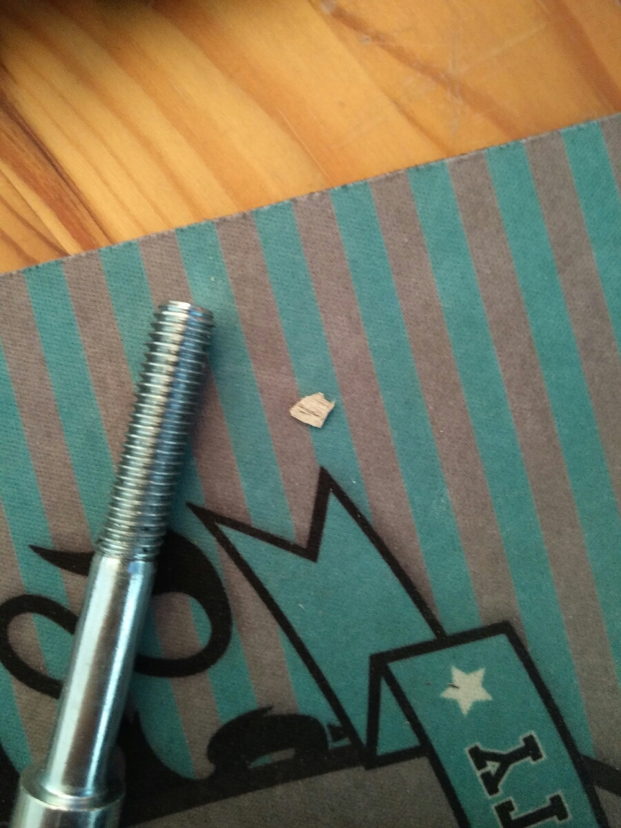

    Unfortunately, a ~ 0.5 cm x 0.5 cm piece of the veneer came off when i removed one of the bridge posts to sand the hole. I might post a picture of that later. I think I will try to just glue it back in place, do you have any tricks/tips for that?
    Here are the pictures of the piece that came off.

    A bit of CA and it will be fine but you will always know, something that bugs me about one of my builds after swapping a nut
