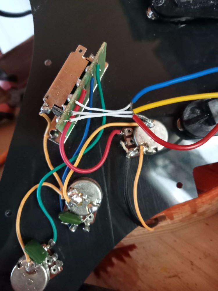

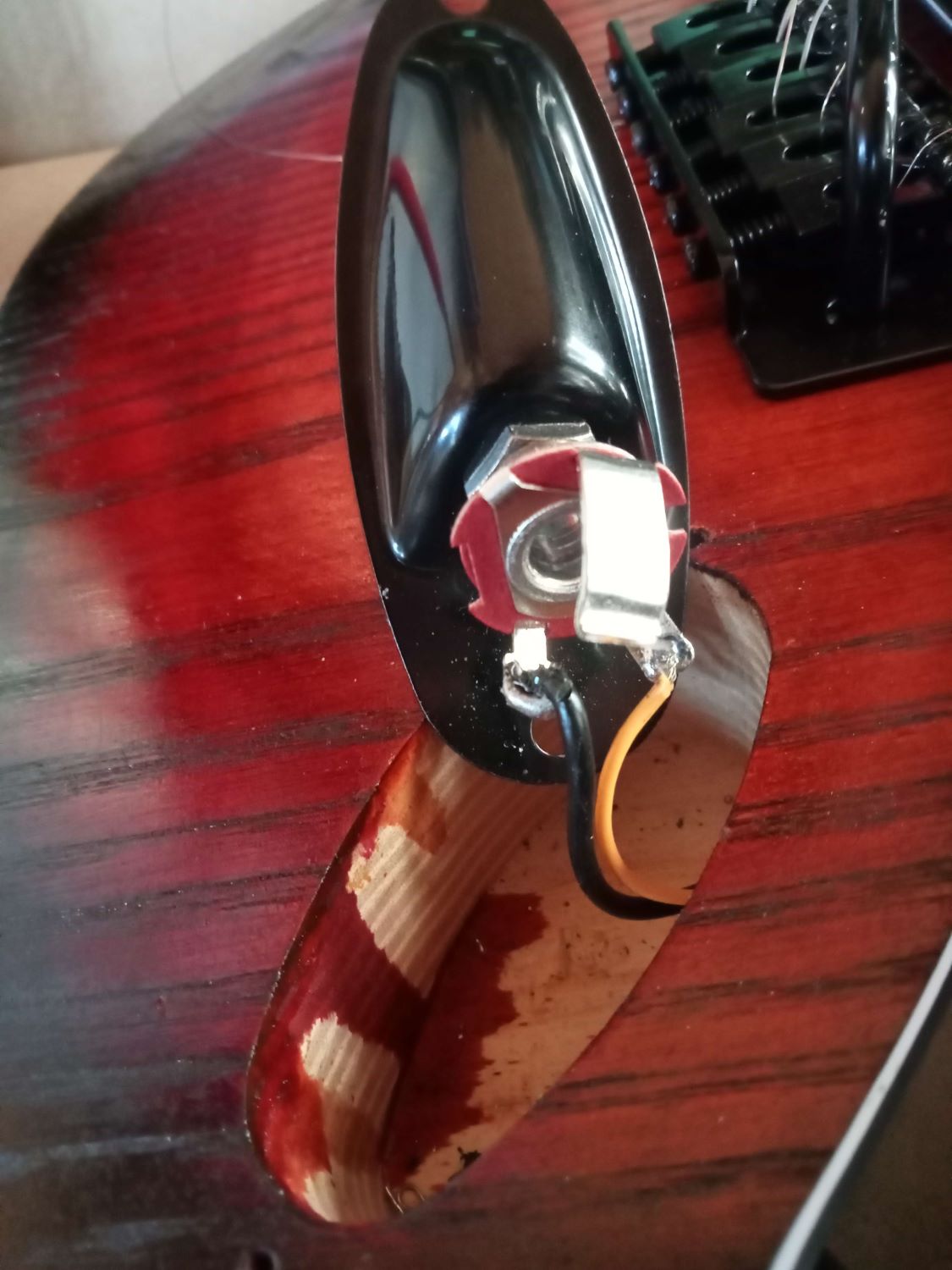

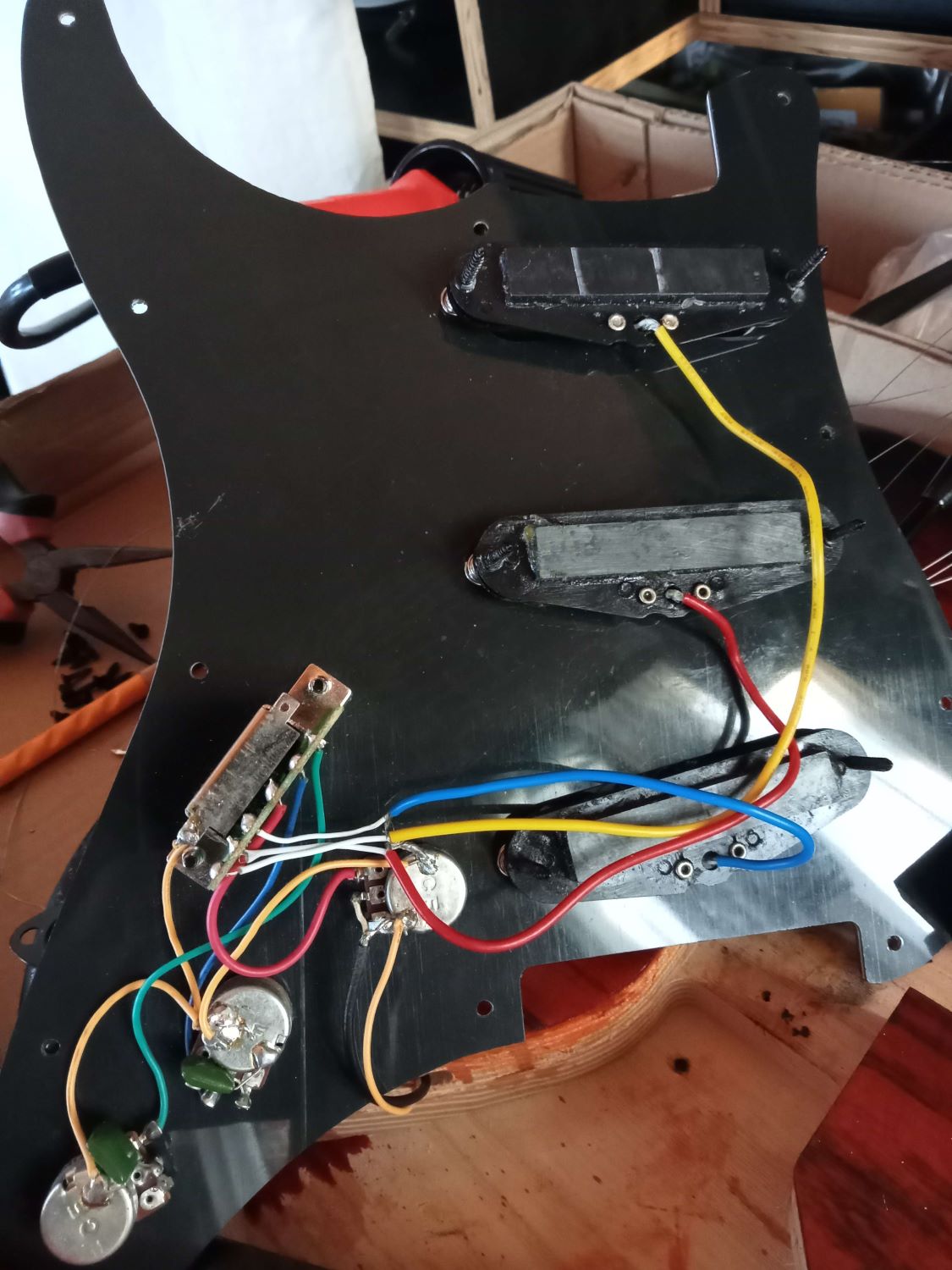

    I'm relatively new to the electric guitar and just built my first Pitbull kit, a dst1 with mahogany body. After all the finishing I assembled the whole thing and plugged it into my amp to find there was no output. The only points of soldering was a yellow and black cable from the volume control which I soldered to the output jack. I switched them around to see if that was the mistake but still no sound. Just wondering if anyone knows what's wrong, thanks.

    Also, can you include a photo of the pre-soldered section, and the jack soldering. It might give an indication as to the problem.

    The black wire from the volume pot also contains a white wire and the ground (shielding). The white wire is the hot wire. The yellow/orange wire is probably the bridge ground.
    You will need to desolder the jack socket. Then strip the end of the black wire and so that you can locate the white wire. The white wire will need to be stripped a bit and soldered to the jack hot terminal, and the black shielding wire soldered to the jack ground. The yellow orange wire should be soldered to the back of the tremolo claw.
    I hope this helps.

    Also, but it is hard to see from the pictures, you may want to use more solder when soldering to the jack socket. There is lots of room to add heaps of solder on those lugs.

    It's exactly as TD has suggested, as far as I can see. Orange wire to the claw. JUST the black wire to the jack. The shielding wire should go to the the jack's ground (the ring lug). The white to the jack's hot (tip lug).
    That should work if all the other connections are correct. The pickguard came pre-wired, correct?
