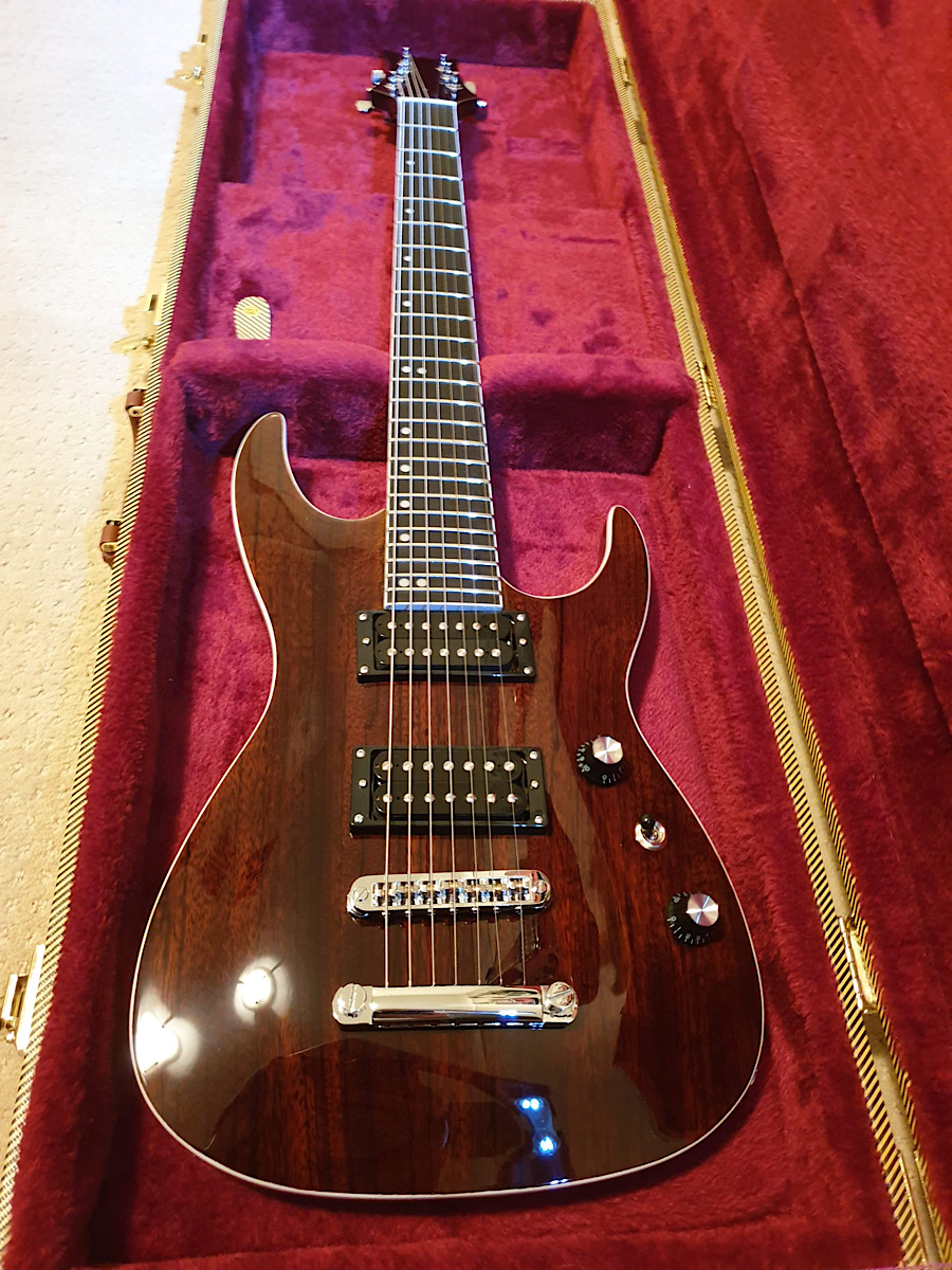

    GS7-Z with upgrades.
    The mahogany neck and zebra top was filled with black grain filler and stained, back was painted jet black with double stingers on the neck, everything except fretboard was clear coated.
    Upgrades are CTS pots, Orange drop cap, Switchcraft jack, bone nut, roller bridge and Guyker professional locking tuners.

    beautiful finish you have done well and not over the top, loverly and flat you have put some work into that fella😎👌

    Thank you, yeah a few months worth of work, built for a friend so I always go a bit ocd 🤣
    Shame one of the strings was not in the roller bridge properly for the pictures, didn’t see it till after I posted the picks 🤦🏻

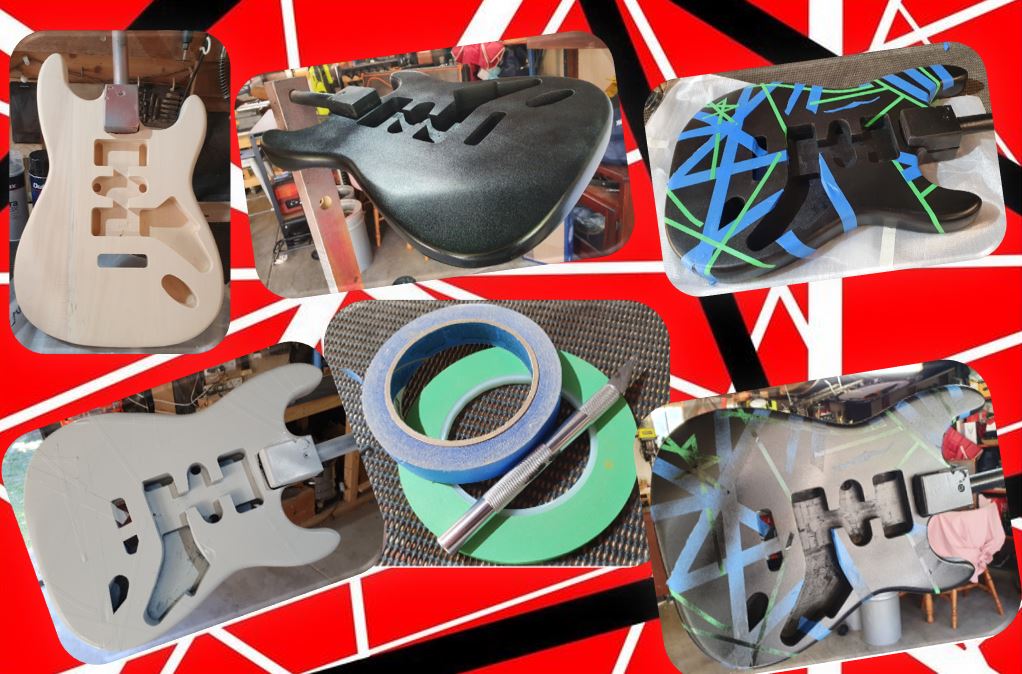

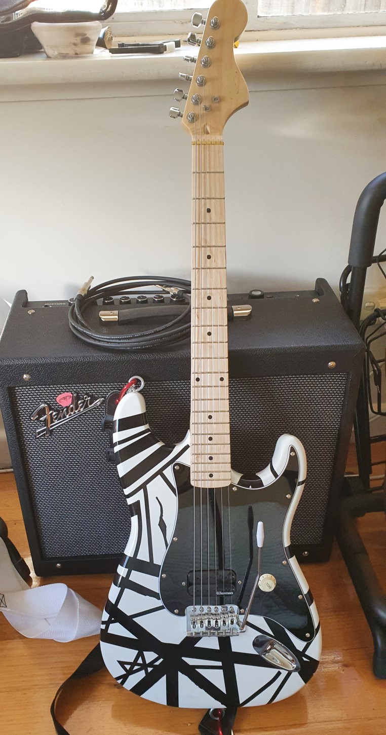

    Here is my '78 EVH Frankenstrat replica.
    ST-1M is the base for this. All up cost was under $300 (For me that is great as I usually blow a load on hardware and pickups).
    The changes to the stock kit are some locking tuners, Brass nut and single humbucker guard with a Warman pickup I had lying around from a previous build. Wiring is fairly simple, single volume with a push pull to split to single coil. The tone knob is off my old fender strat.
    The strap eyelets are from Bunnings and will hold up a house if needed.
    I had added a logo as per the original but covered it for this post.
    Paint process was clear base coat, 3 layers of black, tape up then a dust coat of black to prevent any smearing under the tape. It only needed 2 coats of white, then several cans of clear. I used Duramax for this guitar.

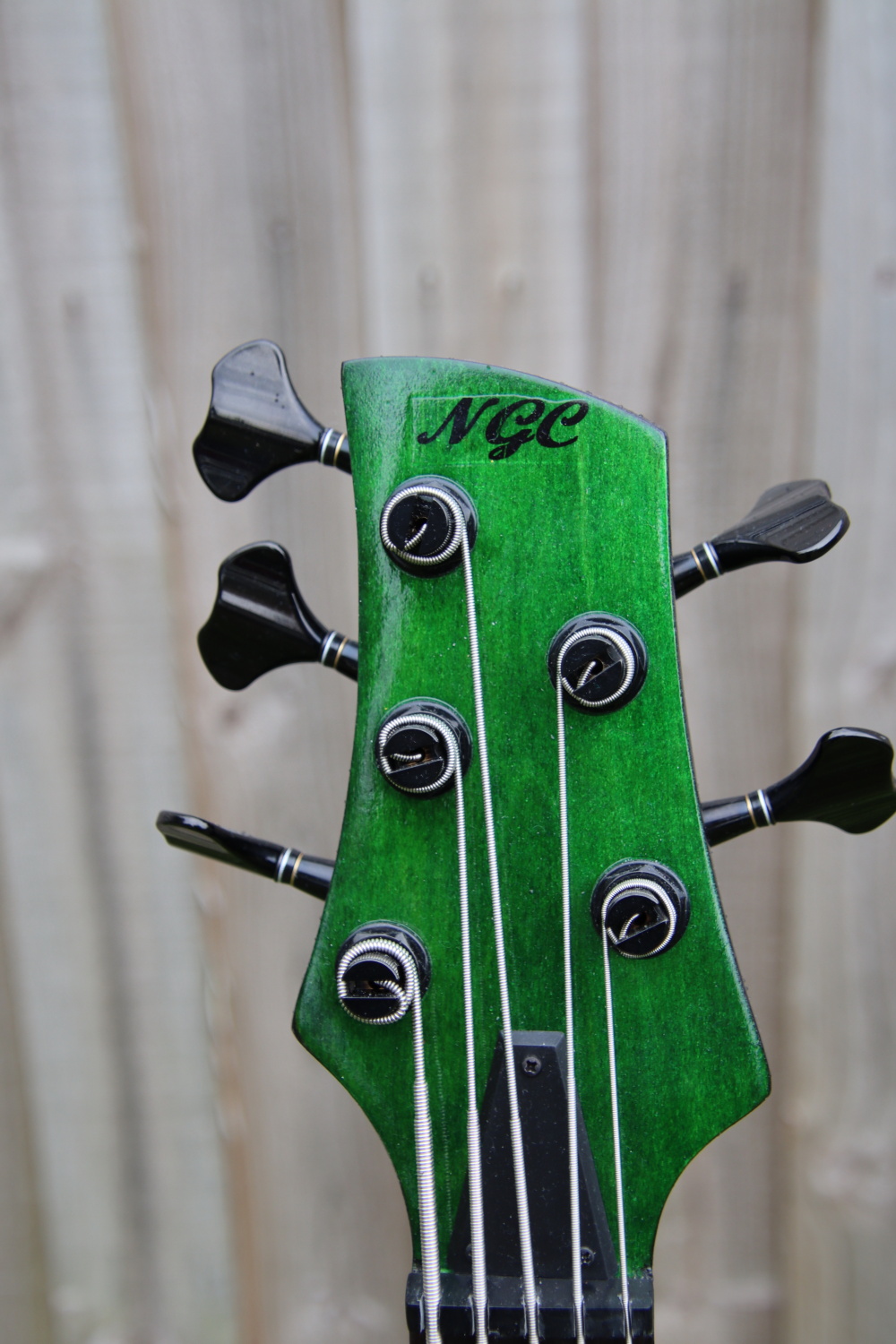

    Hi all,
    Here are some pictures of my recent IB5 Bass kit build. I have upgrades the kit with Gotoh tuners, a Schaller bridge, and I have installed Ernie Ball slinky 45 to 130 strings.
    I have recently gotten back into playing music after around 10 years after being left stuck at home with some ongoing heath problems. I was on the lookout for a 5 string bass, however nobody had anything in stock that really appealed to me, and as I enjoy woodworking as a hobby, it was the perfect project for me to take on. The body and headstock were coloured with Ubeaut Green dye, and sealed with multiple coats of gloss clear lacquer. The headstock decal is my initials that I printed out on DIY decal paper, that I then attached and glossed over several times to protect it. I had originally intended to leave the back of the headstock its original maple colour, however, despite masking the area off, some of the dye was able to penetrate through, and after sanding for quite a while and removing a lot of material, i still could not get rid of all of it, so I made the decision to airbrush the back and sides of it gloss black, and I actually really like the contrast in colours. The neck itself is clear coated with satin clear varnish. I love the look of gloss painted/varnished necks, however i personally do not like the feel of them. The fretboard was treated with fretboard oil to both protect it and bring its colour out.
    I am still playing with the setup on it a little bit; I have a heavy right hand and I hate fret buzz, however I may still drop it a little bit further. Overall, I am really happy with my build, and I think that there is nothing better that being able to play something that you have made yourself. For future builds, I am considering getting an airbrush stencil with my initials in it so I can spray it on the headstock for a flatter finish, and also use metallic colours which you cant do with a normal printer and decal paper. The only other issue I have now is that the Amp I currently have doesn't like the b string at higher volumes, so I guess I will have to upgrade it...…well, that's my excuse anyway
