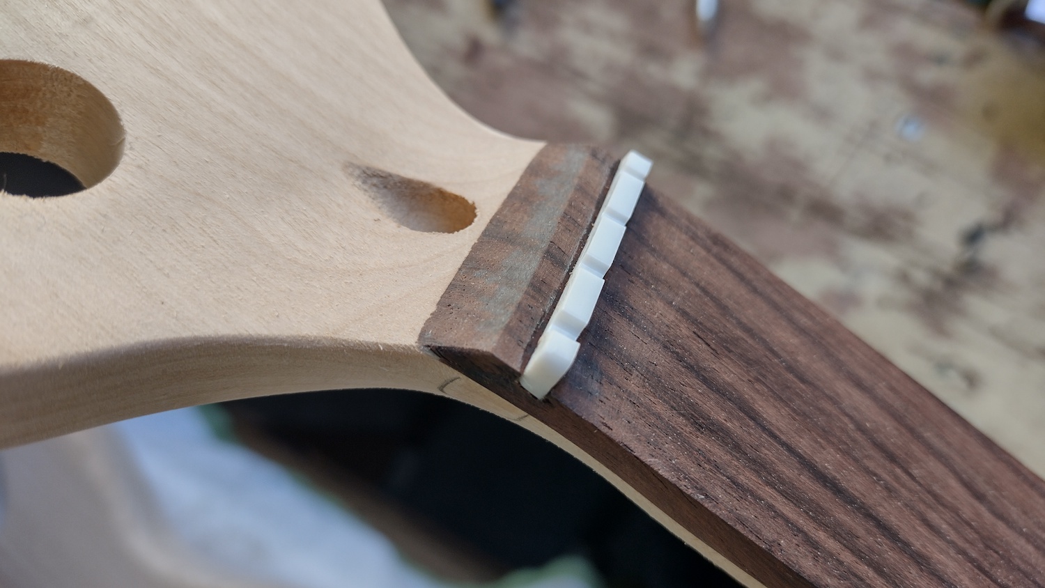

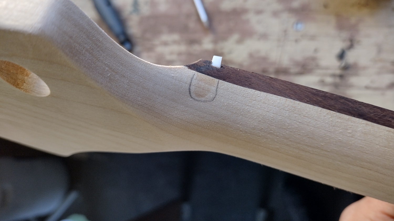

    Q#1 it appears that there's a glue spot on the side of the fretboard, and some excess glue next to the plastic nut, towards the machine heads.
    How do I get rid of the glue spot on the side of the fretboard? (assuming that it is a glue spot...) just sanding?
    Same thing for the glue excess on the fretboard, sanding? I am swapping the plastic nut for a bone nut on this neck, so that whole thing has to go very soon.
    Photos below.

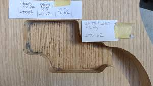

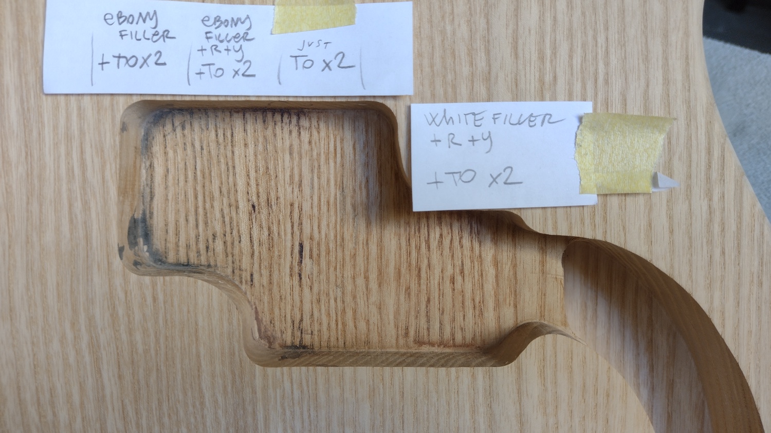

    I am totally new to ash bodies, I am doing some testing inside the pickup cavity since it will be covered by copper tape anyway.
    How do I made the grain to appear more even? as you can see from the photo below, the grain filler looks "interrupted" here and there, especially on the darker options.
    I have sanded to 220 (sanding #1), and then applied some diluted Timbermate (TM) filler.
    My tests from left to right are:
    Ebony TM.
    Ebony TM plus some mixed red and yellow acrylic paint.
    Just Tru Oli (TO).
    White TM plus a pinch of mixed red and yellow acrylic paint (probably my favourite but I think it'll depend on if I use rosewood or maple neck, TBA).
    Then I sanded again 220 (sanding #2) and applied 2x coats of TO on every sample.
    Should I have re applied some filler again after that second sanding? and then sand again (#3) and then go with TO? or keep applying TM and sand until the desired grain fill is reached?
    Photo below
Name:	01_filler tests 2021-10-06 13.16.17.jpg

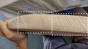

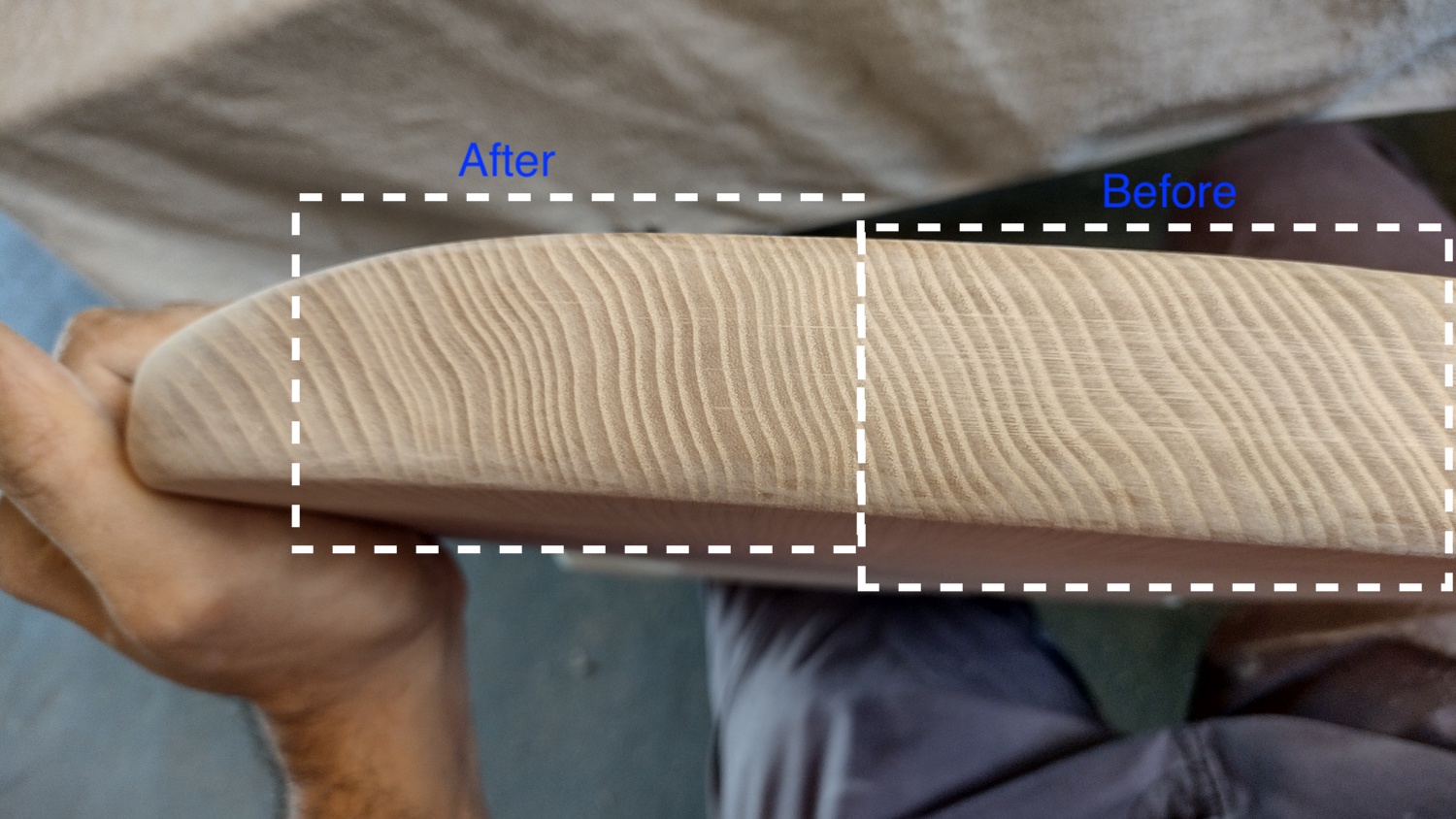

    On the side of the body, almost around the entire body, there where some scratches, I'd imagine from when the body was cut.
    The scratches are going away with some 180 sanding as you can see from the photo below.
    I tried sanding with some 120 I have hanging around, but the scratches seemed to get worse? I am not sure if I was getting paranoid or what, but the 180 is definitely working very well and I am almost finished with the sanding.

    "How do I get rid of the glue spot on the side of the fretboard? (assuming that it is a glue spot...) just sanding?"
    Yes, I would give sanding a go. (240 g or 400g !)
    "How do I made the grain to appear more even?" "Should I have re applied some filler again after that second sanding? and then sand again (#3) and then go with TO? or keep applying TM and sand until the desired grain fill is reached?"
    I think I would give the timbermate another go (or two). When sanding I would use a sanding block (a bit hard to do in the pup cavity) - maybe the sanding in the cavity has pulled the timbermate out of the grain. If you are not staining maybe sand the timbermate off with 400 g .
    On my TLA-1 I only gave it one coat - but probably should have tried two.
    "I tried sanding with some 120 I have hanging around, but the scratches seemed to get worse? I am not sure if I was getting paranoid or what, but the 180 is definitely working very well and I am almost finished with the sanding."
    I would sand the sides with 220 g (or higher - 400 g!). You definitely should be finishing higher than 120. I find I can use a higher grit on the sides to get rid of scratch marks.

    Sounds like you've got it sorted already, but I'll put a couple things out there anyway...
    With the grain filler, I think it would be difficult to get an accurate feel for the application process in a small recessed area like a pickup cavity. Typically we're working on larger, flatter, more accessible areas like the front and back of a body. I will also add that the process generally (IME) takes a bare minimum of 2 applications, if not 3 to 4 to achieve a good level surface. I should say that this is my experience with Timbermate. There are heaps of other products now that I haven't used.
    Now I know you're not going for that glass-like finish, but I think my point is still relevant in that saying a single application is not going get into every dip in the grain first go, so an uneven appearance is likely.
    As for the scratches on the end grain...
    For large or deep scratches, I hit it first with an electric RO sander (random orbital) to get the majority of them out. Then switch to hand sanding, and progressively going through finer grits. Something I learnt only a while ago, is go one grade finer on the end grain than what was used on the flat grain. This is more relevant for natural finishes than if painting.
    Another tip is only sand the end grain in one direction, not back & forth. In the case of your bass body, I would sand from the join in the middle, down in the direction of the bottom edge. Then the same for the top half - middle to outer edge (downward if you flip the body - I find sanding down easier than sanding up - but may just be me). A "strip sanding" technique works well for this. Especially inside the horns.
