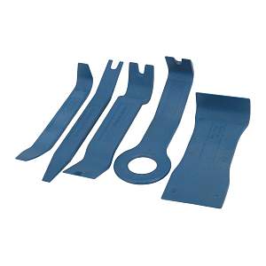

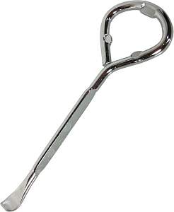

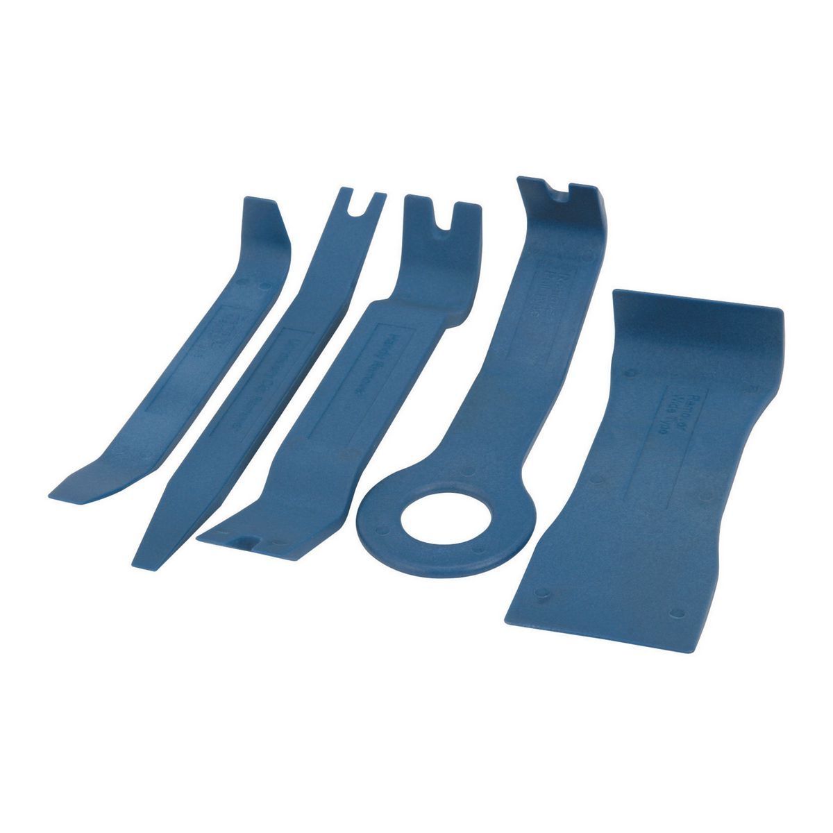

    What worked for me was to get one of these paint can openers.
    I had to file the sides of the hook down a bit to get the hook to go through the center hole of the ferrule. Once I got the hook under the ferrule I could slowly work the ferrule up a bit. I also used auto interior panel removal tools to pry up the sides without damaging the finish. But mostly I just used the paint can opener.
    To do it without damaging anything, I found to be a rather slow process.
