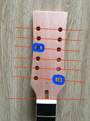

    3. And last but not least, I noticed the holes for the tuners are not symmetrical or aligned. I know this doesn't have a functional implication, but it still bothers me from an aesthetic perspective.
    I would really appreciate your wisdom and advice about the above. Does it warrant reaching out to PitBull again? Or are these issues expected from these kits and I should try to address them the best I can?

    If you've been on the forum for a while, you'll know that the headstock tuner holes are rarely perfectly aligned. Sometimes you can live with them, and sometimes people plug them and redrill them. You'd probably only have to plug two holes to get the holes relatively level to one another e.g.
    Top one down slightly, bottom one up a bit.
    The new holes shouldn't be too far off centre from the old ones, so that the tuner washers will cover the work on the headstock face. The tuner bodies themselves should cover the work on the rear. Easy to check. If not, then you can always stick a piece of veneer on the headstock to patch things up.
