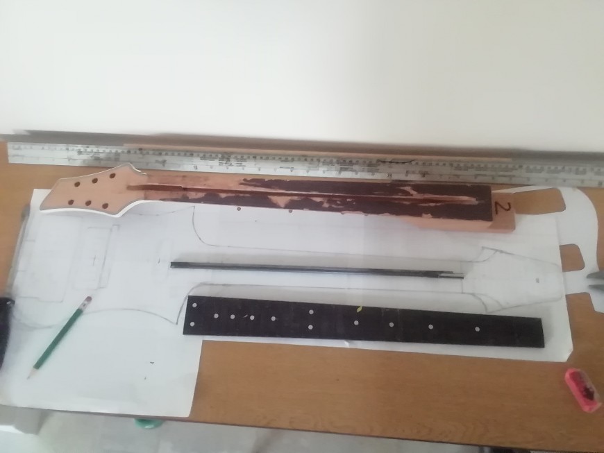

    The starting point for this is a warped Pitbull neck (thank you Simon), but the only thing I envisage saving from it is the truss rod!

    one of those "Well I have this stuff, now what can I do with it" projects. I have seen attempted fixes like this on the internet. How do you plan to procede? my temptation would be to try to sand the top flat.
    You're right and wrong... It is a "I have this stuff" project, but not for the neck. As Simon says the neck is being scrapped, and I'll use the fretboard as a template for the fret slots on the new board. I appear to be hopeless at really accurate cutting, so hopefully that will be a solution.

    It's meant to be a donor for the truss rod so Jim can make his own neck. The neck was quite twisted. The engineered 'rosewood' fretboard is just being used to mark off the spacing for a new fretboard. Jim pulled out the frets on the engineered board and it's not pretty. OK, he was quite rough with it and this isn't the best quality picture, but you can see that even with a bit more care, re-fretting an engineered board probably isn't going to work.
    I've done a couple of them with no problems so far.
    Not the best material to work with but it can be done.
    cheers, Mark.
    cheers, Mark.
    I think it may come down to the individual boards. Lack of consistency in manufacture means that some will be good, some not so good.

    Yes, I imagine with skill, care and experience it's possible, most especially if it's one of the better boards or the surface has been stabilised with something. I supplied none of those three!
    An interesting thing, when I took off the fingerboard, was that it was very hard to remove cleanly because the board was much more solid on the glue join than it was immediately above. So I tended to break through the board just above this layer rather than on the join. I suppose my heated knife was weakening the matrix between the fibres. My guess is I the stronger layer was down to the glue penetrating the fibres. Of course I couldn't really see what was happening until I had the board right off. !Skill, !care and !experience again!
