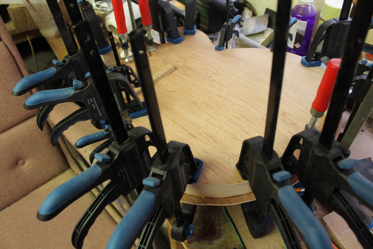

    Time for a quick update.
    I have glued the 2 center blocks together and glued the rear block in place. the sides have been glued to the center block and the kerfing fitted and sanded to profile.
    I had cut the bottom plywood skin but on doing a test clamp of the top and bottom I found a mistake. The bottom was a fraction too small. It would probably have been OK as I will need to rout it anyway for the binding but I decided to cut a new one.
    I have now done the test clamp and it all meets where it should.
    It needed a lot more sanding to get a good mating surface with the kerfing though.
    No photos today but I will take a few tomorrow as I glue the bottom on,
    Just the bottom gets glued as this then gives me the chance of cleaning up any glue mess that could be visible through the F holes.

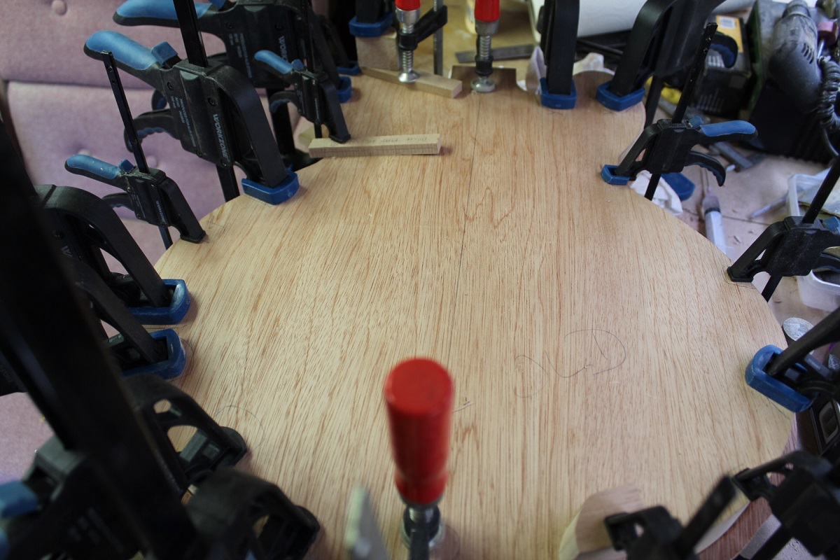

    Todays progress.
    I have glued the bottom on!
    Not sure that gluing one side at a time was a good idea though.
    When I take the clamps off, the back may try to revert to its original shape ..... FLAT!
    We will see.
    Glue line looks good but there will be a fair amount of cleanup required although the joint line itself gets routed for the binding.
    Here are the photos.
