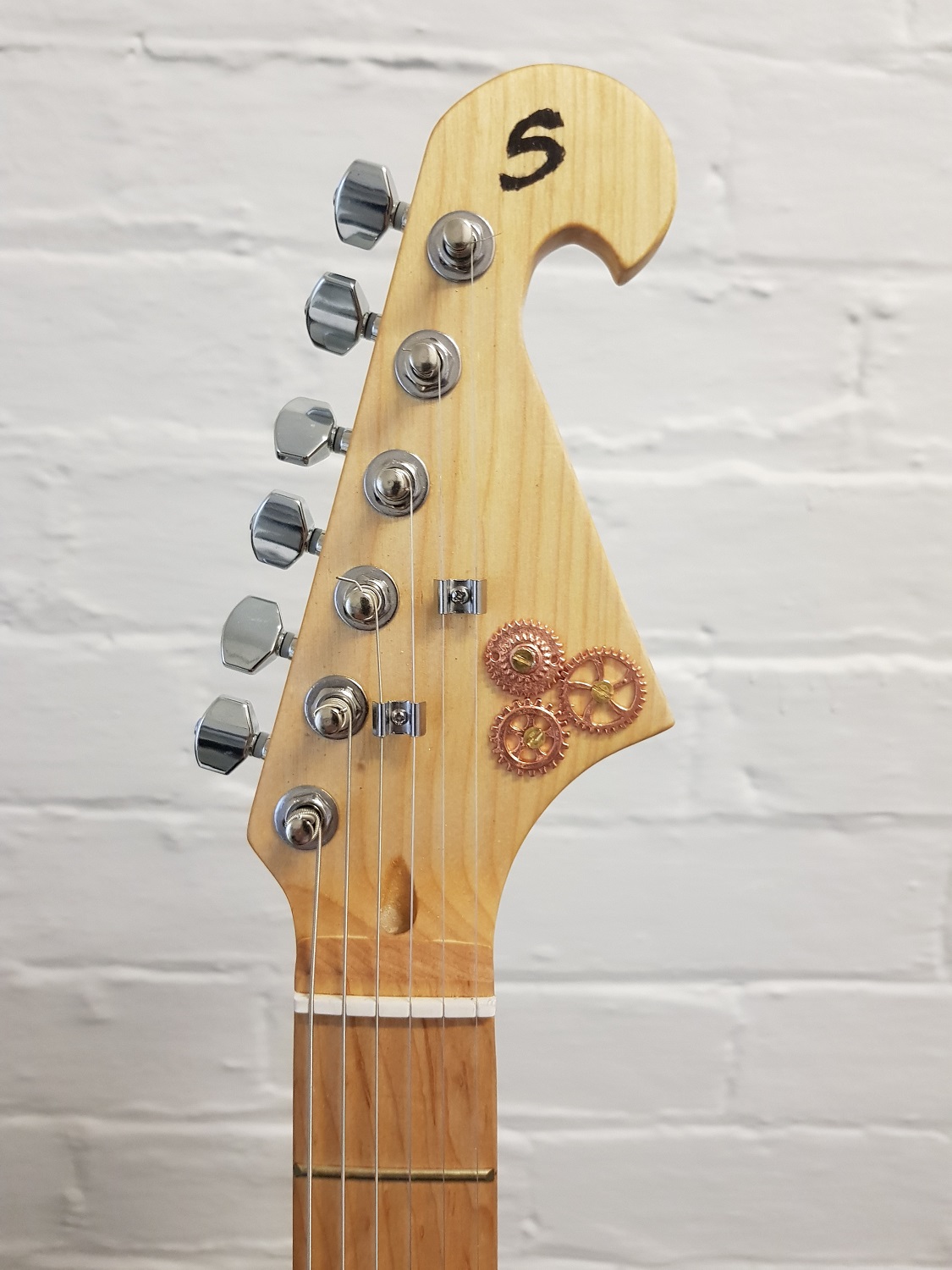

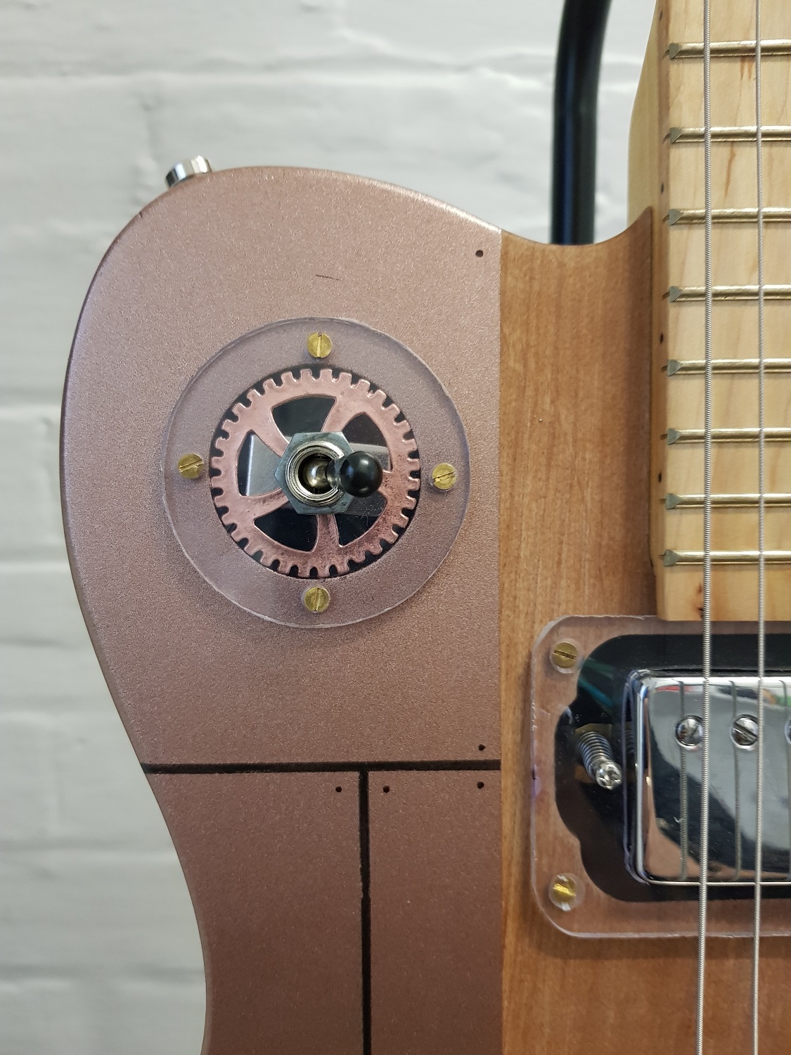

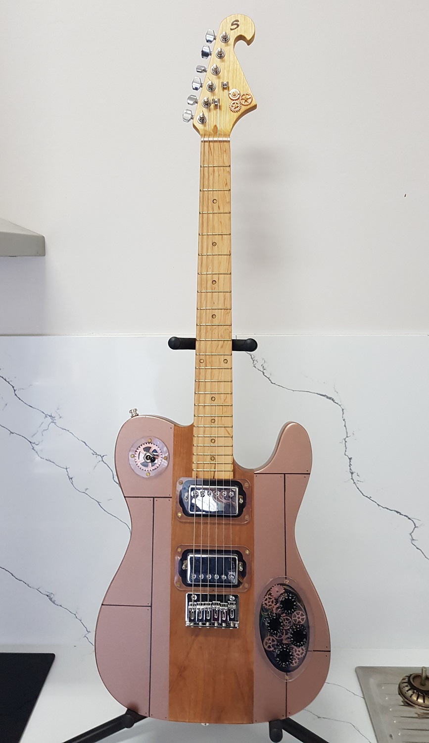

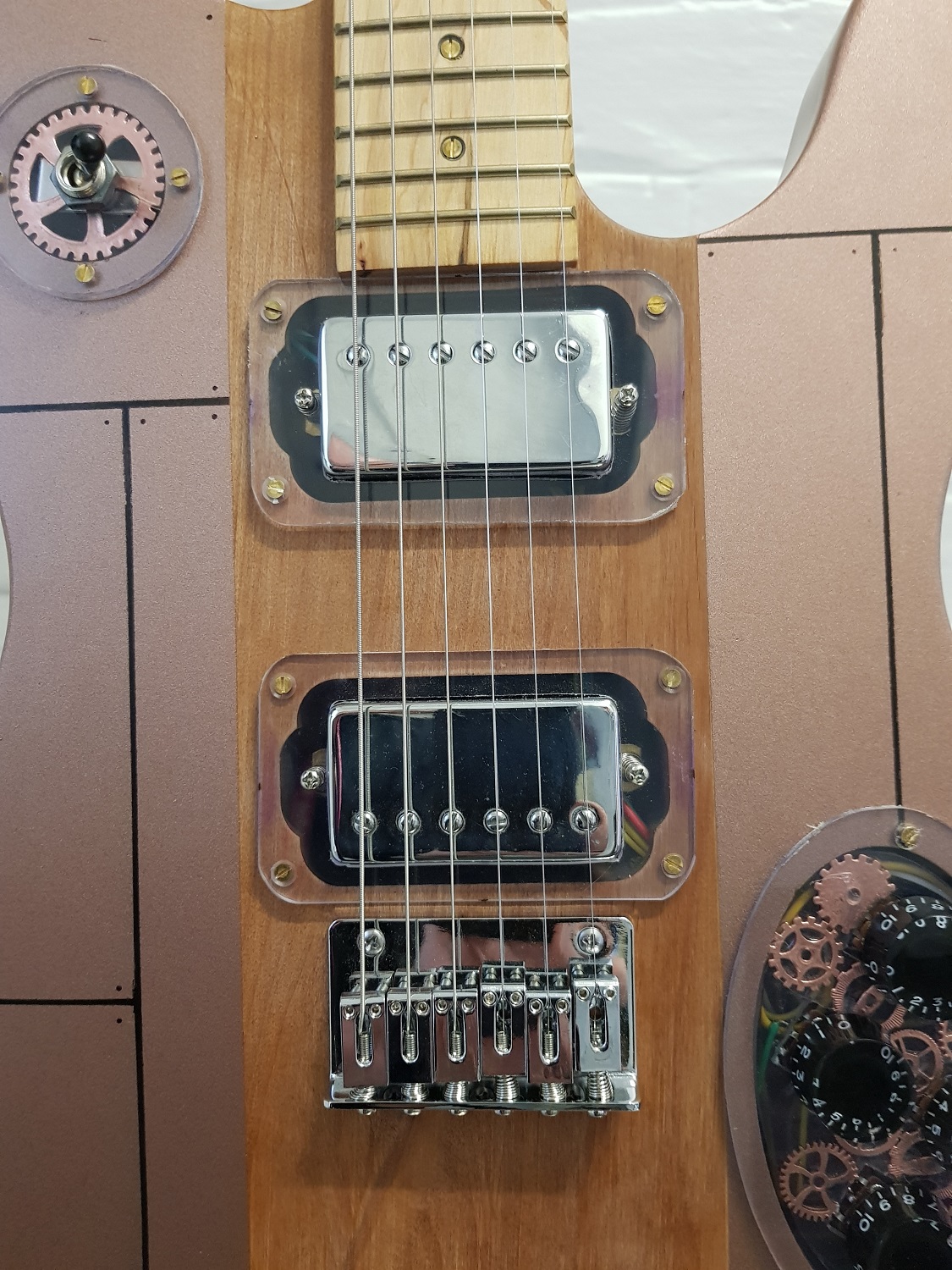

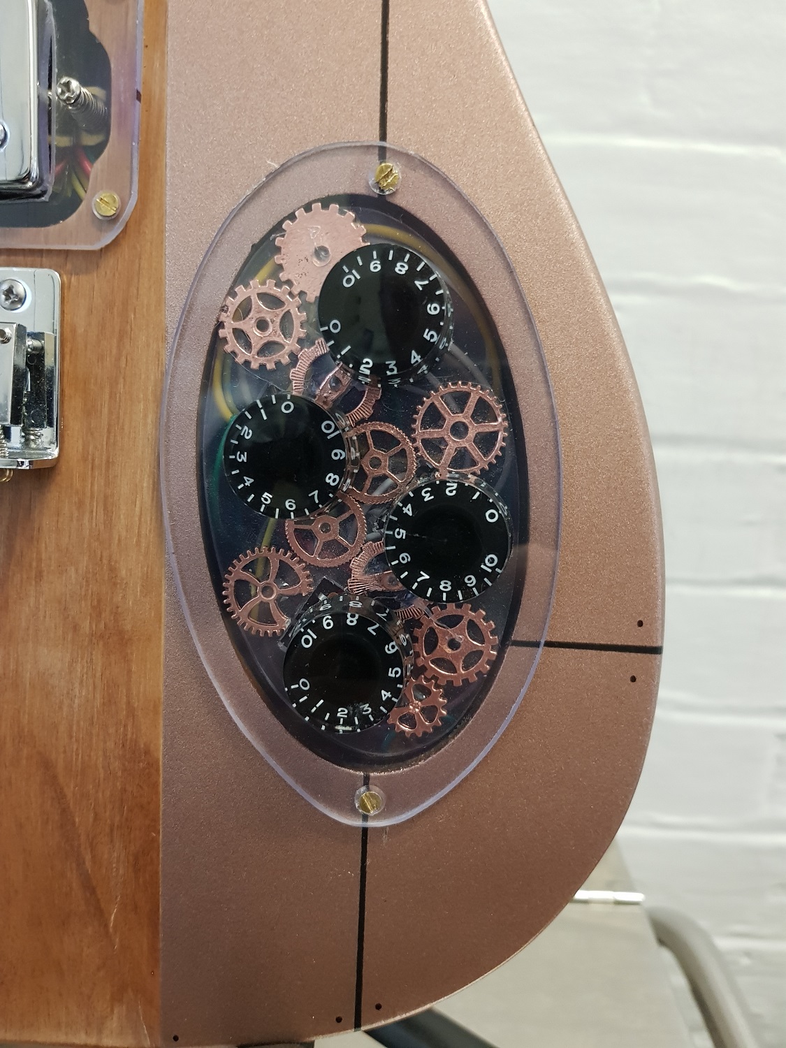

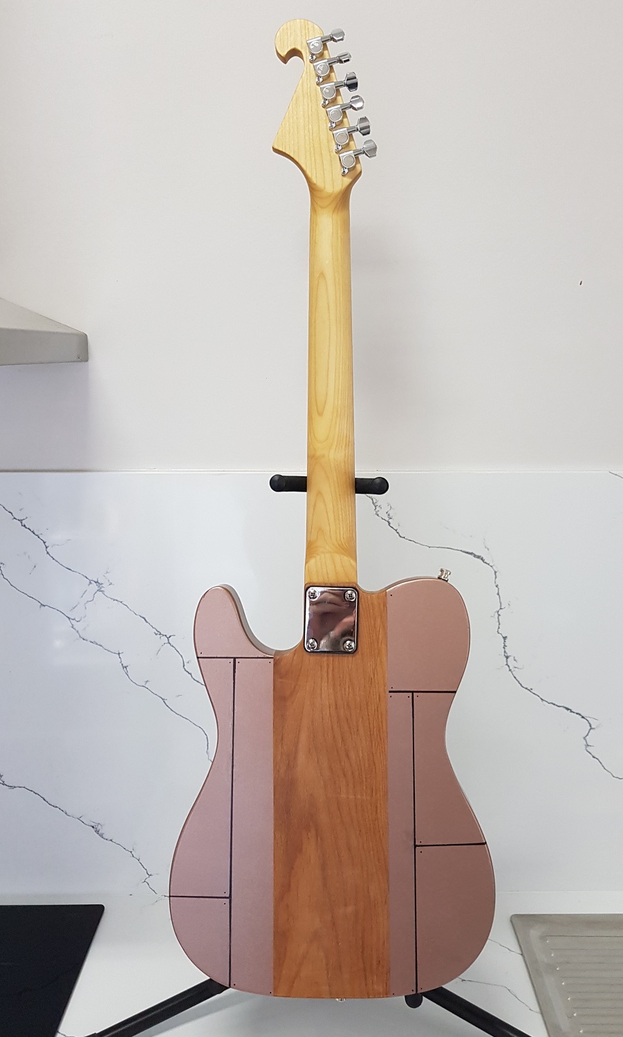

    Steampunk TL-1HA
    Hey Fellow Guitar builders! Here is one that has been at least 12 months in the making. I bought it from Pitbull just as the Covid-19 lockdowns started. Due to restrictions and other issues didn't get round to finishing it until just recently. I like the design but wasn't really enamored with the scratch plate, which threw me into a new direction design wise. I originally had the selector switch cover and tone/volume pot covers cut out from some alloy checker plate....but changed my mind when I got some of the copper cogs for a different project. Well the end product speaks for itself I reckon. As far as the hardware on it, it is all stock standard kit hardware. The only changes were changing the Strap buttons to Strap lock ones and changing most of the mounting screws to brass flathead screws to keep the theme going which I actually used in the fret dots after drilling them out. Which I had to shorten the screws because of the lack of depth they could go. The metallic copper spray was applied to two thirds of the guitar and then I airbrushed the line work on it to give the appearance of Copper plating. The rest of the body and neck had copious amounts of Tung oil applied for protection.
