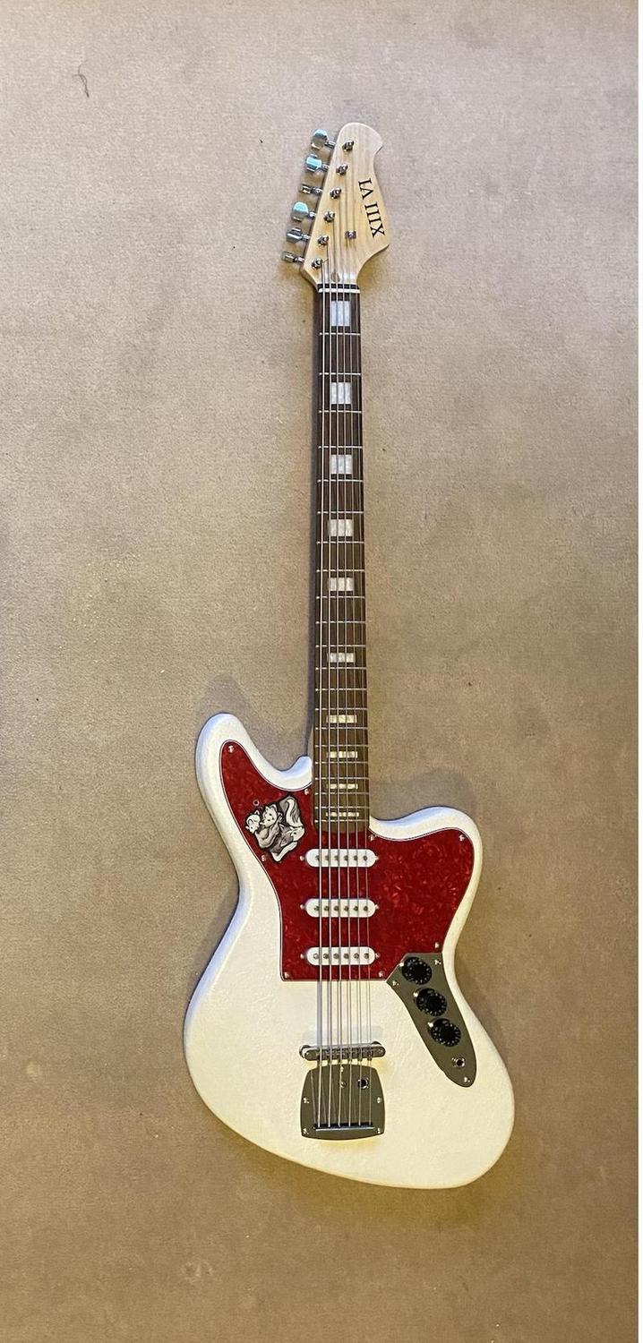

  10. #59
    Well, while I wait for the knobs (as well as new pots, cap, jack, and wiring)... this is the "finished" product.
    It plays as well or better that my Squier.
    Thanks to Simon and everyone else that chimed in on this thread to help get me here

  11. #60
    Interesting build. Looks great.
