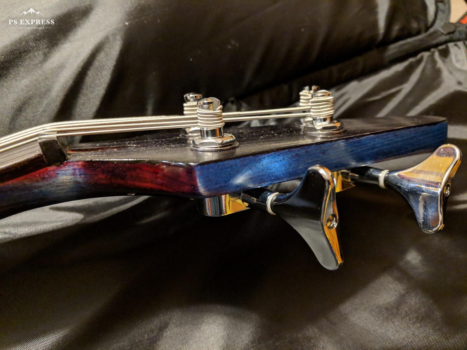

    For the finish, I am using Keda wood dye (www.kedadyeinc.com). It's a powdered dye, I'm using an isopropyl alcohol/distilled water mixture.
    I'm testing on a few woods, as the mahogany of the body is much lighter in tone than any of the pieces I have been able to get my hands on.
    Red:
    Blue:
    Once dyed, I will use a water-based grain filler (AquaCoat) so I will be able to get a smooth finish.
    I haven't been able to locate any polymerized tung oil - which would be my first choice - because I can't get it shipped to my state. I will be testing tung oil finish (not pure tung oil), Tru oil and Danish oil. Will post pics when those tests are complete. Unfortunately, it is -6°F/-21ºC today, so that's going to be delayed a bit.

    Hi VPB, what's your ratio water to isoprop ? And what are the benefits of using this mix over straight water or isoprop? Cheers! Great looking build by the way =)
    Member VandoPlaysBass's Avatar
    Jan 2019
    Connecticut, USA
    10
    Quote Originally Posted by Bakersdozen View Post
    1 Tbsp warm distilled water with 1/4 tsp dye to dissolve more efficiently. Then 1/2 cup 70% isopropyl alcohol. It dries quickly and sets well. Worked like a charm. I used 1500 wet dry for the slurry. That worked like a dream.

    And the winner is... Red dye with Tung oil finish.
    Next up: working through the body issues. I discovered the stock pickups are somewhat unique and I can't seem to find any after market pups that fit in the cavities without adding a pickguard. If anyone has any suggestions, I would greatly appreciate them. Or let me know if I'm nuts because the stock pups are actually good.
