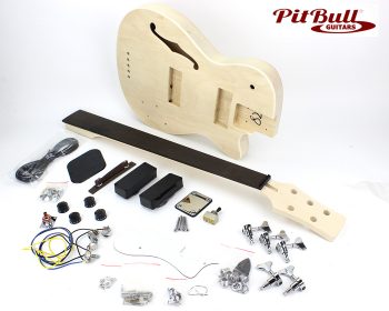

    This kit looks really interesting...challenging and yet avoiding some of the issues noted on other hollow body kits.
    https://www.pitbullguitars.com/shop/...ss-guitar-kit/

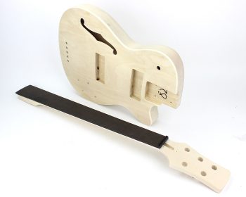

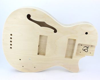

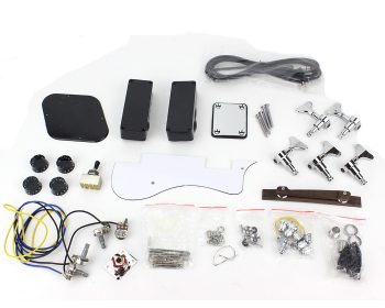

    Planing shall begin. The HBB-5 has string through body with ferrules top and bottom....nice. The photos show a rosewood, or similar, bridge....but no insert in the bridge...unless it is in one of the plastic bags.
    Question 1:-
    How do you use just a stick of rosewood as a bridge on a five string bass? All that thick string pressure concerns me.

    Big one is the Bridge for me. What do I do with this? Is timber strong enough for this application? Internet searching is required.
    The three position toggle switch? Are they good enough from the kit?

    Semi hollow body. Bolt on neck. Control cavity on back....less fishing electrics through the F hole required. The bridge is not a three point style used on other kits...that allegedly have a propensity to pull out from the body of the Bass guitar.

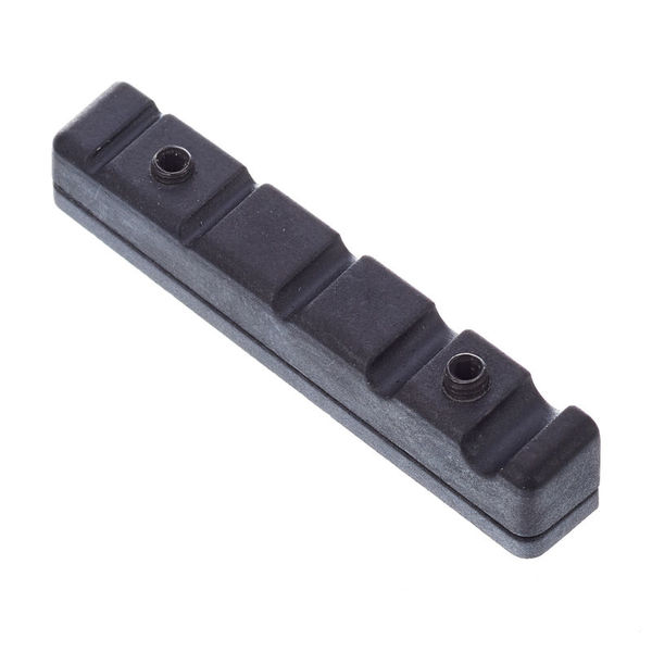

    7. Stock Humbuckers are not bad and have plenty of grunt with 7.97k on one coil and 8.01k across the other coil which means once split they still have enough oomph. You can spend plenty on soap bar upgrades for not much extra benefit. I used Bensons in the EX-5 and they have plenty of MM warmth and alternatives were either Bartolini or EMG passives. If budget is an issue suggest trying stock units to begin with as that will save at least $200 - $250 up-front.
    8. I used one of these on my EX-5 and it is a ripper, fantastic idea.... Aussies seller doesn't have any available but this UK site does and price seems reasonable https://www.thomann.de/gb/warwick_ju...ring_45_mm.htm

    Waz...those two options....adjustable nut and good quality three way switch....are great ideas. Thank you. 😎

    I wouldn't worry too much about the wooden bridge. A web search shows quite a few basses with them, and of course a double bass has a wooden bridge. You've got a solid wooden centre block to take the downwards pressure. Plus you don't need to worry about drilling bridge location holes.
    You could pin the bridge if you find it moving about, though if you change string gauge (or even make), you'll probably need to relocate the bridge to get the intonation correct again, so I'd only do it (or glue it) if it was a real nuisance for you.
    The pickups seem to be of one of the standard soapbar sizes, probably 1.5" x 4.5" rather than 1.5" x 3.5", so retrofitting alternatives should be pretty easy to do.
    I'd certainly replace the selector switch for one like Waz recommends. The kit ones work for a bit but can easily go short circuit to ground. I've had two identical switches to the kit ones fail on two Vintage (the brand) Les Paul copies, and both have shorted the signal directly to ground. Get a short switch, not a long one (as you normally get on a Les Paul), as you won't have the depth to get a long one turned round and poked through the hole in the body. Luckily that's the only control that's awkward to install. I'd be tempted to get some 3 or 4-core shielded cable to run the distance from the control cavity to the switch location, as it's quite a long run. Plus you only have to get one cable through the holes from the control cavity up to the switch position (and I have no idea what that route is from the kit photos).

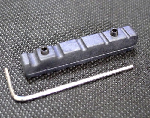

    Hi Ozzie, as promised I have copied in below some links for the expensive and not so expensive 5 string adjust a nut. Not sure of the quality for the Hong Kong based supplier but at that price it could be ok?
    https://www.ebay.com/b/Warwick-Guita...76/bn_25160720
    https://www.ebay.com/itm/Warwick-Jus...QAAOSwjVVV03WY
    https://www.ebay.com.au/itm/String-B...8AAOSwjSJadgVC
Name:	Adjust a nut.jpg
    Cheers, Waz
    I am ordering one of the cheapie 4 string versions and will let you know what i think once it arrives.

    Turned out to be some long winded poly something material (plastic). The German ones are similar plus reinforced with fibreglass.
