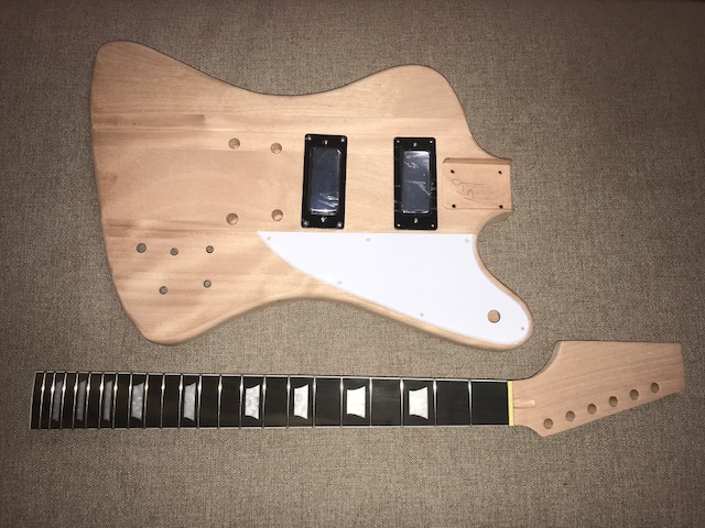

    GAS has struck!
    I received a FBM-1 yesterday (with a TB-4 put away as a Christmas present). My plan is to try a dark vintage type burst using FW stains (jarrah and black). Not sure if I will try the FW wipe on poly or stick with Tru-oil. The body looks good and the neck fits well. Spent a bit of time sanding - good times.

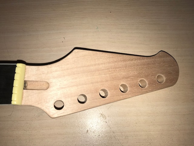

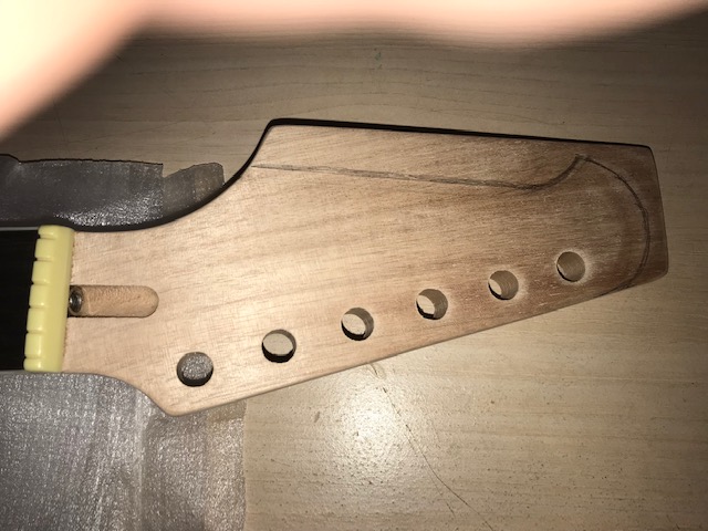

    2,025
    Cut out and sanded the head stock. Will try a burst on some scrap wood next.

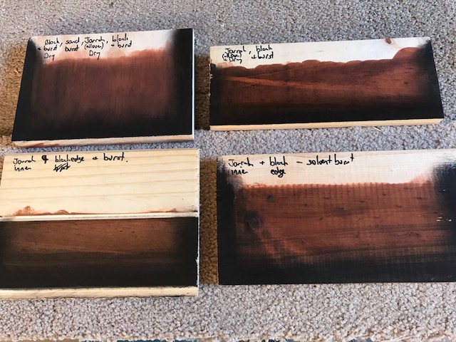

    2,025
    I have tried some practice bursts using FW jarrah and black stains. All done using slightly different techniques. They all turned out OK. I just hope I can replicate this on the guitar body!

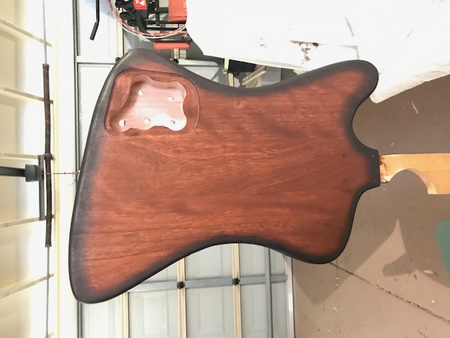

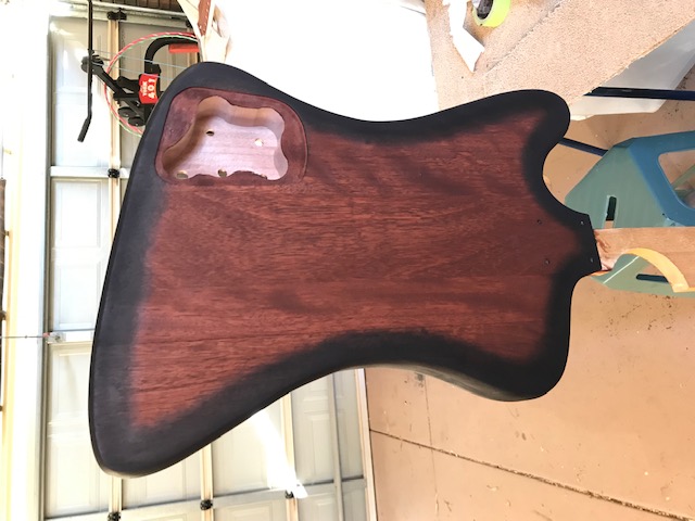

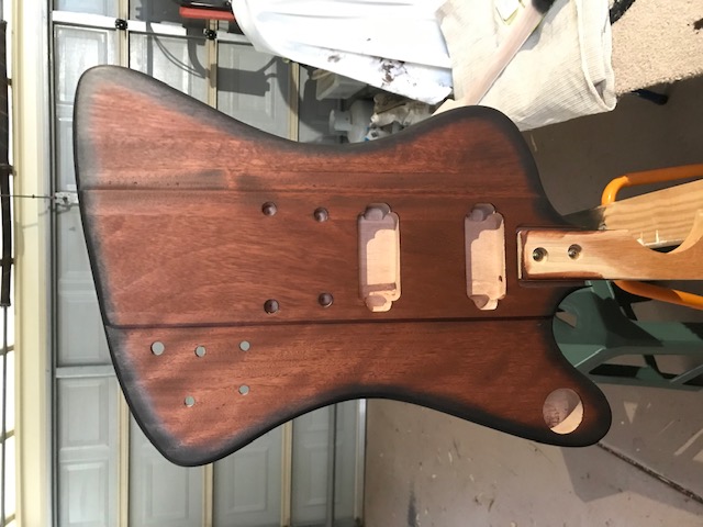

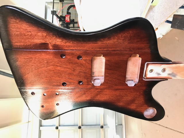

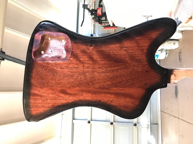

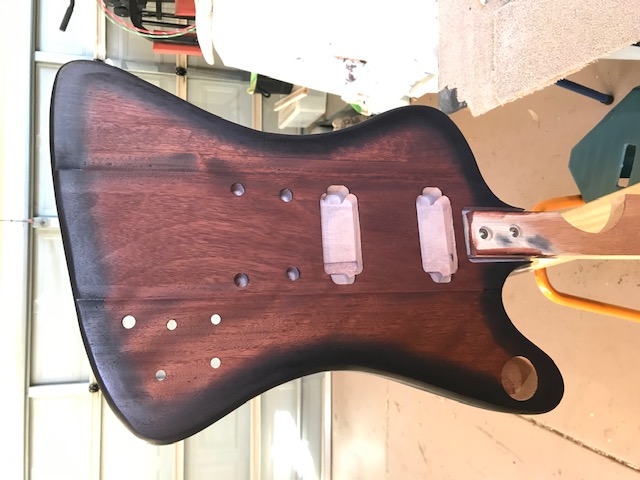

    2,025
    Tried my FW black and jarrah burst. First coated the body in jarrah stain, then did a thin black burst, then a thicker black burst.
    The pictures are showing the burst darker than reality!
ID:	37342   Click image for larger version.
ID:	37343   Click image for larger version.
ID:	37344   Click image for larger version.
ID:	37345   Click image for larger version.
    2,025
    Also got on a few coats of tru-oil.
ID:	37347   Click image for larger version.

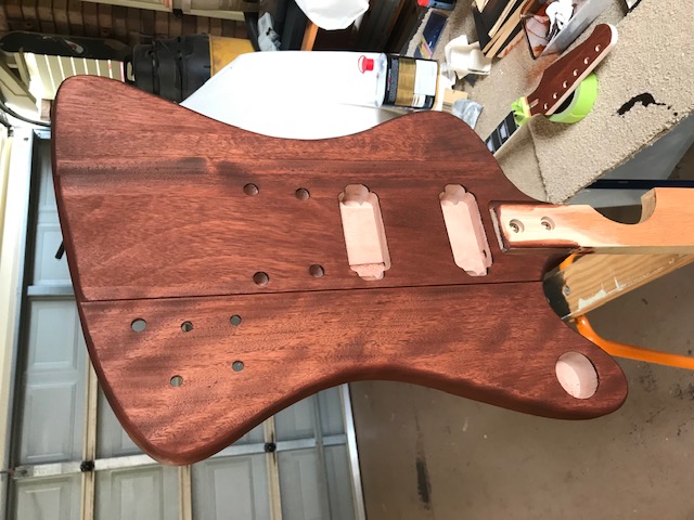

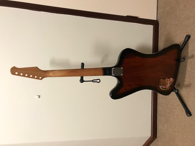

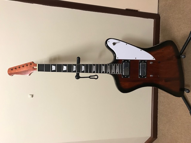

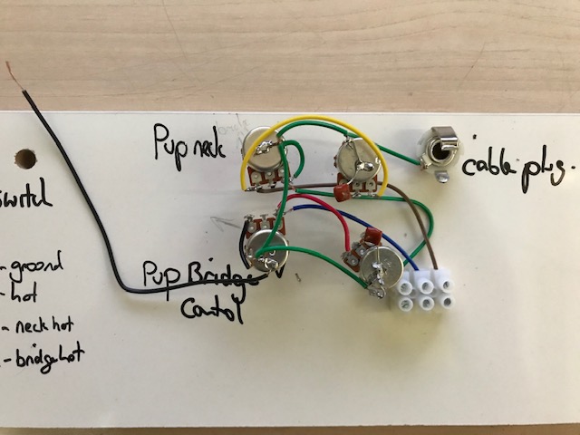

    2,025
    Between a few more coats of tru-oil (15 in total) on the body and neck I have done the soldering.
    The electronics cavity in the FBM-1 is quite small. Also the long wires from the switch cavity back to the electronic is only just long enough!
    Straightened the neck, then used a 12 inch radius block and levelled the frets using the technique in the build manual.
    Put on the neck, pick guard and pickups.
    Next I will put in all the electronics.
