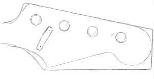

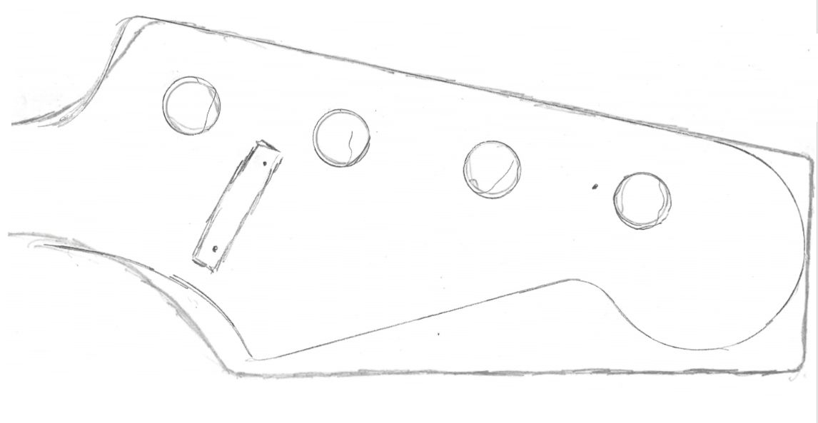

    Not having those particular skills...I did some tracings on paper and scanned them.
    I traced the PB paddle, and then traced a Kmise "Fender" bass headstock. Then I superimposed one over the other...
    Not as precise as what Rabbit suggests, but perhaps it's close enough for Jazz...or a Precision.
    You could resize the jpg so that a printout fits your paddle. Alternatively, if you PM me, I can send you a PDF which I *think* is to scale. Or I can send you the Libre Office Draw file that I created the image with.
