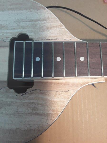

    I do have a question and hopefully the photos attach to seek advise, the neck is an extremely tight fit and I can only put the neck in about 1 inch but it is pressed and i think if i push it further it would split the body. Is this tight a fit normal ?? I assume i only sand the sides in order to remove enough material for it to slide in is this correct ?

    Oh wow...you have the neck into the body way too far. A pickup needs to go into that cut out perpendicular to the neck pocket. Be careful jamming it in that far.

    I know it doesnt go there it is only there to show how it doesnt fit, due to being so tight in the body.

    Not sure how long you have had the kit but it is best to give a bit of time for the wood to adjust to your climate. There might be some residual moisture swelling the timber.
    You might need to carefully sand it a bit to get a nice fit. Better to start with it a bit tight rather than too loose.
    Nice looking kit.
    I second the waiting period. It doesn't take much for the wood to swell up due to temperature and humidity changes (it's spent weeks on a container ship and then travelled over 2000 miles across Australia to you), and you'll have a better idea where things are after a week or so. Please don't start sanding anything yet, as it is very common for the timber to shrink a bit after transit. Sand now, and you could end up with a very loose fit when you eventually come to glue the neck in.

    Thanks for the replys, i havent thought about the temp / humidity issue, i will leave sanding the neck fit until i am at that stage of fitting it.

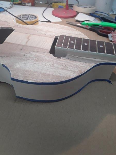

    I have an issue with staining, i had taped the binding up but the stain bleed through. I have tried acetone, mineral turps and goo remover none of which did anything other than the acetone starting to melt the plastic.
    Any suggestions on how to remove the stains ?
