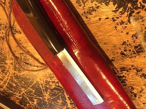

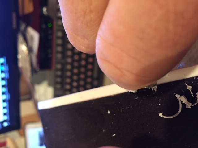

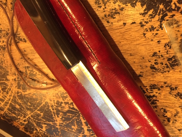

    Simon helped me a lot my first time through - thanks Simon. I would add that a Reed Knife (oboe, bassoon, available at any woodwind supplier) is THE solution for binding scraping. You can hold it firmly by the blade and it won't cut you, yet it is sharp as F***. Attached are 2 pics. Click image for larger version.
ID:	32816Click image for larger version.
    Nov 2019
    Essex United Kingdom
    83
    Agus, who would have thought to use one of those ?
    Thank you for your input.
    Looks like Simon has a lot of knowledge.
    Wish I still lived in Reading, a beer would have been in order !
    @fatboy, I've played saxophone since I was in single digits. To keep my scholarship at university I got put on oboe for a year and a half. I was also a piano major and there was a bit of a turf war you might say... and double reeds became my punishment. Anyway, you make your own oboe, bassoon & english horn reeds because they are $$$$$$ and half the time the store-bought sucks.
    - first time I was scraping a binding with a razor knife, I thought "Wait - this seems familiar..." Dug it out of the closet. WELL WORTH THE INVESTMENT FELLOW BUILDERS! No cuts in my fingers ever.
