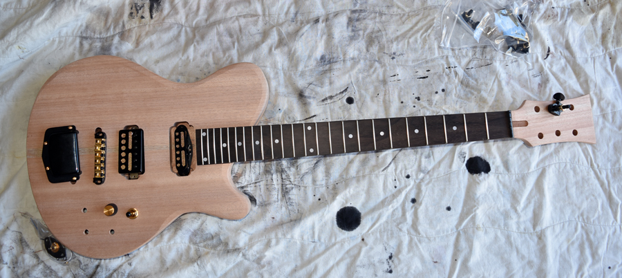

    my custom kits are still a few months away and I hate to waste this good building weather so.....
    Plans are as per the picture. Gold Foil pick ups, humbucker at the bridge single at the neck. Teisco tail peice, roller bridge because it was cheap to buy two and mash them to get the black and gold. Tuners are mini Grovers but with gold kit nuts and screws.Humbucker will be split on the volume knob. Waiting for some more black and gold Marshal amp knobs to arrive. I need to design a pick guard or mounting ring for the neck pick up and decide on a headstock shape. Colour will be blue aniline wood dye on the front and head stock with a black burst, all black on the back, probably a walnut stained neck.

    You can also take the top bit (that you turn) off the tuners and swap the gold kit bits on there if you want. The spline/tang things all line up and it works fine.
    Sure this will be another classic
    I did try that Sonic, but it was too much gold, I just want slight traces. I have gold strings for it as well. I do like the Brian May gold 9's from Optima, have them on a few guitars now.

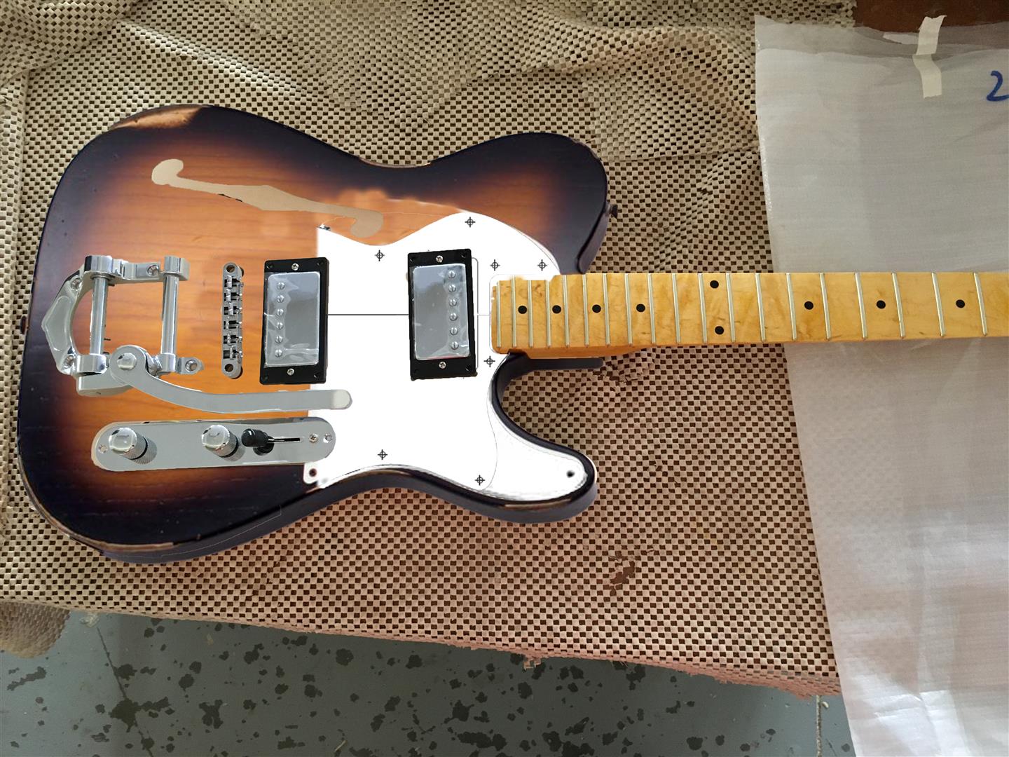

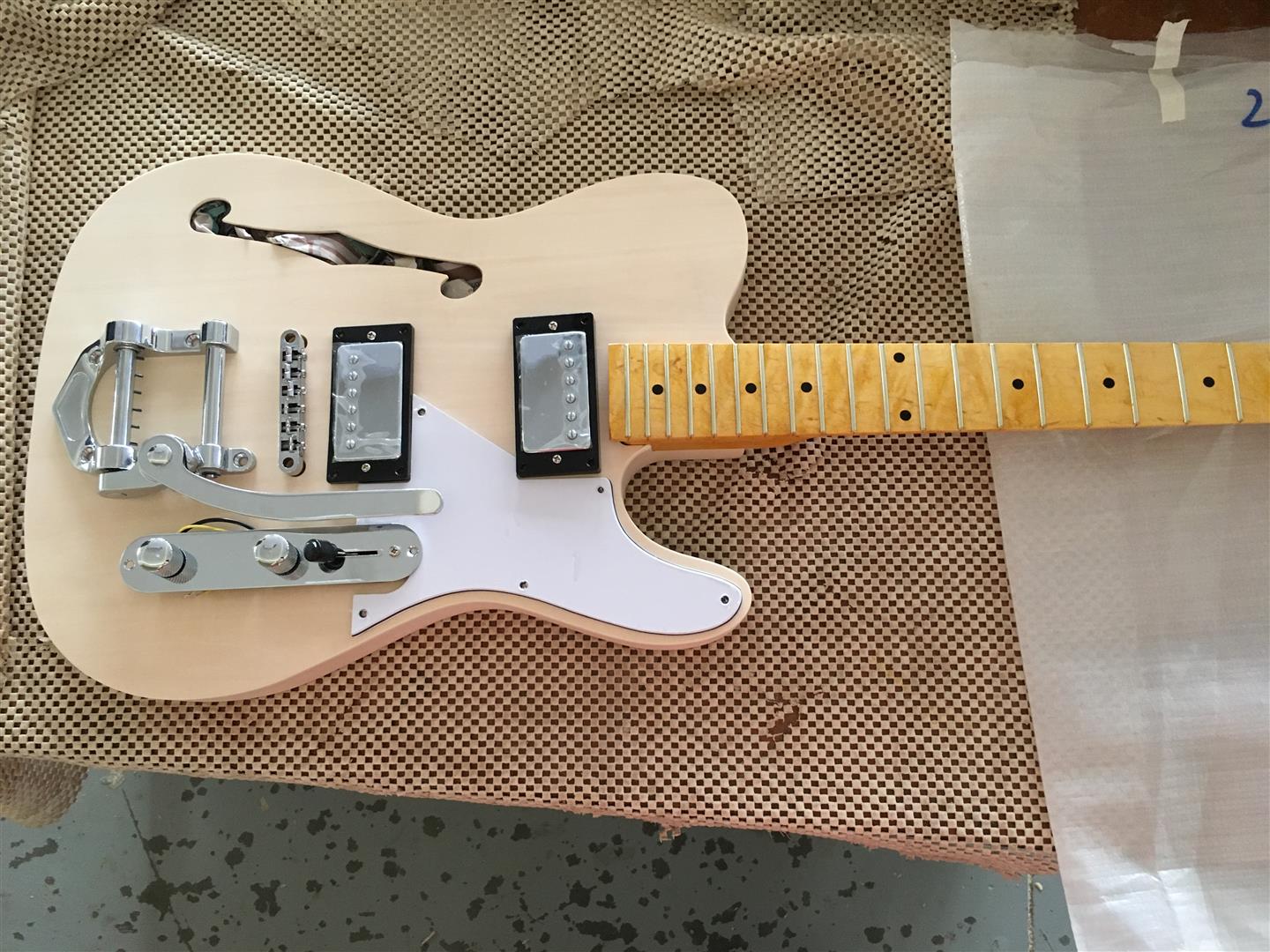

    Regarding pickguard,
    I recently did a photoshop mock-up for a customised shape tele pick guard.
Name:	IMG_2571 (Large).JPG
Name:	body photoshop mock up (Large).jpg
    This allows me to customise a pickguard which takes into various standard tele designs.
    If you want me to do some mock ups when you design your headstock and pick guard let me know.
