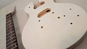

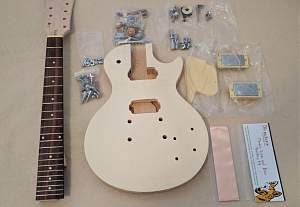

    First thing's first, this is the LP-style, ash body, 7-string guitar. I don't have a seven, nor can I really justify the price of a store-bought seven (due to me sucking when attempting to play one)... so here we go. In case you're not familiar with the kit, you can take a look at it HERE. To save you a click, we're talking a carved-top ash body with maple veneer (and cream binding), rock maple set neck (C profile) with rosewood fingerboard (22 medium jumbo frets and dot inlays), and all the other LP kit goodies. And yes, I know this will be a tricky build, as I plan on tuning this 7-string to B-standard, and it's only a 24.75" scale length neck. As add-ons to the kit, I purchased some of the DT copper shielding, and upgraded to a set of Grover 406C Mini Rotomatic locking tuners... which will hopefully help keep the fencing wire (that I'll need for tension at B) in tune, and keep the hum to a minimum (for when all the gain is added).

    I already think it's a pretty nice looking guitar...

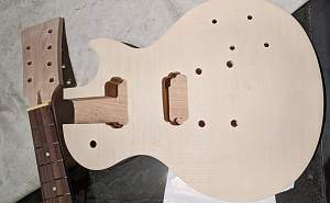

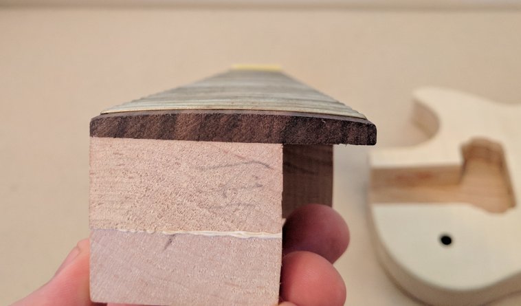

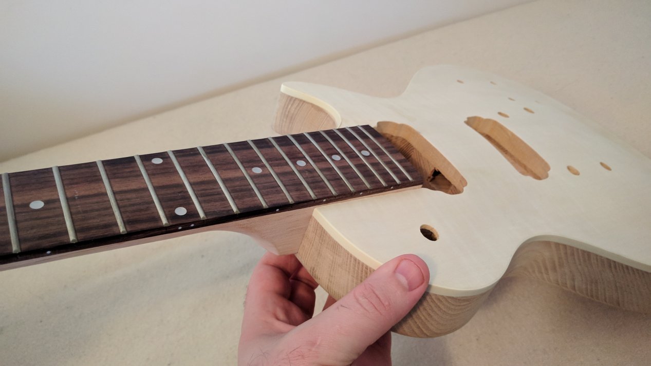

    But more impressive than looks, is how awesomely snug that neck pocket is, and how little work it seems to require at this stage. It might sit up at the back slightly, but I won't know until I do a full test-fit later. Why later? Well read on...
Name:	Step 0c - Neck joine seems nice.jpg

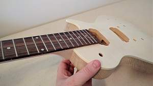

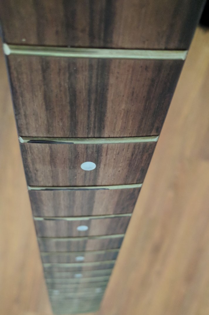

    However, now we get to the ARRRRGH moment. On initial inspection of the kit, while I'm super-happy with the rest so far, this neck looks like it is going to take some serious effort. I didn't realise the nut was going to be like it was (requiring re-setting, sanding/shaping, and filing), so I've hit up StewMac for some nut files. But more scary than that... is that the neck looks like it has a double-bow in it (almost like a twist), and the fret jobs is less than ideal. As such, I've ordered a Crimson Guitars fret kit, and will check everything with my notched fret straight-edge when it arrives. Hopefully some truss-rod tension adjustments, and maybe a fret level will fix all that: Fingers crossed. And yes, I also have a fret levelling beam, triangular file, and fret rubbers in the kit too... so I'll be learning that whole process for this project. Yay.
Name:	Step 0d - Neck bow and fret levels.jpg

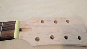

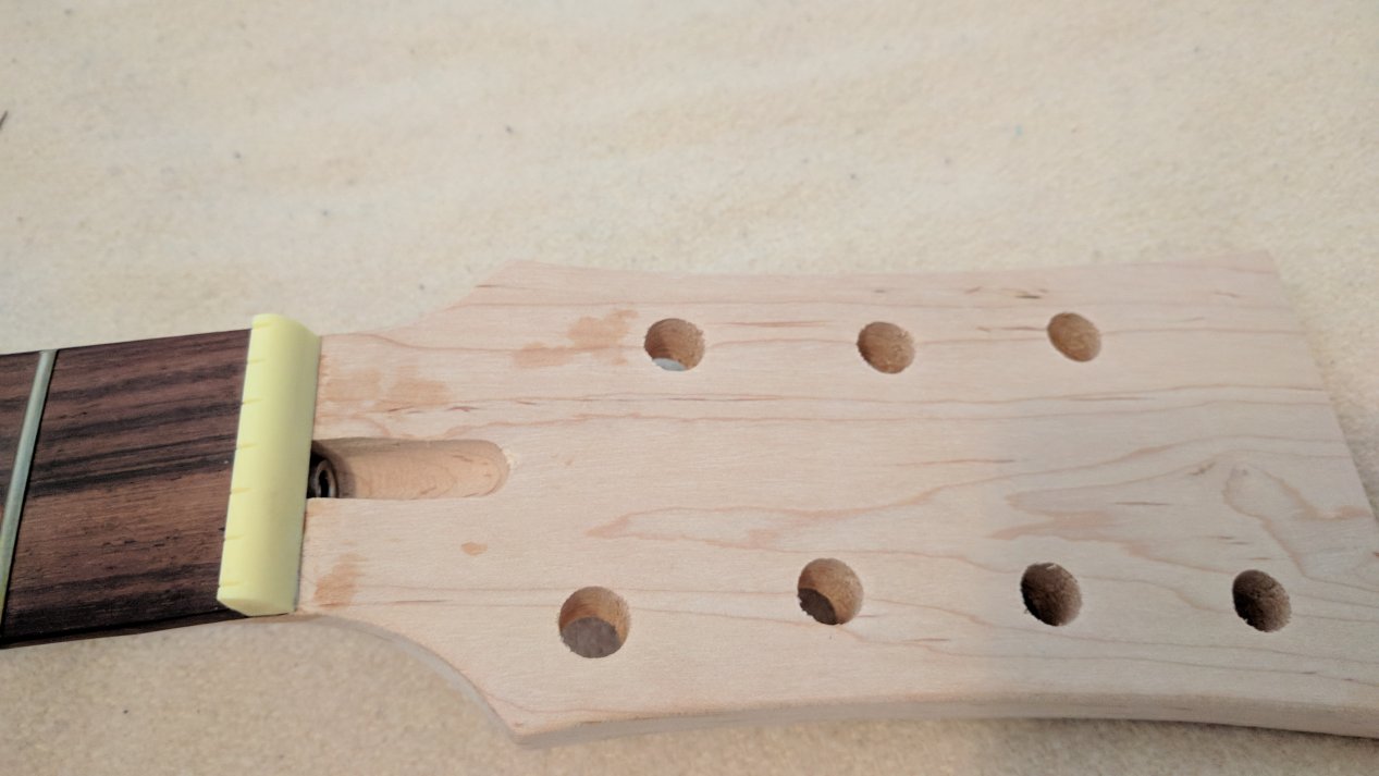

    While waiting for my tools to arrive, I've been coming up with headstock designs and a logo... though I will need to find a way to remove all this glue on the top of the headstock, as I was planning on staining that *sigh*...
Name:	Step 0e - Headstock glue & nut.jpg

    Yeah dude, Do all your neck and fret checks first.
    You may find that one or more frets are not seated properly and that may give the impression of a bow, or two.
    FrankenLab
    Your 'looking along the neck' picture doesn't look bad at all to me. Best to wait until you've got your notched ruler and can set the neck level and see how it is then. A fret dress can accommodate a very slightly twisted neck but anything more and you'd really need a new neck. However it doesn't seem bad to me, and I've had guitars with what appears to be more of a twist than you have, that have played well.

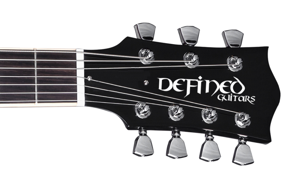

    Okay, so I hit the 5-picture-limit in my last post, and I wanted to show a few more things off, so here goes with a second post. The first thing I wanted to share, was my (boring) headstock design, and my simple logo design. I intend to leave the ash body, neck, and back of the headstock pretty much blonde (just oil), but I do intend to stain the top of the headstock on all my guitars. Here's the mock-up I did to get logo sizing/shape, and headstock shape sorted:
Name:	Defined Headstock.png

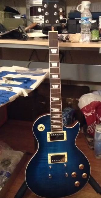

    As for the finish I'm going to try my hand at a simple burst on the maple veneer, using blue and black stains. I've seen a few YouTube videos, where people did a similar job using stamp pad ink, so hopefully I can achieve a similar result. Here's what I am hoping for (more or less):
Name:	Cool Finish.JPG

    Absolutely. I can clearly see a few high/low frets by eyeballing it. And while the picture doesn't really show it, the neck looks like it is slightly thicker on the right (as pictured), until about the 5th fret, then seems thinner. and it switches to being thicker on the left side. Definitely seems like a bit of a twist... though I'm not sure how that could happen unless the rosewood fretboard was torqued and clamped down over an uneven neck top (which I doubt). I'm not the only one that noticed it, so its not just my imagination... but I am hoping it is an optical illusion, possibly created by a neck bow due to truss rod needing adjustment, combined with some fret level issues. Oh well, the new tools should arrive this week, so I'll check it out and post the results. Fingers crossed.

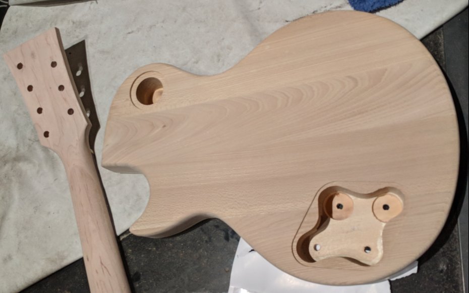

    And speaking of grit... the sanding has started. The first of many, many, many passes I am sure. The next was pretty smooth, so I took off any roughness with 320g, then moved on to 400g (including wet sanding). The maple veneer was also pretty good, so it got the same treatment as the neck.

    The body, however, was a bit rough... so I've started that at 240g. I've now wet everything down, found, and sanded off any glue marks, so it's coming along nicely.
