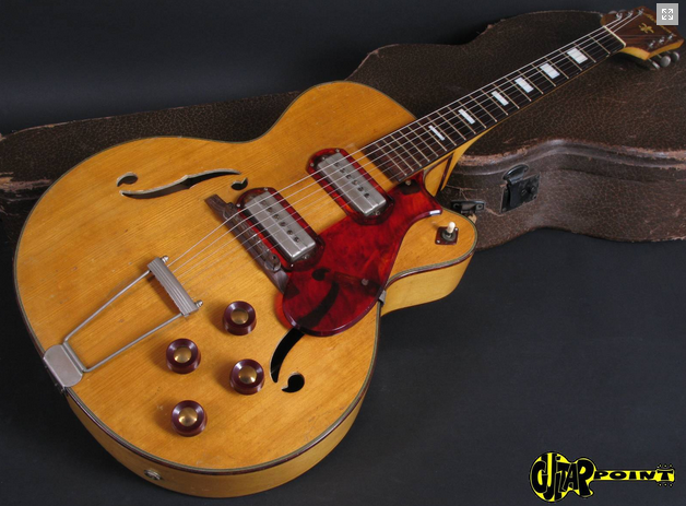

    Here's a pic of the real deal - I'm hoping that I'll be able to do it justice:

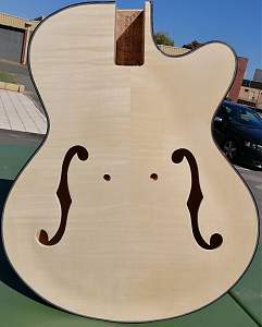

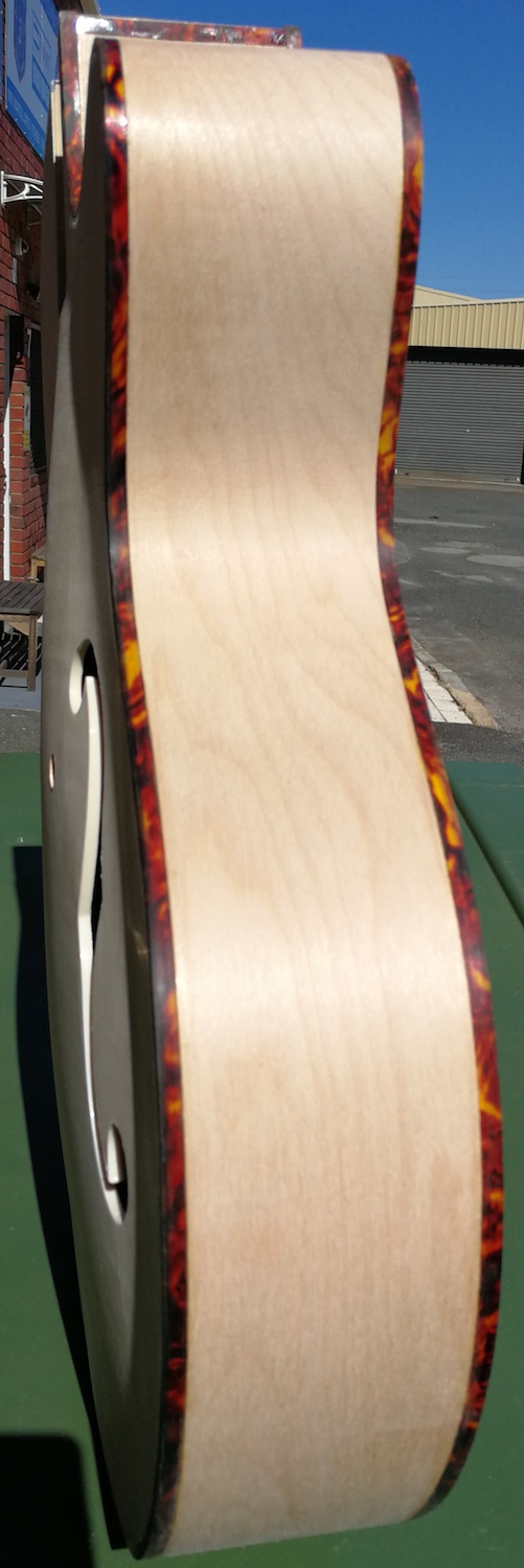

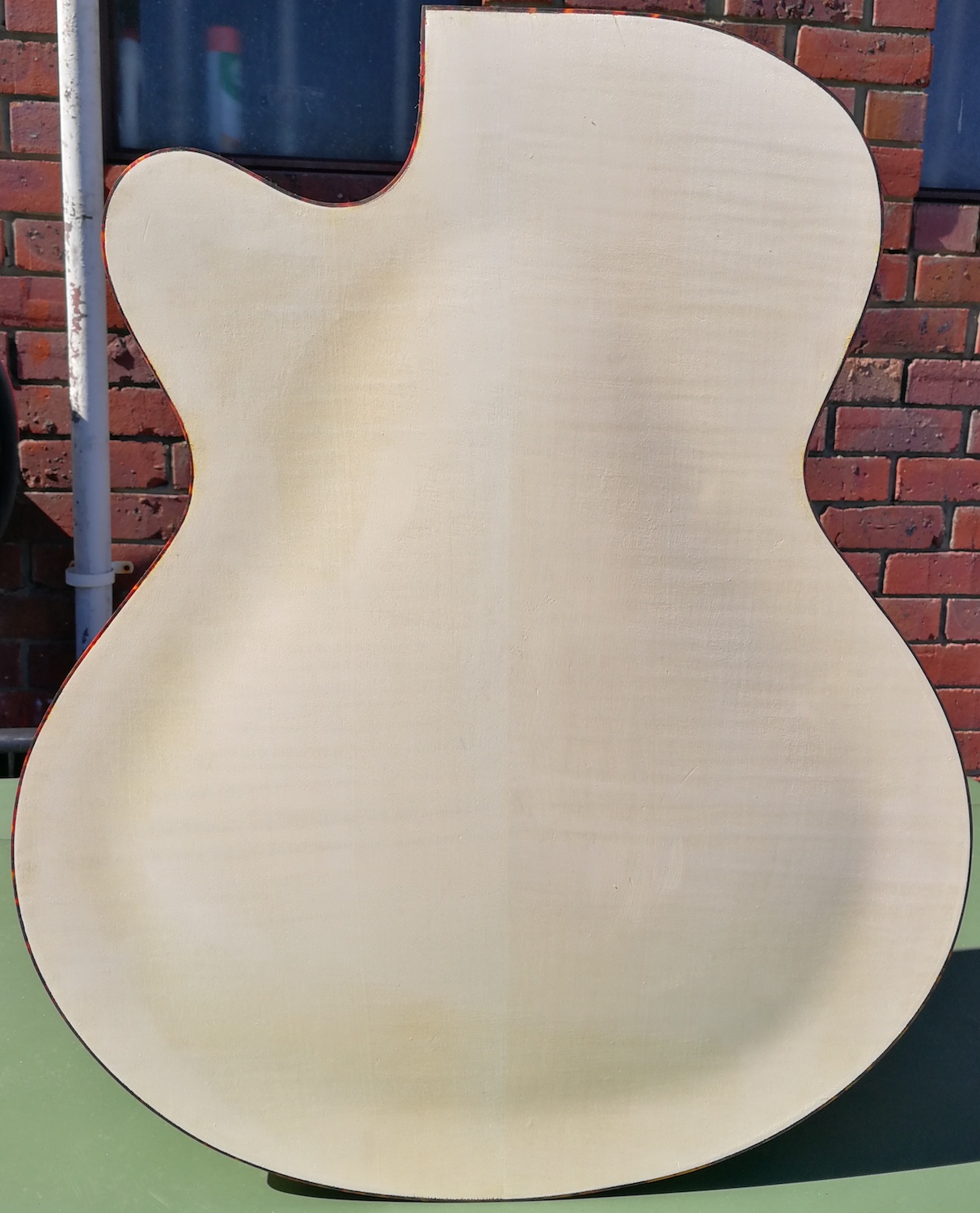

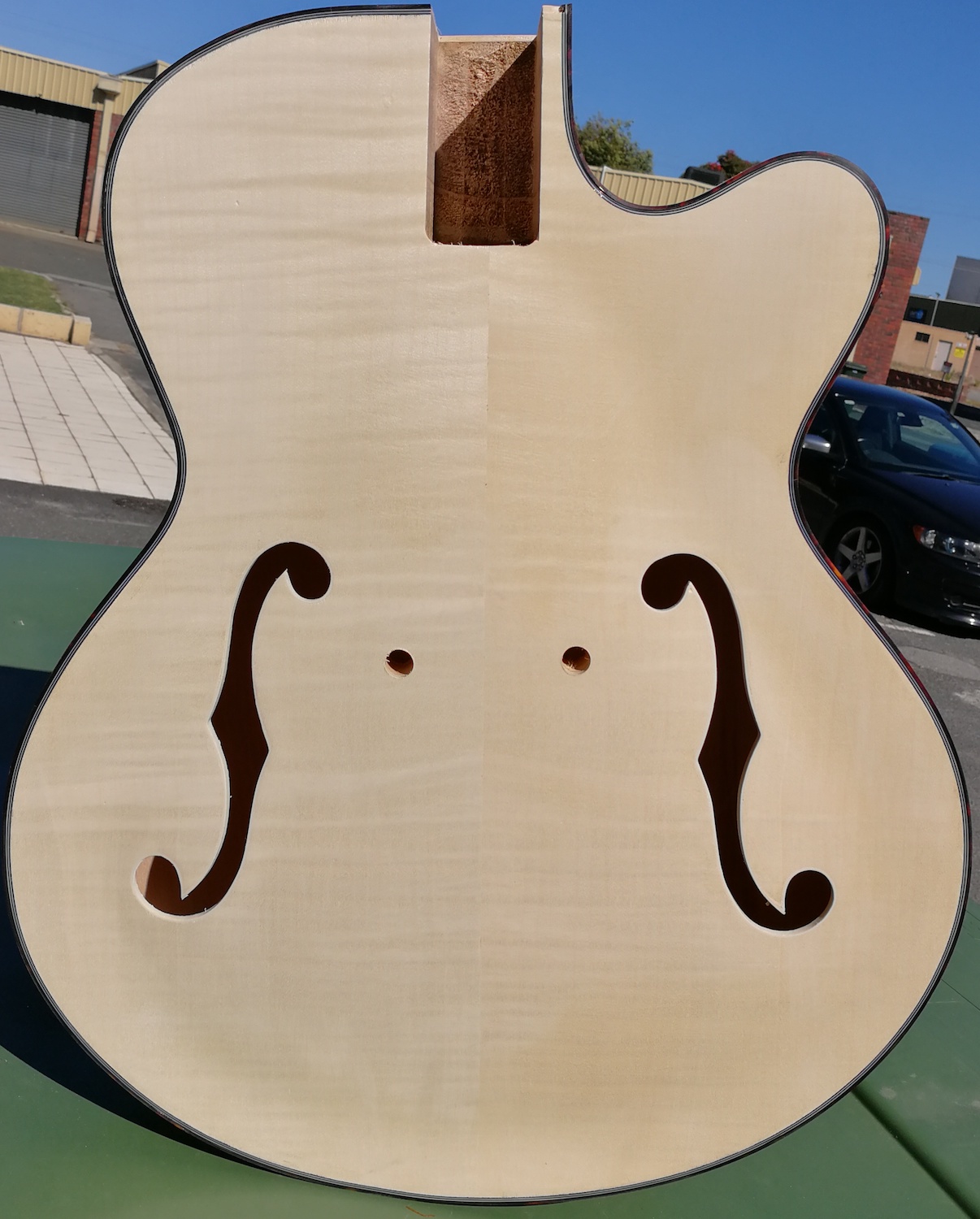

    I'll post some pics in the comments (as supplied by Ben) of the body supplied by the factory - I wanted flame back and front, and because the Gretsch style build they supply is not the same layout/pickup size, etc, I asked for only bridge post holes and f holes on the top. Now that I notice the f holes are in a bit of an odd position (pretty much all archtops have the bridge positioned central to the f holes), I may or may not live with this one as the f hole positions in relation to the bridge get to me....
    The F-holes start off in the standard kit position, certainly the top/front of the F-hole relative to the waist, but the angle of them looks wrong to me, compared to the standard GR-1SF kit. They don't splay out as much at the bottom as on the standard kit, which doesn't help the look, and adds a bit to their perceived length. Of course the F-holes on the Harmony in the picture are about 3/5 the length of those kit F-holes, which moves the centre of the F-hole further away from the bridge position. The kit guitar F-holes are generally a lot longer and a bit wider than on their 'inspiration' guitars. Of course on some guitars it makes it easier to get the electronics through the holes, but on the hollow bodies where you can use the pickup cut-outs for this purpose, it isn't anything like as important.
    I'd also hazard a guess that the Harmony has a shorter, more compact body, despite the overall shape looking quite similar. I caught sight of a plan for one giving a body length of 17.5". If the GR-1SF is the same length as my ES-3, which I assume it is, then that's longer at 19". Both necks join the body at the 14th fret.
    So you've got much longer F-holes set, a bit further back from the waist than on a Gretsch (or Harmony) and a 1.5" longer body (which will also move the waist back in proportion), so that's generally why the bridge doesn't line up with the middle of the F-holes. Which I'm afraid doesn't solve or improve anything.

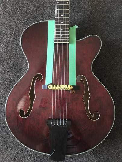

    Well you’re faster off the mark discovering the unsymmetrical f hole positions compared to me. I was finished before I noticed the bridge closer to one f hole than the other.
Name:	PNG image 88.png
    The outline plan came up as an image when doing a search for a plan. But it was a fleeting glimpse as it was on Pinterest, which very handily gives you a totally different picture within seconds.

    @DarkMark - I actually hadn't noticed that element of them being badly positioned....
    I can't unsee that either - egads!!

    I was only really looking to see if I could find reasons why the F-hole position was out by so much.
    It mainly comes down to kits that are definitely not exact copies of others, and that are routed using templates, not CNC machines, by a less than precise workforce.
