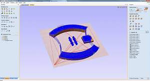

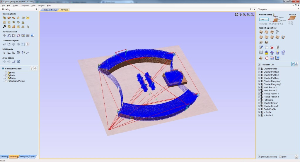

Name:	Front Toolpathed.jpg
    Front of the body finished, tool pathed and output to the machine

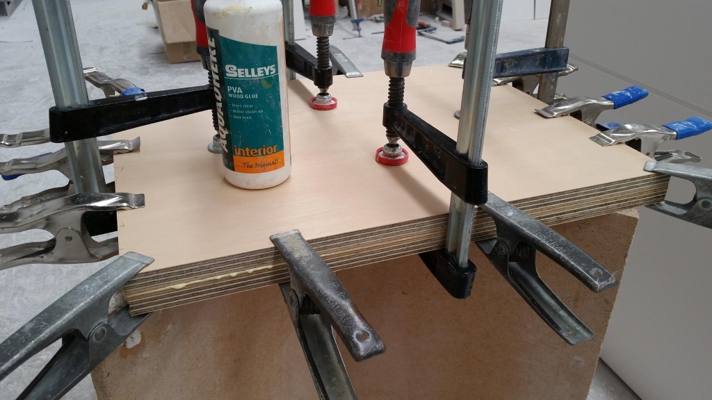

    2 pieces of 18mm Marine ply laminated together (one flipped to counteract any bow)

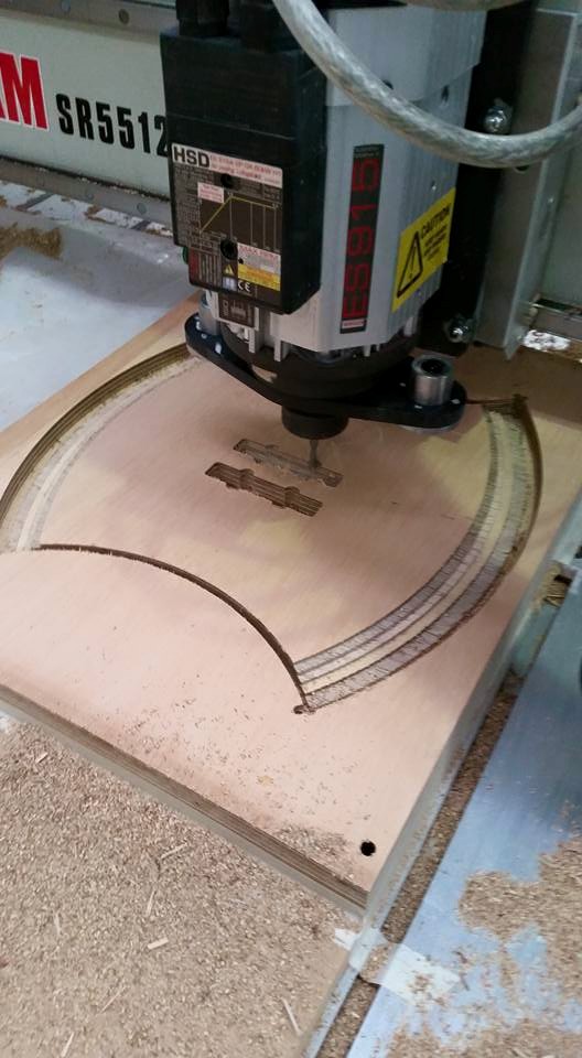

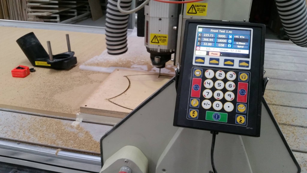

Name:	Machine Started.jpg
    Machine started. Outline cut and starting to rough pass the blade
Name:	Pickup pockets.jpg
    Pockets for pickups cut
