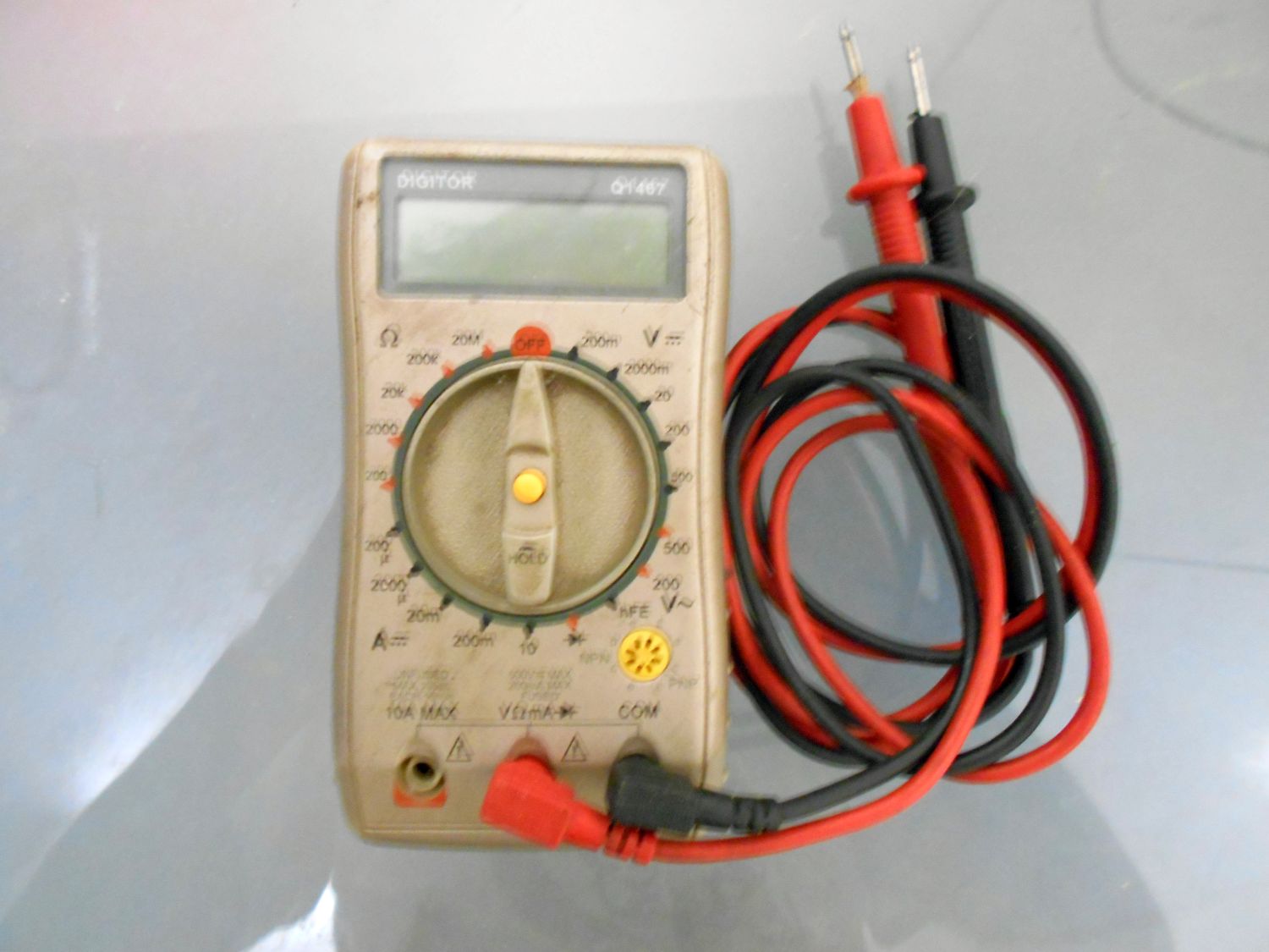

    Here's an example of an inexpensive Digital Multimeter:
    If memory serves me right, I bought it from Dick Smith Electronics quite a few years ago, I actually bought three since they were on special at about $16.00 each.
    In the pic above you will notice that there are two coloured probes plugged into the Multimeter, one is Red, and the other is Black, the Black probe is normally plugged into a socket marked "Com" (short for Common), and the Red probe can be plugged into either the socket marked "A" (Amps), "V" (Volts), or "Ohms" (sometimes marked with a horseshoe-shaped symbol).
    If we want to measure Resistance in a circuit, or component, such as a pot, we plug the Red probe into the Ohms socket.
    If we want to measure Voltage in a circuit, or for example a battery, we plug the Red probe into the Volts socket.
    And if we want to measure the Current in a circuit, we plug the Red probe into the Amps socket.

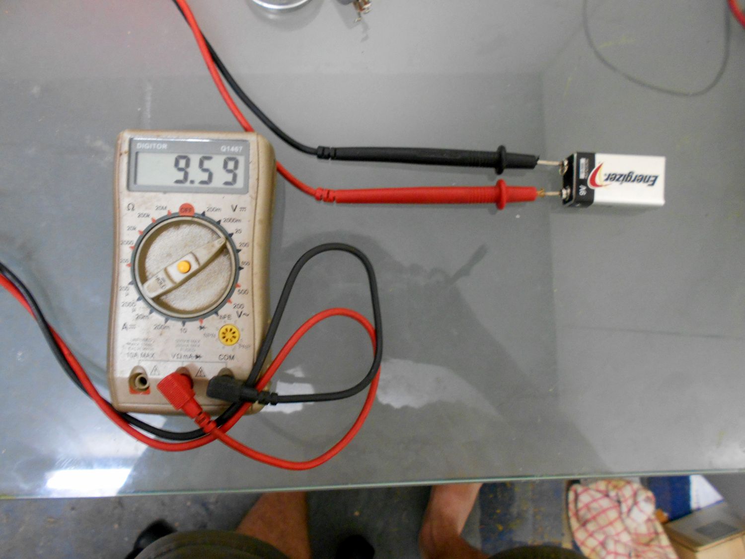

    And here's an example to illustrate how to use a Multimeter to measure Voltage, in the following pic I have set it up to measure the voltage in a standard Alkaline 9V battery as used in a lot of FX pedals for guitars and Basses, here, I have set it up so that the tip of the Red probe is touching the battery's + (Positive) terminal, and the tip of the Black probe is touching the - (Negative) terminal.
    Because the battery is a 9V type, I have set the rotary switch to the 20 V DC (Volts D.C.) range.
    The display is showing the actual voltage-reading of the battery, about 9.59 Volts, the battery is a brand new fresh one straight out of the package, it is normal for a new 9V battery to measure that much.
