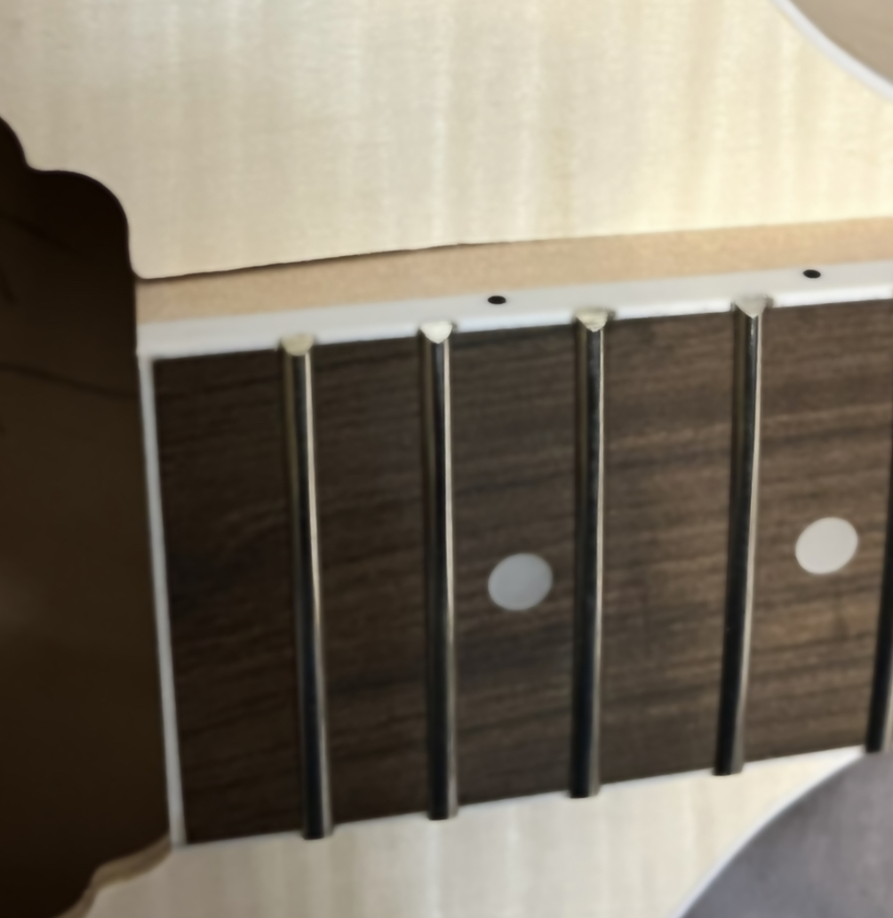

    Beatle Bass Birthday build. HB-4
    I purchased the HB-4 on Christmas Day and it arrived on my birthday January 10th. I was concerned about damage from shipping but it appears to be ok. The fretboard had one mean looking gouge in the first fret, but after closer inspection, I see with a magnifying glass, it is just extra glue from the factory glued nut. I have ordered a bone nut to replace the crappy looking plastic one and am hoping it will work and look better. The neck has a pretty big gap on the top side where it attaches to the body, which would not be a problem if it was the bottom, because the pick guard would cover it. I have decided to use Oxford brand finishing products from Canada because they have good reviews and they sell a kit with almost everything I need to finish one guitar. I hope to pull off a sunburst with Honey brown on the outside and Nectarine for the center colors. I hope to get started with the build at the end of January as this is the estimated time I should have the supplies to start the process. Hopefully I can figure out how to post pictures by that time. I noticed the mini hum backer’s didn’t come with any pieces to mount them on the curved face of the body so I ordered some curved bottom rings from Ebay that I hope will work. Everything else looks like it was included in the kit. My pictures are too big to load so I have to figure out how to make them smaller. Thanks for any help in advance!

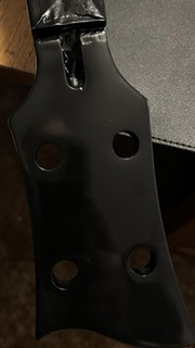

    Been too cold to paint but I have a little progress.

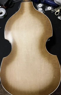

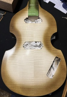

    Member Opie's Avatar
    Jan 2023
    Fort Lupton Colorado USA
    9
    Not as simple as I thought

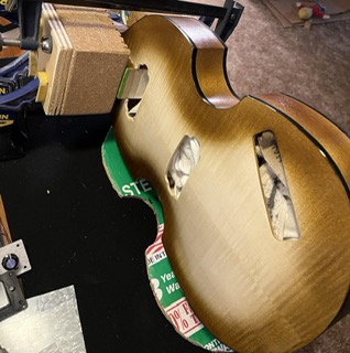

    Warm weather!
    Finally getting some clear on it. Should the saddle be finished or is lemon oil ok? It appears to be the same wood as the fretboard.
