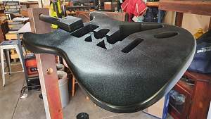

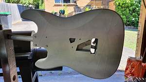

    Body sanded to 240 grit then about 5 sealing coats of clear Duramax primer. Sanded betwenn coats to get a clean smooth surface.

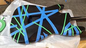

    Feb 2021
    84

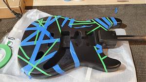

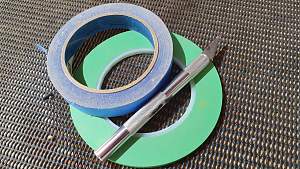

    The taping was fairly accurate. It isn't note for note but it is very close.

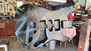

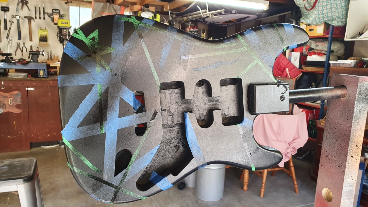

    I sprayed a dust coat of black to stop any bleed under the tape when i spray the white

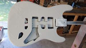

    Gloss white duramax. Only needed 3 coats to get a nice even finish. Too many and it gets harder to level it out later.

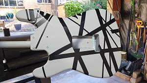

    Tape off when it had dried enough. I got nice clean lines and good definition on the "rough" parts

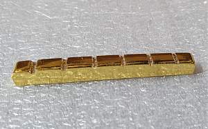

    I spent a few hours on the neck today.
    Head stock shaped and sanded. This is as close as I could get to the original without adding a bit more material to it.
    I have reshaped to a flatter D shape, more akin to an Ibanez as I prefer this profile.
    Brass nut was a slow process as it was hard to cut but got there and it polished up nicely.
    Frets levelled and crowned. I also rolled the fret board edges.
    Some lacquer applied that will be sanded smoother in a week or so. Just waiting for the Gibson logo water slide to finish it off.

    5,666
    Brass nuts, royal pain to fabricate. Did you start from scratch or get a pre shaped blank in for it?
    FrankenLab
    Feb 2021
    84
    I got several blanks. This is the second time I have tried and got it right this time. First one doesn't look so good.
    5,666
    Quote Originally Posted by Johnbamb View Post
    I misread an eBay listing and ended up with a dozen brass blocks about 60x60x15. Plenty spare for practice!
