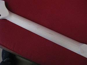

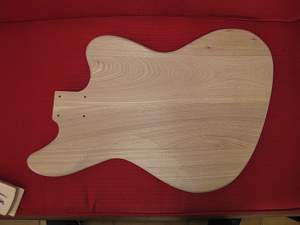

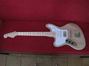

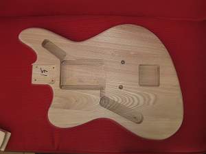

    I picked this up in June 2020 but never got around to doing anything with it.
    Found it during a recent clean up.
    The kit was a special order that did not meet the customer's specifications so finished up on the specials. Not sure what was not right but I liked the look of it. And the best part - it is a lefty!
    Ash body with a maple neck. Both have very nice grain.
    Was thinking of maybe charcoal stain the same as the jazz bass I did a couple of years ago but I like the grain of the body so might just go clear coat. Will think it over while sanding.

    I can see that the ash figuring is uneven between the pieces of wood used. It's not all straight and there's only one piece with highly figured ash. Probably why it was rejected. The positioning of the most highly figured section visually clashes a bit with the angled control plate and draws your eyes towards it. I'd go with the charcoal stain myself.
