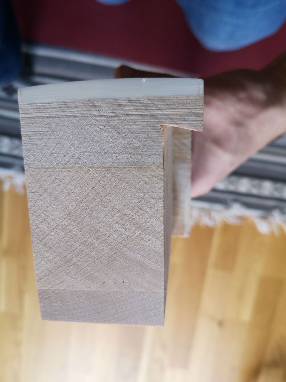

    Some of the issues that I found (see pics):

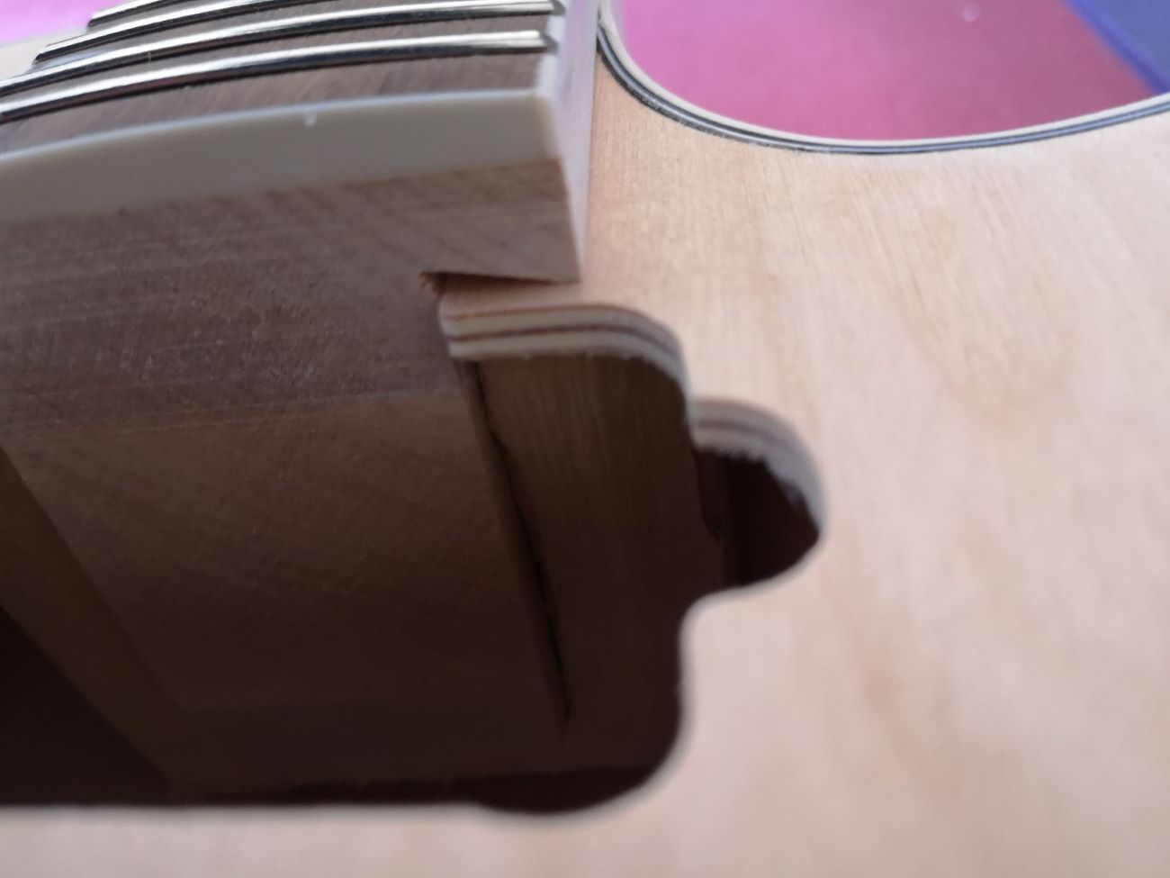

    There is a small gap on the low e-string side between neck and body - however, this could easily be filled with wood filler.
    On the high E-string side there seems to be routing mistake roughly 1 cm below the fretboard? I am pretty sure that the angle is not supposed to be there. I don't think that it'll cause major problems, but I'd like to hear your opinion on this.

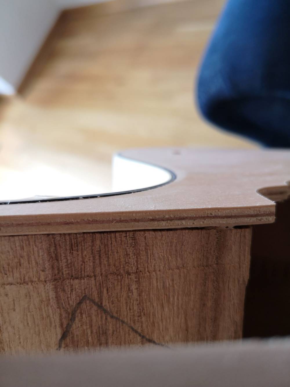

    Furthermore, there is a slight gap between the neck block and the top - it seems structurally ok but not completely sure.
    Of course there are also some glue spots on the body which I hope I can get rid of with acetone and a brass brush. I haven't done a mineral spirits inspection yet, but from the mere visual inspection I found a couple of spots. There are some minor scratches and dings on the top as well - on a solid body I would probably just sand them off, but I am not sure how the laminated ply would take the sanding. I might go over ever so slightly with 240 grit sandpaper to get rid off the worst parts - or do you think I would do more harm than good?

    1. That’s an interesting gap between neck and body. Let’s think about that...glue first and fill before staining?
    2.Routing below fret board. I’ve done three set necks and they have all had the same angle. Check how parallel (side to side) the fret board is to the body and adjust if required. Consider any neck angle change resulting (nut to bridge).
    3. Something else I’ve seen. I try and get some glue in there when I glue on the neck.
    4. Personally I’d give the scratches a light sand. Don’t go too hard, but I wouldn’t want stain highlighting them.

    I will check the neck angle again - just to be extra sure. When I checked it last time, I put the tune-o-matic bridge in place just with some tape around the posts and tried to set it at a height that resembles the lowest height when it is installed. I then put a long straight edge on the clamped neck (on the fretboard that is) and checked how it runs towards the bridge. When the straight edge lays on the fretboard it touches the bridge - I thought that this might be ok. I'll make photos when I check it again.
    1. Yes, that is what I was planning to do: glue the neck and then fill the gap. Of course that means that the gap might also be filled with glue after putting the neck on, which might lead to a slightly awkward staining picture. It's really only a small gap, so I think it won't be that bad.
    2. I already checked that. The fretboard is parallel, so I hope this isn't an issue.
    3. Will do
    4. Ok, I'll give it a try. Do you think 240 grit is ok?

    I think 240 will be ok, I’ve done it myself, just be careful.

    Edit: by the way, I’m going to have to flatten that neck overhang routing (high E side) you mentioned in your first post on my current build to set the neck correctly.
    I am actually really glad that I don't have to mess with the neck angle. Hope it works out fine for you.
