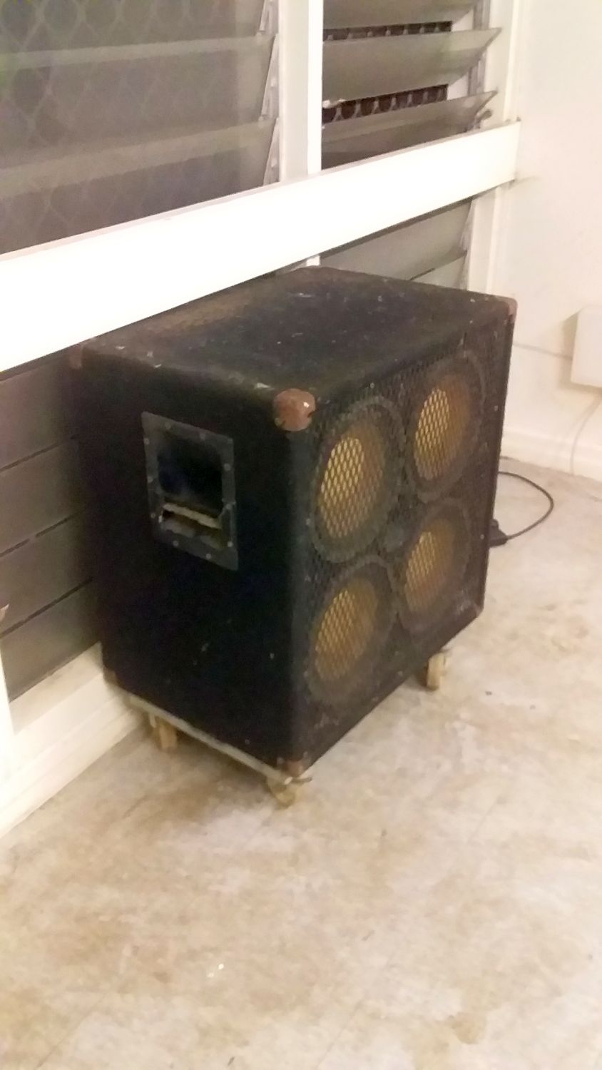

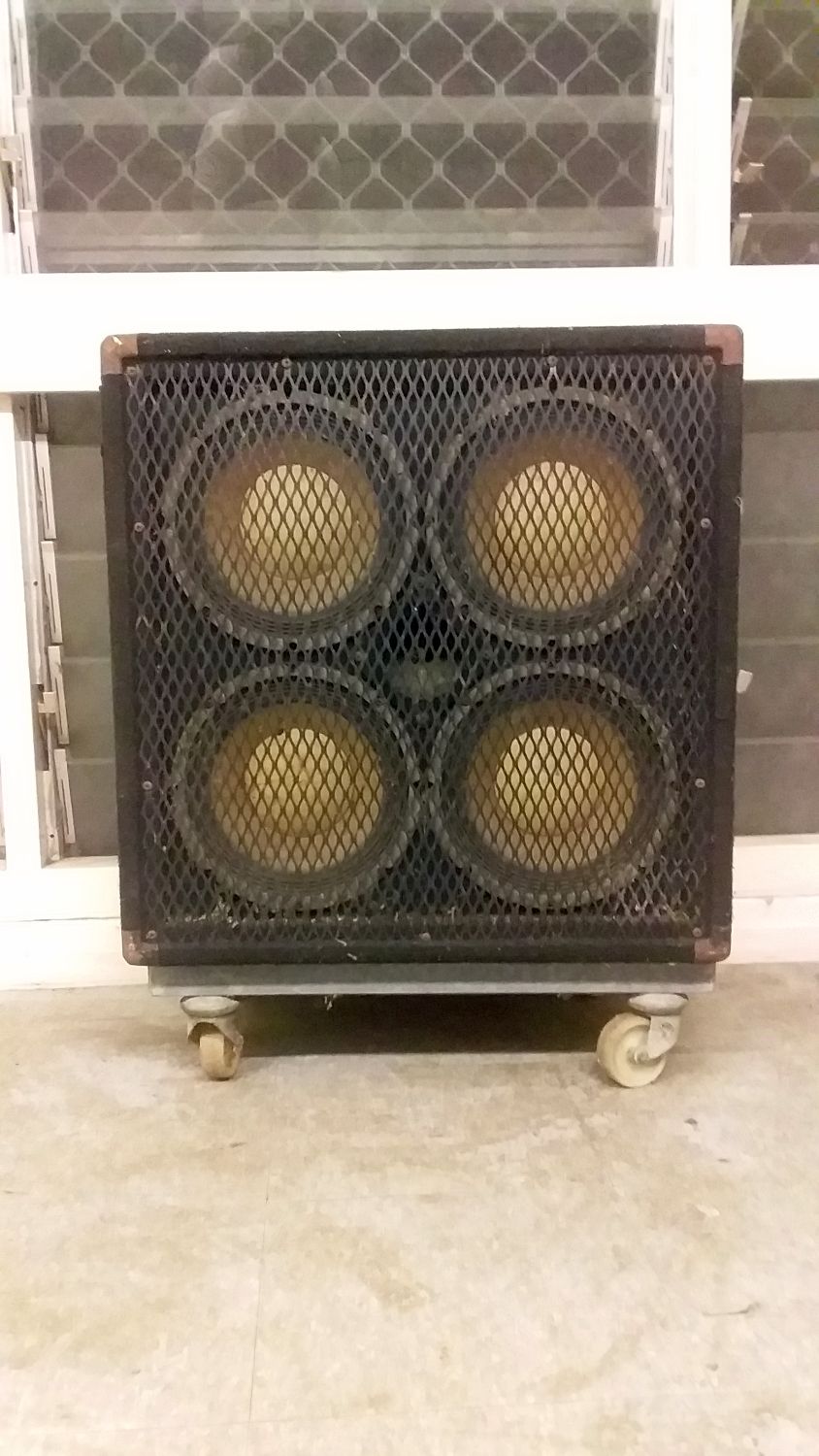

    I'm in the process of buying a second-hand Peavey 410 TX 4X10 Inch Bass Cab from a friend of mine, I'm buying it for use as part of a bass rig with my Fender Super Twin amp, I've done some testing and as far as I know it just needs a complete set of replacement speakers to get it working again, it could also do with a good clean-out while I'm at it, should be a good project for next year.

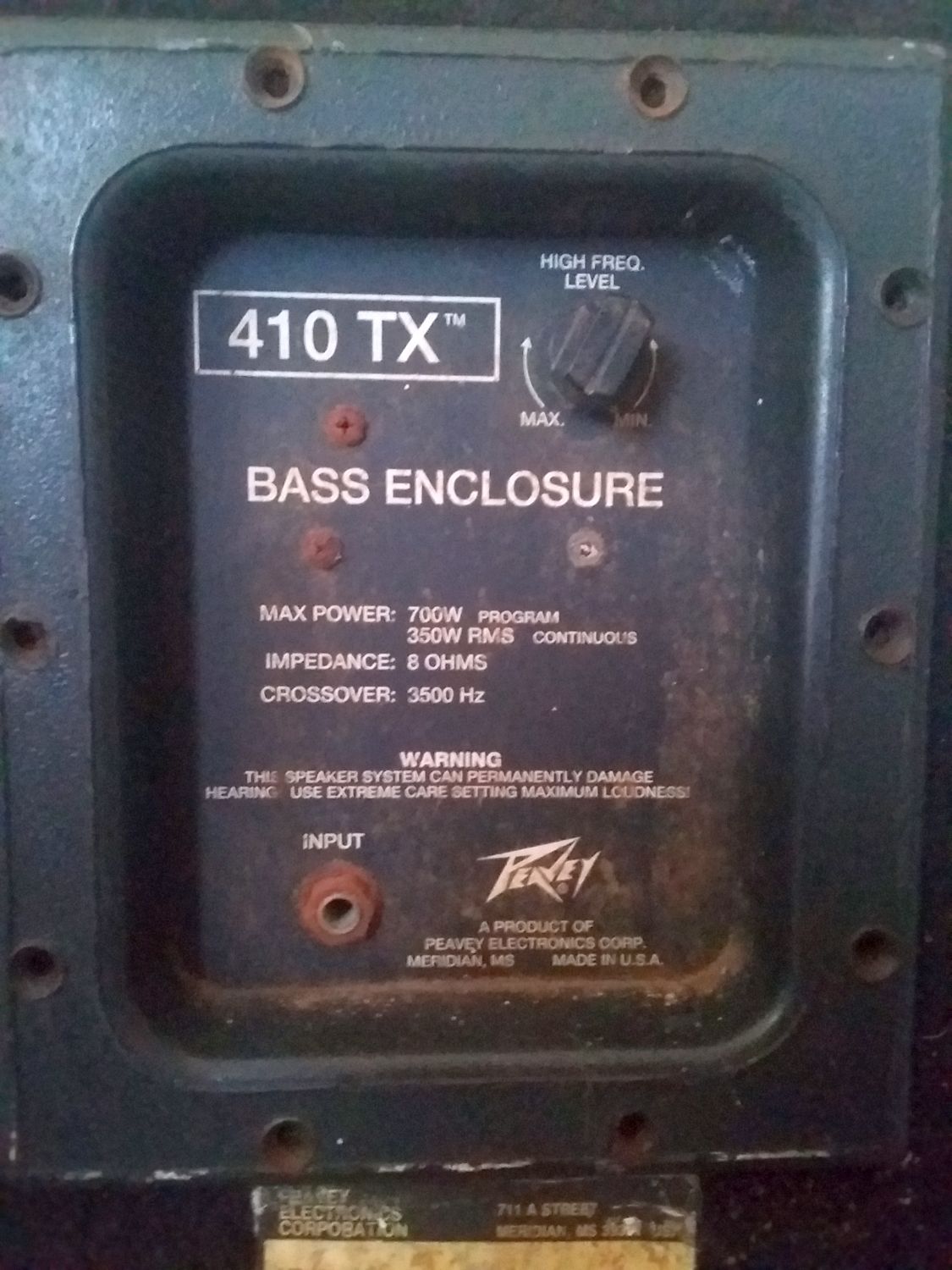

    The bass cab is rated for a maximum of 700 Watts into 8 ohms, so if I wire-up the new speakers in a series/parallel configuration, each speaker needs to be able to handle 1/4 of 700 Watts, or at least 175 Watts by my calculations.
    Here's a couple of pics of the bass cab:

    There's a chance that I might be able to salvage the originals and get them working again if the voice-coils haven't all been burnt-out, I checked with my multimeter and got a reading of about 32M Ohms, which is clearly an open-circuit in my book, it should read roughly about 8 Ohms or so.
    I'm guessing that it is actually a bass cab for a P.A. system, it has a 3500Hz crossover circuit board in it, but, I can't see why it couldn't be re-purposed for use as part of a bass rig.

    It’s not a PA cab, it’s definitely a bass amp cab. The crossover is there for the centrally mounted HF tweeter. That may be a piezo unit, a compression driver or even a small diameter standard driver. There's often an on/off switch for that or maybe a level control. Something you’d want out of circuit if you ever used the cab for guitar used with distortion, and you’d then want the crossover out of the signal path completely.
    If you want to have it a dual purpose bass/guitar cab you’d be better off removing the crossover and disconnecting the HF driver, (maybe remove that too and blank off the hole). Unless you are playing a lot of slap bass or a lot of high notes, then you won’t notice the loss. It’s not something you need for rock/blues bass as long as there’s no crossover dropping off the high-end. 10” speakers have a reasonable HF response, certainly compared to 15” or 12” speakers.

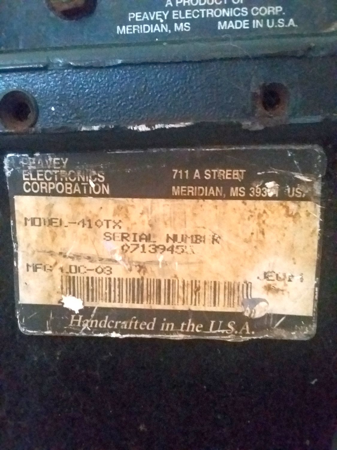

    Do you know the cab model ref, as the literature may give a frequency response, which will indicate how good an all-round cab it is, or whether it really was mid-biased and should be used with a 1x15” to fill out the bottom end.

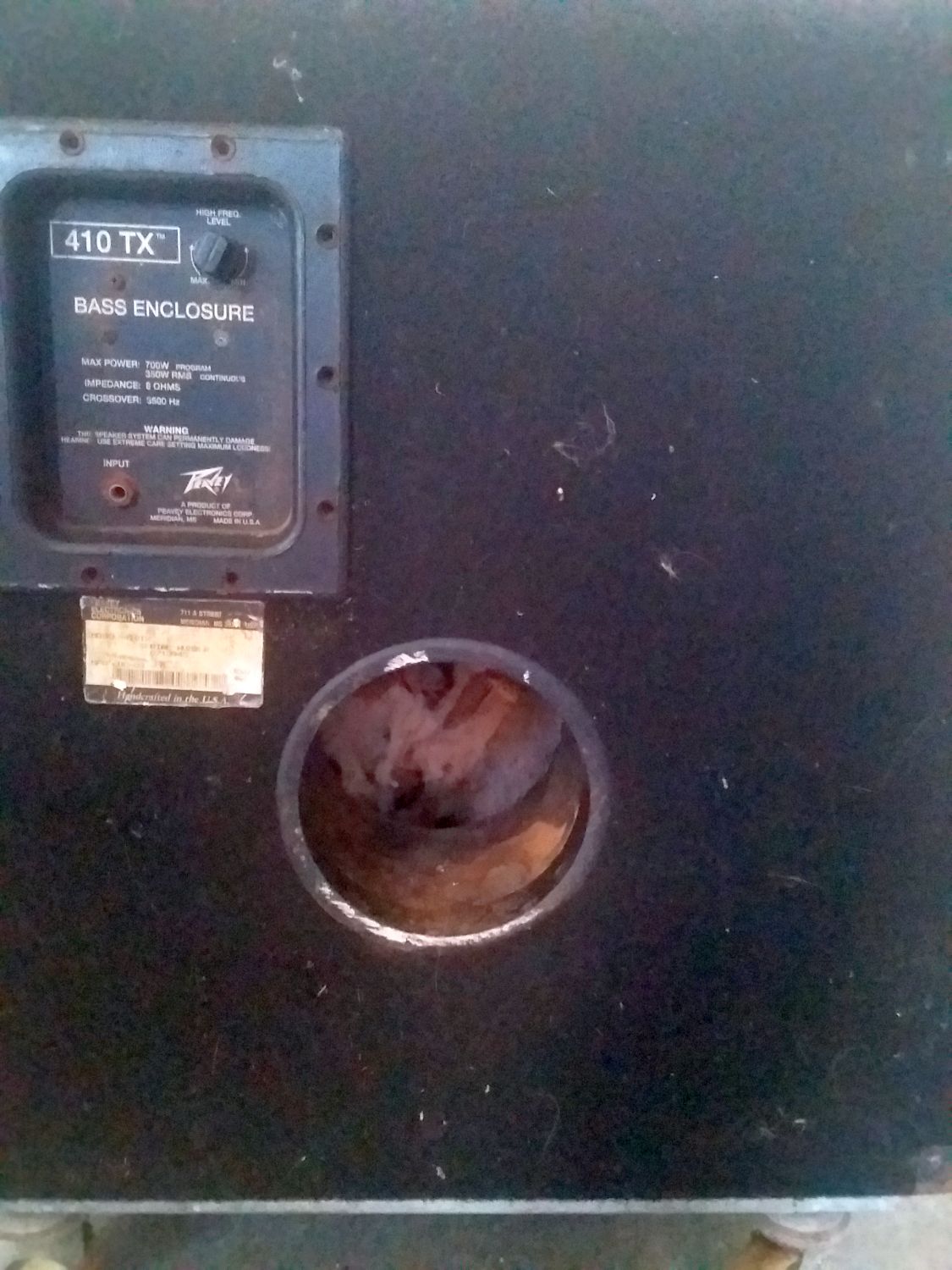

    As it just so happens, the Peavey 410 TX bass cab does indeed have a bass port on the back of it, I'm not sure what it's model ref is, I'll have to leave it till the morning to find out, will post it here if/when I do.

    It's worth reiterating that when it comes to bass rigs it doesn't matter how good the drivers are if they are in the wrong cab. Worse still if the cab is wrong enough you can blast the cones across the room with just a fraction of the rated power.
    Basically you have two choices. One is to get a set of original drivers, and the second is to modify the cab to suit the new drivers. This isn't quite as big a deal as it might be since the total volume is hopefully going to be reasonable, so it's just a question of altering the porting.

    Okay, here we go, the outside dimensions of the Peavey 410TX bass cab are as follows:
    Width = 615mm.
    Depth = 435mm.
    Height = 625mm.
    All the speakers are indeed 10 inch in diameter, the cab itself seems to be made out of 20mm particle board, or, it could be 20mm plywood, hard to tell.
    Some more pics of the cab:
