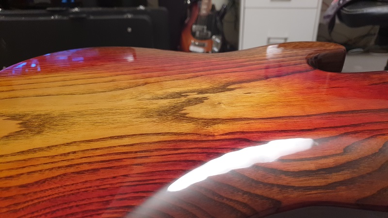

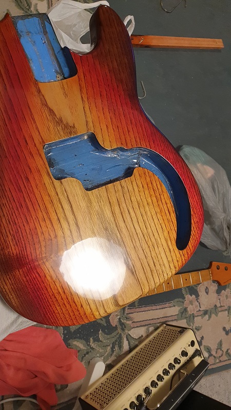

    Thanks WAZKELLY for the Tru Oil brush hint. This new build is coming along great with two coats of Tru Oil on it. I am trying for a yellow, orange, red, brown Dragons Breath Fade......a three letter company has this on some of the wonderful carved top guitars.
    These pics are with two brushed coats of Tru Oil over the stain.....wow.

    lots of trial and error on scrap pine....and this fellows videos. BIG D on You tube..... My effort is a combination of lots of his work and others....but this was the inspiration for this colour scheme.
    This one is part 3 of 3 about a rebuild of a certain brand guitar he completed. (This is the stain video.)
    https://www.youtube.com/watch?v=_FOS6W8YRKQ
    I used Angelus Yellow, Red and Orange and Feast Watson Elm as I don't have any Angelus brown.
    Be really careful of the RED as it takes hold and will not let go.....you can see the V on the back I had to work hard to get it down to the shape and size.
    Oh, and the orange goes on very yellow and changes colour slowly to orange....so wipe and wait a little with it....as you can end up with it all over the place.
    I did not do all the sanding he did during the staining phase.....as my P Bass is a solid lump of Ash. I sanded to 180grit...ebony timbermate, then sanded 240, 320 and 400. Stains on at 400 grit. No grain raising at all. Leave over night....no sand back. Then started brushing on the Tru-Oil. Now at 3 coats. I think that is enough and I will let it hang now for 7 days and then start the Polyurethane.....probably 3 lots of Poly...wet sand 600, 800 and/or 1200 if I do 4 lots. Then 10 to 14 days hanging and wet sand to 2000 and then cutting compound, polish, wax.
