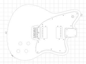

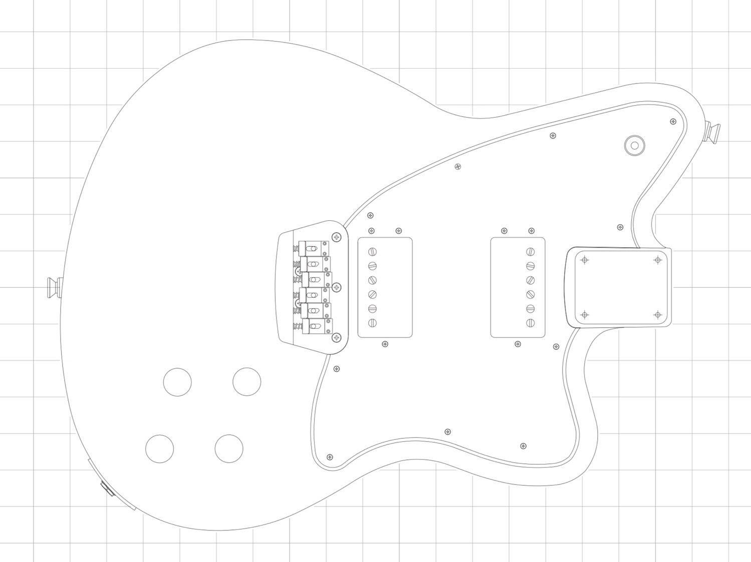

    Going to take the general Body shape, but no arm carve, keep the belly cut and carve the neck joint.

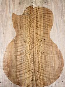

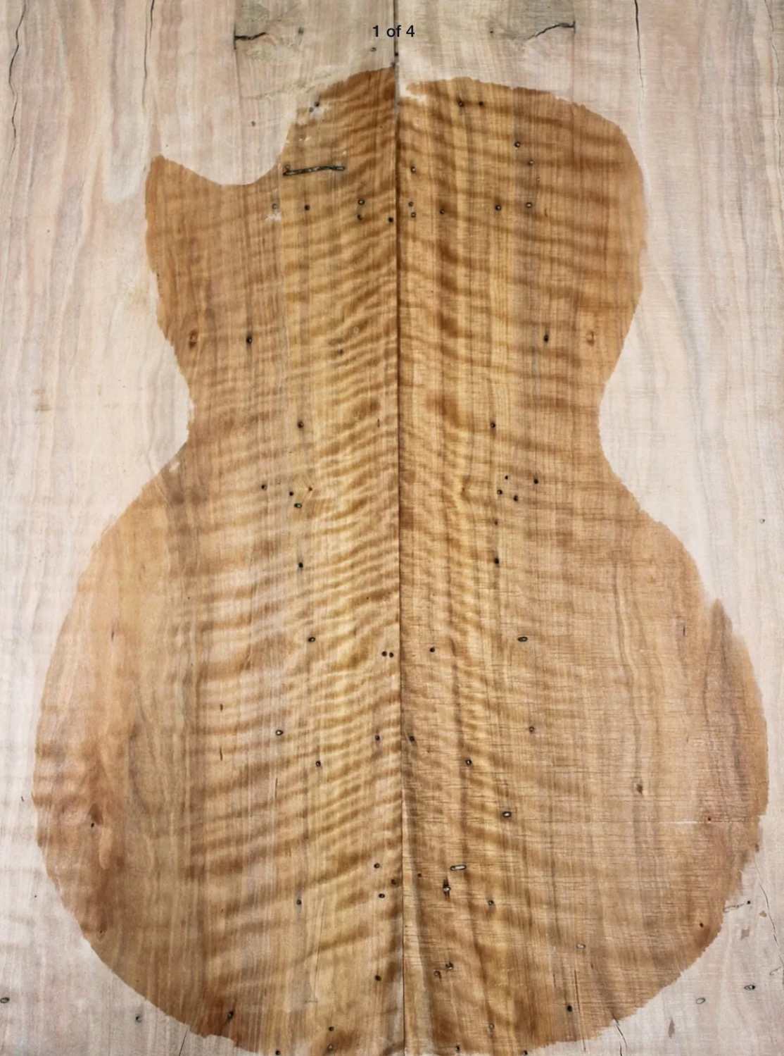

    I just bought the top. Love it. Got it for a great price too. Got a nice 5mm to it too.

    Nice looking piece of wood there!

    That top looks great.

    That's a killer piece of timber

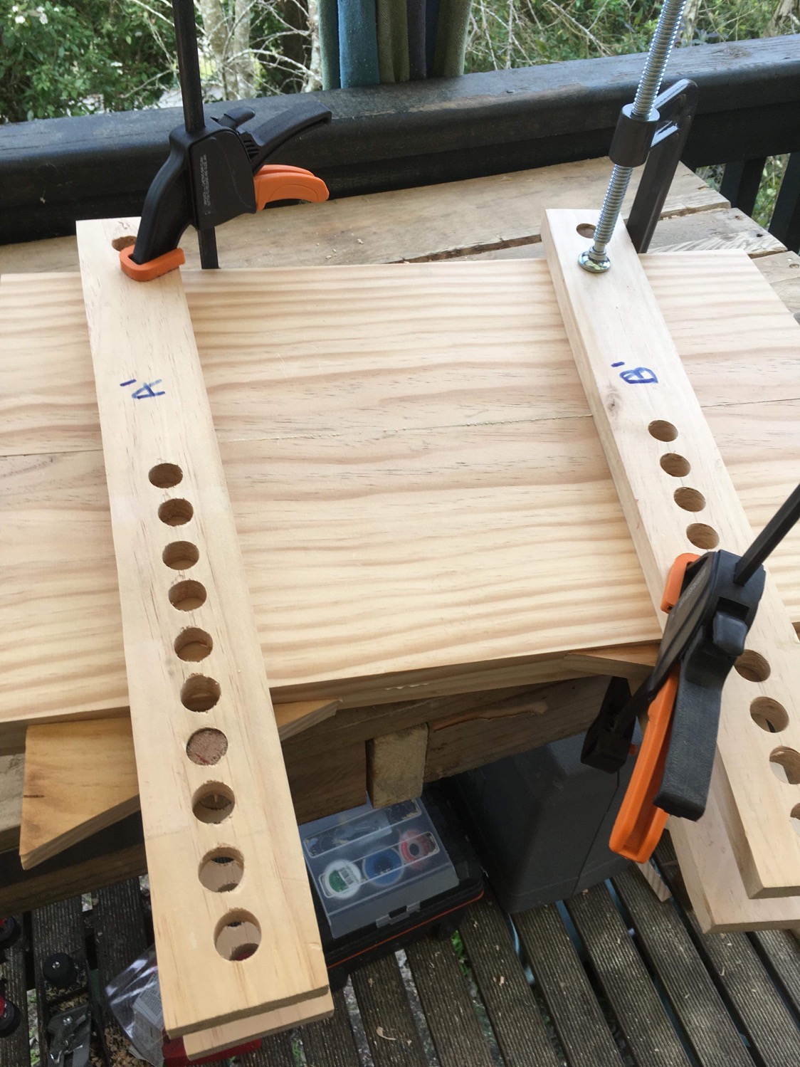

    First step was to build some simple bar clamps so that I can join the boards that will form the bulk of the body. Pretty damn pleased with them, they’re just two planks with holes in them, dowels to join them, and wedges to tension it.
    My woodworking is pretty nascent, but this was easy, relatively quick, effective, built from scrap, and saved me like 80 bucks or so for pipe or bar clamps.
    Next was just cutting the boards (pretty roughly) to size. Roughing up the bits to be glued together and then clamping it up.

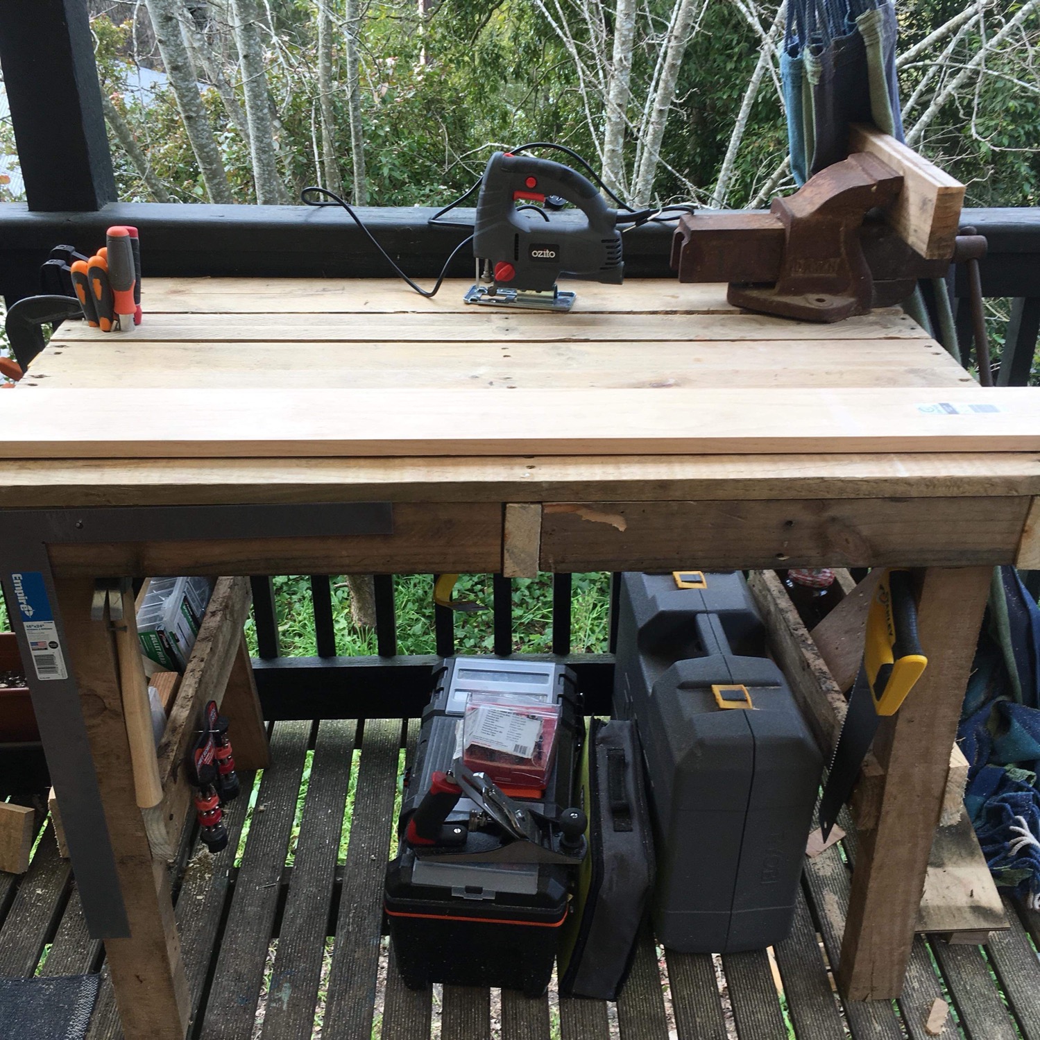

    Actually, the real first step,would have been building the work bench (outgrown working on our desk in the bedroom) which I knocked up a few days back out of an old pallet. I love old pallets. Building some shelves, a chicken coop, a bed and a headbord next...or randomly when I feel like it).
