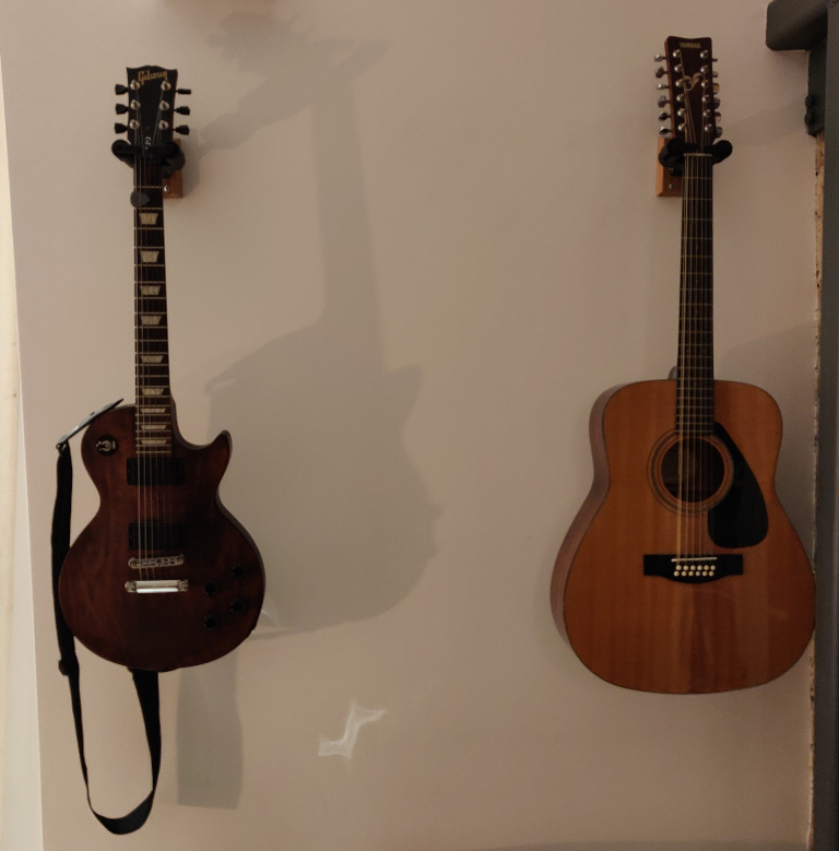

    I've just ordered the kit for my first-ever guitar build, a DTL-1. Planning on a natural wood finish, something like this beauty. Space already reserved on the guitar wall...
