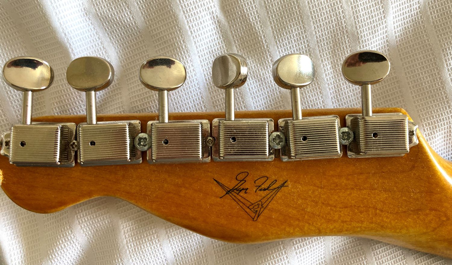

    The main problem as has been mentioned is the hole spacing. The kit holes aren't the best aligned to start with, but to fit vintage tuners, you do need the correctly spaced holes and all in a straight line You'd really have to dowel the existing holes and then redrill. Modern arrangements tend to have the overall distance between E to E tuner post centres slightly too short. I was just looking at fitting some vintage-style tuners on a Squier Tele neck, but the E to E distance on the Squier was 2mm too close together.
    If the hole spacing on your neck is similar to that Squier, you can of course file down the ends of the tuners to make them fit, as you only have to file around 0.2mm off each end of the tuners where they butt up against each other to get them to fit.
    If they are too far apart, then the standard screws won't hold the tuners in place, so you could use bigger screws with wider heads to hold them in place. I did this on a cheap eBay neck and whilst it worked and was OK from the front, it didn't look pretty from the back.
    But because the hole point of vintage-style tuners is to match the vintage-style tuner spacing, I haven't found any that are designed to directly replace modern tuners. Probably a gap in the market there, but it remains a gap as far as I know.
    I've also found that the conversion bushings can be a bit on the small side and you may also really need a slightly smaller hole diameter than 10mm, as I've had sets where the outer splines have had between a 9.5mm and 9.8mm diameter and were loose in a 10mm hole. So you may need to glue some extra material around the edge of the holes. I have no idea why you can't get slightly bigger adapter bushings, but I tried several different types and none were the stated 10mm, but all were smaller.

    Because of these reasons I might need to go with the stock contemporary tuners, however, would you be able to supply a picture of these screws Simon Barden (if you don't mind)? The main reason I wanted the vintage ones was to imitate a 1960 Fender as best I could so the spacing doesn't worry me as much (so long as the tuning won't be affected)
    Thanks again for all your responses and thanks again for the offer King Casey it is well appreciated
    It was about 10 years ago now, so I can't remember exactly what I used. I just worked out the most suitable sized head and went to the local hardware store and bought some short screws with wide heads that looked about right. Nothing technical at all. In fact it turns out I used a mixture of original and new screws as the holes weren't evenly spaced.
Name:	tele headstock small.jpeg
    Very much a bodge job, and I'd do a lot better today. But it was very cheap neck from eBay and I couldn't be bothered to remove the fake Custom Shop decal.
