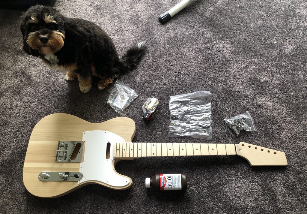

    First things first I did a count and quick layout to make sure I had the bits and pieces. Again featuring my friend/assistant, Harrison.

    Looks good.

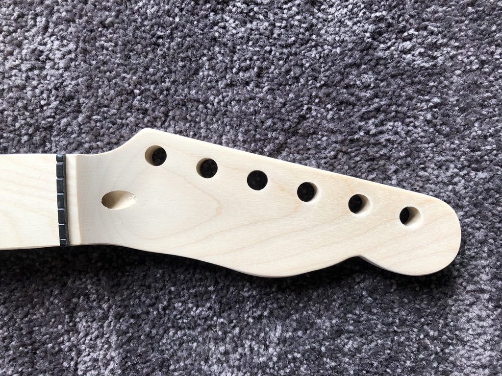

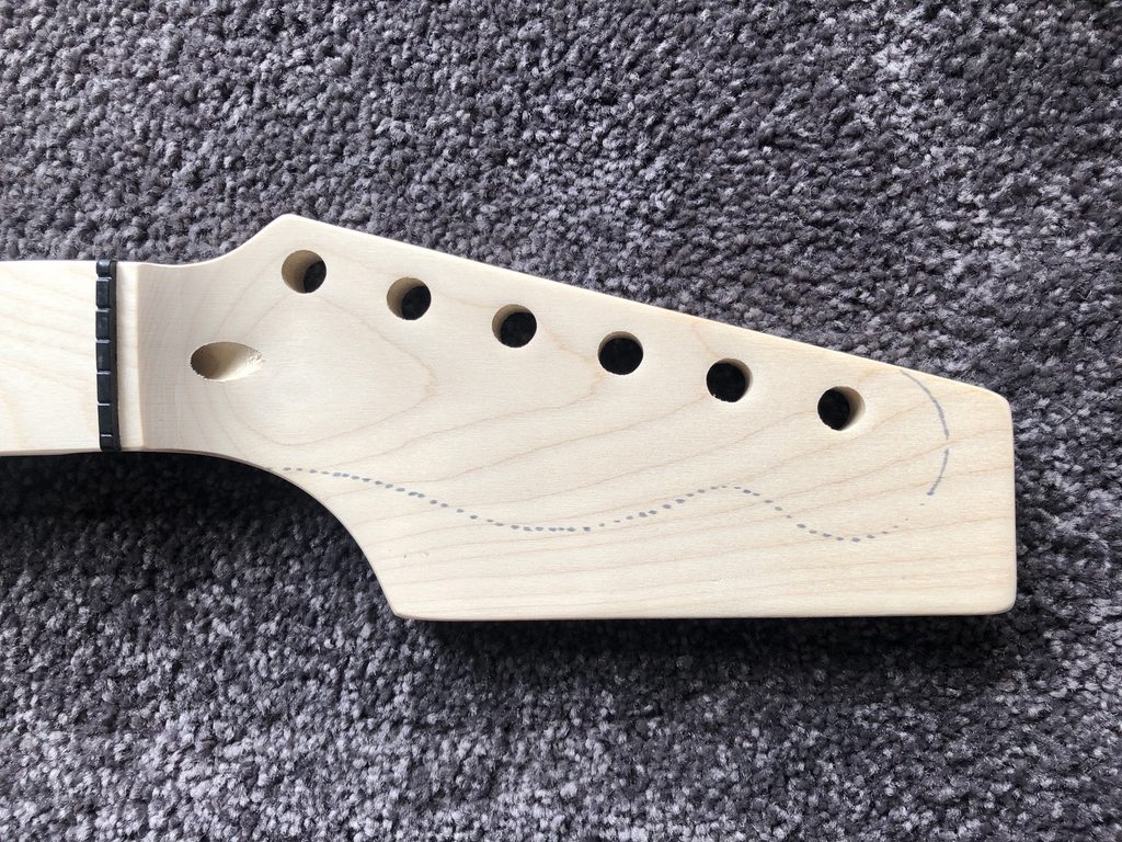

    Onto the headstock shaping. I'm was going for the traditional tele shape. A little wonky but then again so am I, so I like it.

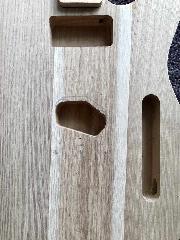

    Now time for the infamous bridge positioning. I measured a few times, and I think I have come across the same issue as most people in that the hole for the bridge pickup is just a little too far back:

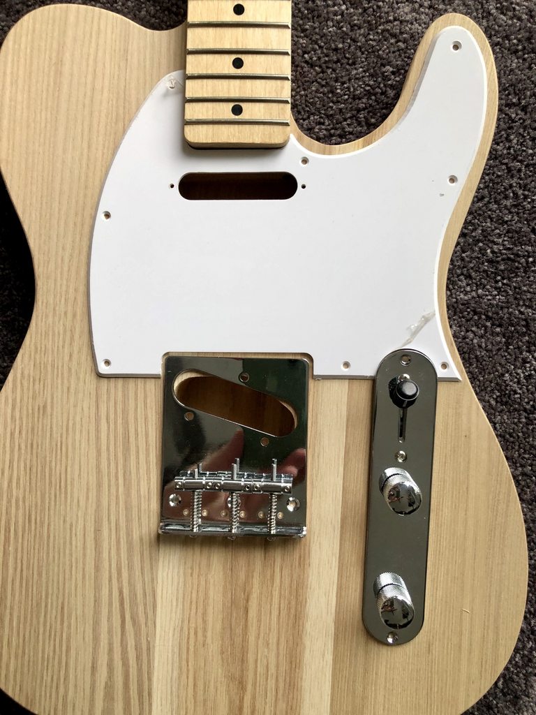

    I also noticed that the pickguard is a little off - it doesn't sit around the neck completely straight so i'm going to have to trim a little off the inside.. nothing major, maybe half a mm.

    Just double check and measure a couple of times before making any mods. Your 'to remove' markings look a bit larger than I expected.
    Remember that the bridge (unlike the control plate) does not touch the pickguard (there should be a 3-4mm gap between them) and that the top B/E saddle should be moved forward almost to the end of the screw before measuring scale length. Measure the scale length in one go, from the front of the high E nut slot to the middle of the high E saddle.
    Cut out too much, then find the bridge needs to come back a bit, and you could end up with a visible hole.
